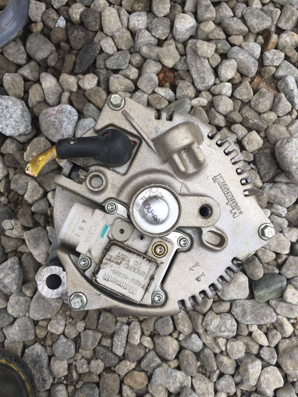

Right 3G Alt?
Old Oct 14, 2017 | 11:14 AM
Number4's Avatar
Number4
Joined: Oct 2014
Posts: 306
Right 3G Alt?
off a 5/99 Taurus 3.0 V6.
off a sideways engine or front facing!?

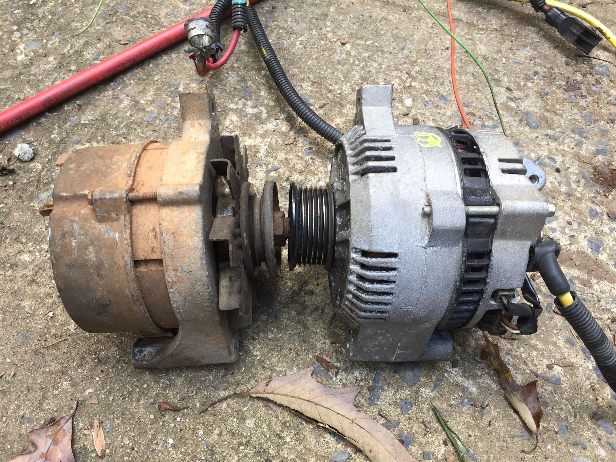

Hopefully someone will chime in. I can't remember the way to tell which hole count on the front of the case on which amp alternator it is. Something like a four hole is 130 amp. And the other is 95. I had the issue of my stock v belt pulley hit the case when I tighten it down. I read the shim it out. I had my boss turn the back side of the pulley down 50 thousands. So I didn't have to put a shim in. Works great

Two hole is the 130 amp. That ear configuration just doesn't look like the one in some of the pictures.

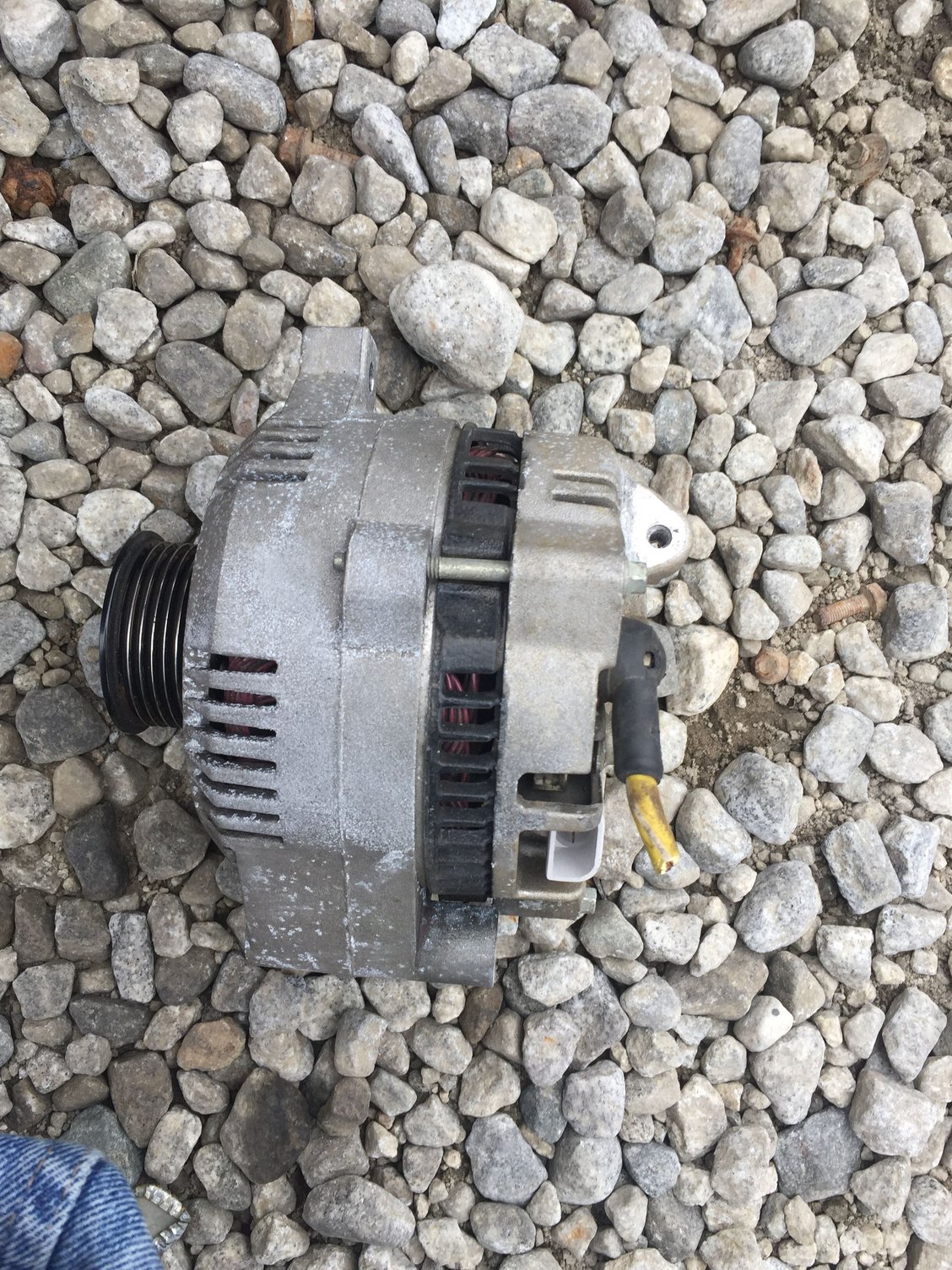

That is a 130 amp alternator. You can tell b/c it has the two holes, not four, between the stripes(ridges) on the front of the case.
You can 'clock it' and turn the rear of the case, separate from the mounting flange, by undoing the three screws seen around the front of the case. Undo them, turn the rear of the case so the wires are where you want them (not sticking up in plain sight), and then but the screws back in. Don't pull it apart; just turn the rear of the case.
That white plastic piece with the connections is the v. regulator/ brushes unit. You can get a new one on RockAuto for about $10. There is a great vid on youtube that shows how to rebuild one correctly, so you don't have to buy one rebuild in the 3rd world, should the need arise. If your used alt goes out, a rebuilt will run you around $180! Rebuilt! That's why I know about the youtube vid. Good luck.
Oh, and if you're installing on a v belt set up, use a pulley with double belts, and run two belts. Mine squealed badly with a single belt. On some pulleys you may need a thin washer behind the pulley to keep it from scraping on the case.

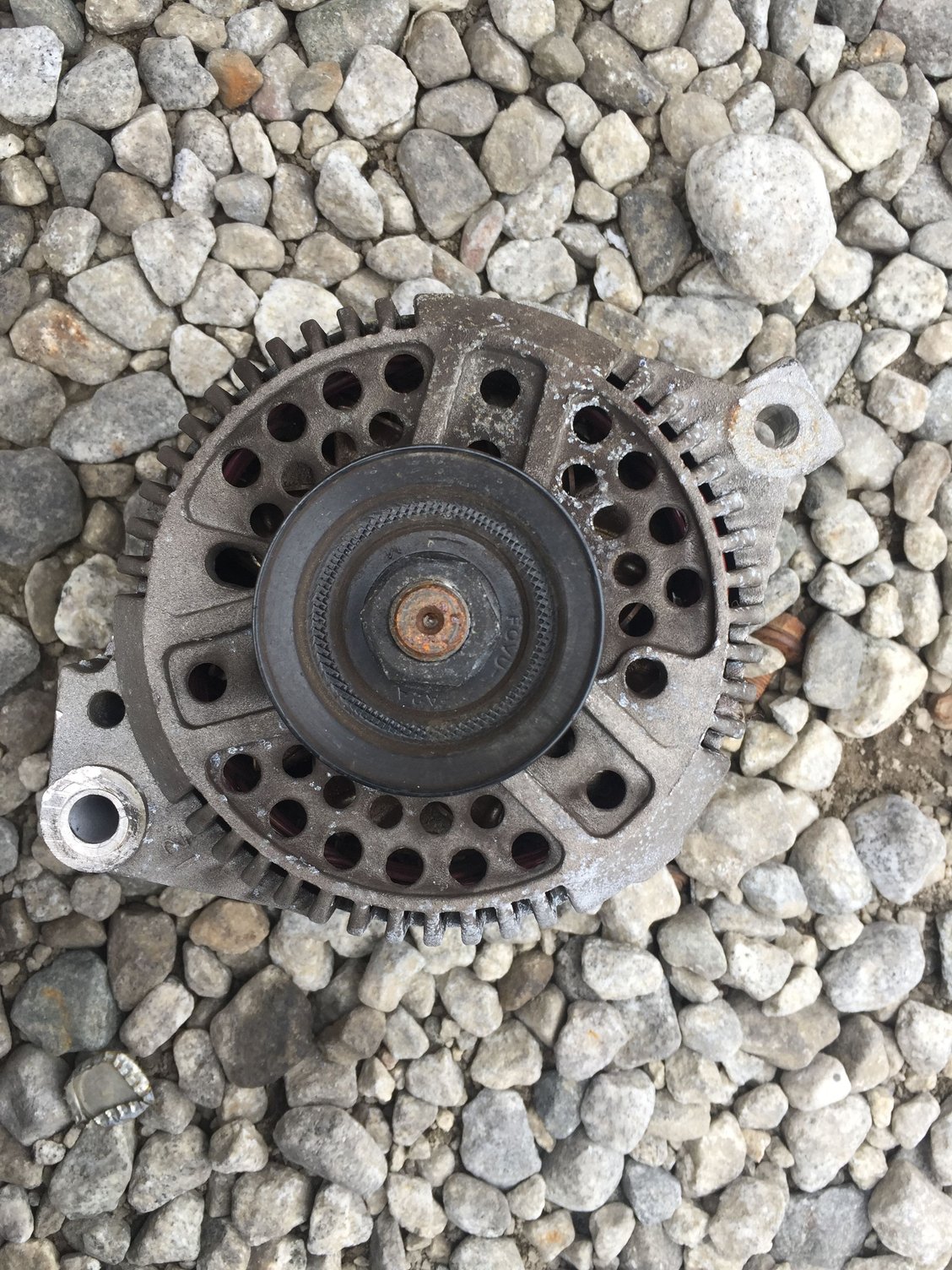

Did you measure the spacing between the mounting holes? I needed a 8.25" which I did find but all but the one I pulled were 7". For some reason I thought only 8.25" were 130's.

It is the right one so long as you are mounting it in a v8 application. All the Sixes required the extended tabs. 130A was avail in both configurations and like others have said, 2 holes = 130 amp.
that's the part I wasn't understanding I guess. 8.25 inches between mounting ear holes. The one I got appears to be 7 inches but it matches the one coming off my truck.

Looks like, no matter what, you have a 130A that will fit your application.

That's good you were able to get the 7", they seem really common. My bracket was for the 8.25" so I didn't try messing with a 7".
Some people said they had trouble bending fan blades torquing the pulley back on. I stuck bolts in each of the holes that I could and had no issues.
Im using a double groove pulley with a single belt on my 130A and so far no issues. I did ruin the first belt but it was because of poor alignment.

Pulley's should definitely be removed/installed with an impact gun.
Opinions, experience:
the little ears hole is A) not threaded and B) too big for the OE bolt.
tap the hole and use a bigger bolt?
or buy a longer bolt and use a lock washer / nut instead?
