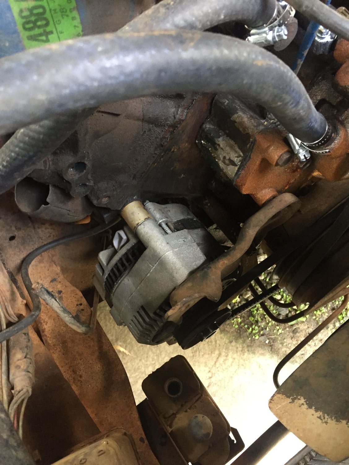

So, the issue as it turns out with this alt version, is its casing depth. It won't fit between the block and the bracket. If you look at a 90-95 Taurus version Alt, it appears to be not as deep.
Most of the later, more powerful alternators I've swapped in have been deeper and I haven't had trouble with them fitting. They're just tighter up against the head is all (at least the ones I've used) and still fit.
Sometimes you need a spacer of a different length, but sometimes you don't.
Is the lower alternator in your pic the original one from your truck? Do you have pics of your brackets?
Paul

Oh, and does it physically fit, but the output stud hits the head? Or is it just not fitting at all?
If it's just the stud then you can get the style of extension that Ford used on some applications that puts the stud out at a 90 to the back, sticking out the side.
It's actually a nice setup for anyone. Makes it easier to get to the main charge wire/cable without removing the alternator.
Paul

I don't know if mines original, it's just what came with it. I have a Camper Special and the alternator is the smaller of the two options available, which seems odd.
Paul
well, forget my post #21. As luck would have it, I was just being a moron. It's amazing just how stupid we can be at times.
