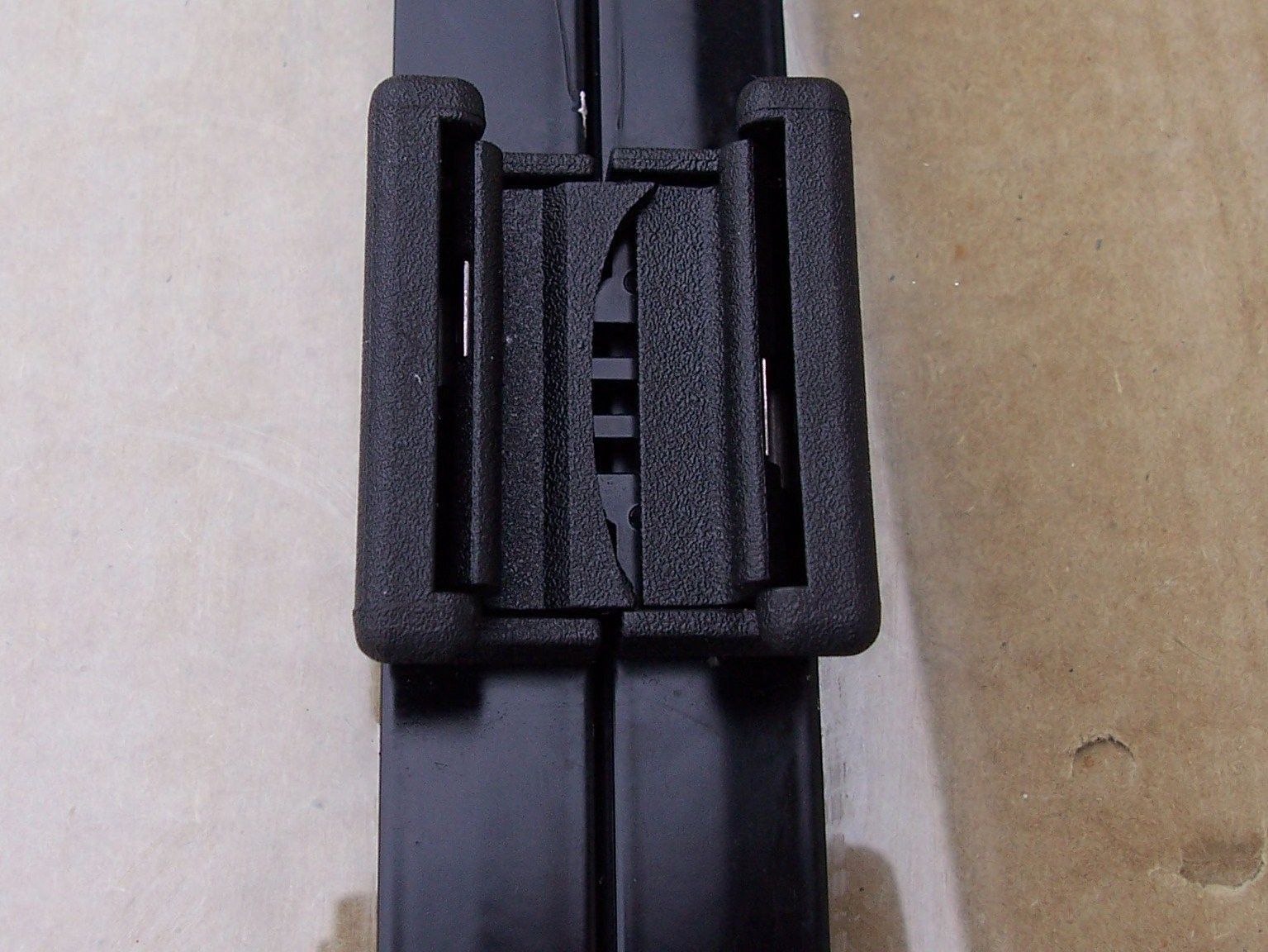

I used an OEM Ford back slider from a 1994 - 1996 truck. It fit just like the original one, except the latch is a MUCH better design; it can also be used as a handle and it won't break like the earlier ones would:
