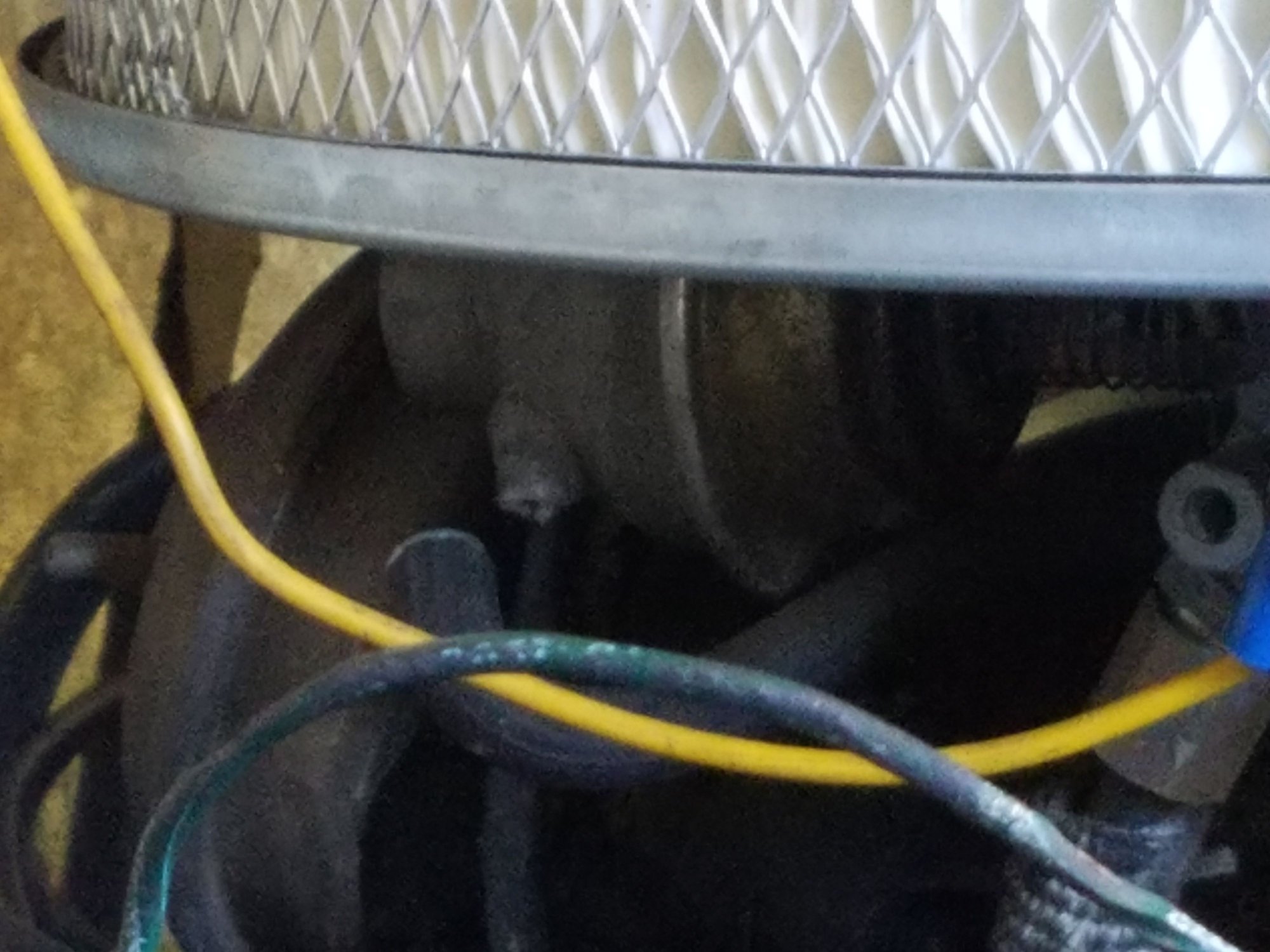

Can anyone tell me if this would affect how the truck is running wish my gues it does and if this is a replaceable part on the carb. It's on the passenger side, a port that had a vacuum hose on the little round thing broke off. Must have got brittle. Hopefully this pic is good enough to tell what that this is called. Thank you!

Yes that would have an affect it is an uncontrolled vacuum leak. It is called a choke pull down.

Thank you very much. Didn't have a clue what it was called. I hope it's a replaceable part and I'll just swap it out. Do you know what that part specifically does?

It assists in pulling the choke off once the engine starts. I believe these were used when a pull down piston in the choke housing was not used.

Technically it is a "choke pull off" (not pull down).

Technically it is called a choke pulldown. NOT a pull off.
