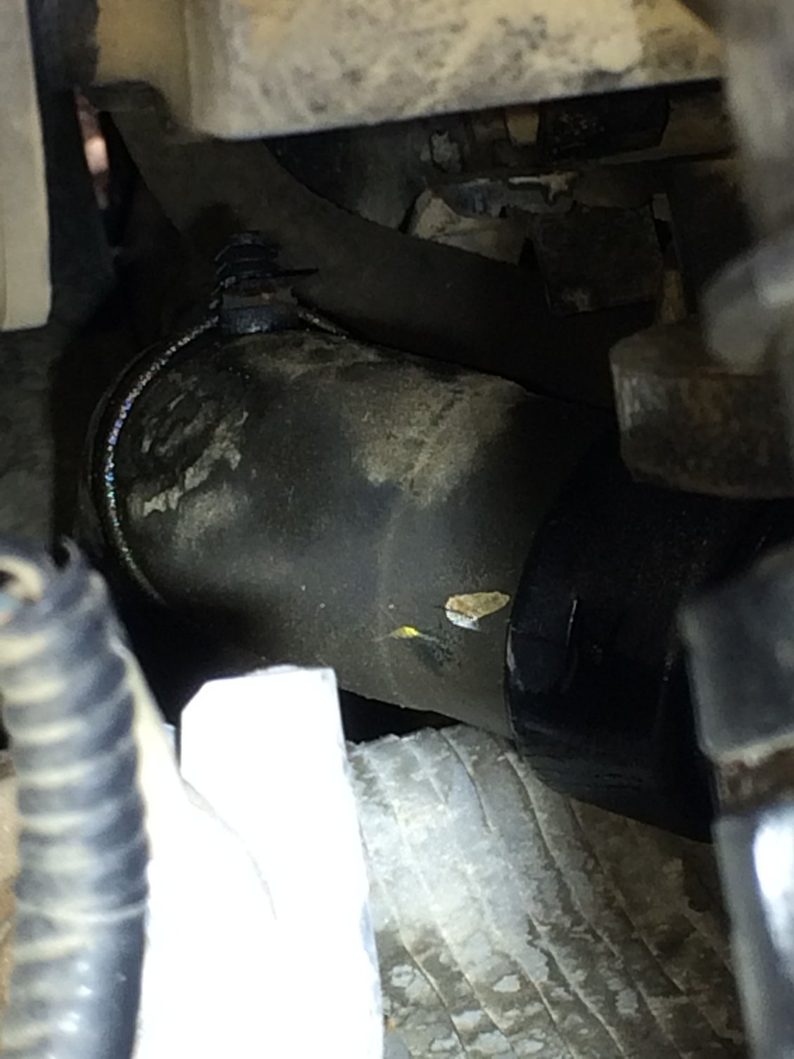

Coolant hose name?
Hello everybody, I've sprung another coolant leak on my 2013 F550 work truck. It's the hose that runs from the left hand radiator tank up to a Y connection. I would say it's a 3/4" hose. Just wondering what to call it? A bypass hose? Does the aftermarket make these? Or is it a Ford only part. Thanks in advance. Also I guess it would be a good time to change the coolant. Can I run Cat ELC like my 6.0? Or do I have to stick with the Ford orange stuff (which looks like dexcool to me and I hate that crap)?

Ok I've looked a little deeeper and found the hose runs from what I would call a coolant to air intercooler down to a smaller radiator in front of the main rad. I'll try to post some pictures but they might not be very good as it's pretty tight in there. Thanks

I'm assuming all the same coolant rules apply for the secondary system? I think I can build my own hose with a tee on the end.

Our local parts store is getting me in some Orange ELC and I'm pretty sure I can build the hose out of 1" silicone heater hose and a tee on the end with some 5/8" barbs. Be cheaper and last longer than the original I'm hoping. That silicone hose is good stuff. The only thing I'm worried about now is removing the intercooler to get at the hose.
