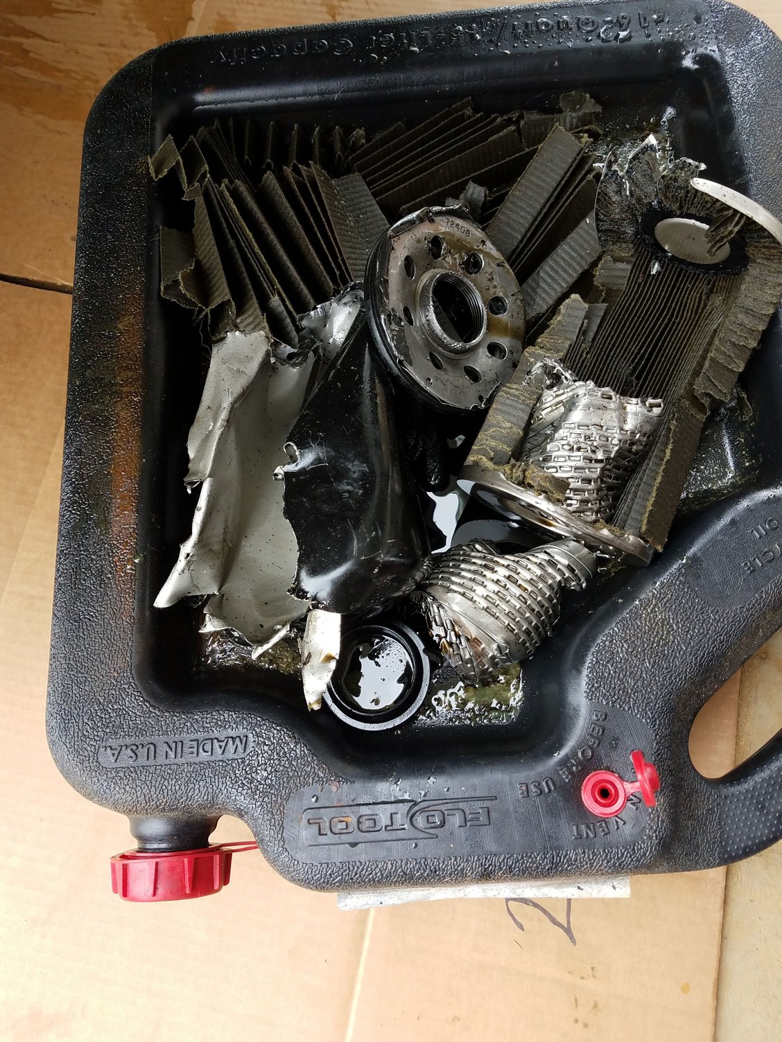

How Long does it normally take to get all of the diesel out of the cooling system? I flushed it until the water ran clear, and I checked it today and I had about an 1/8th of an inch of diesel on top of the coolant in the degas bottle. I sucked it off the top with a vacuum pump, and I'll keep checking it. I hope this doesn't me that my repair didn't take...

thats one of the few reason I don't go to local oil change facility. they tend to really spin the filter on and over time with the heating and cooling cycles they get tighter and tighter.
It clearly states to turn 1/4 way when you contact the housing.. I turn it till it stops with a lightish pressure, loosen and then retighten to 1/4 turn.. I do put some new oil on the gasket as well.
after some 50-100 or so miles slide under and check to make sure no leaks.
PS: how long it take to the cup replacement exercise?
Originally Posted by afmedic
Here is what my oil filter looked like when I got it off...
