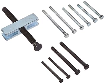

A few decades ago I had a buddy who had just gotten married call me and ask for help with a similar story on his wife's Camaro. Filter was stuck so he drove a screwdriver through the side of it and tried to remove it that way. When I got there, all that was left was the metal plate that holds the o-ring. The outer housing and filter were completely gone.
The good news is, you've got much more room to work on things than that old Camaro. What I ended up doing after some thinking, was to use a steering wheel puller to remove the plate, but not in the way a steering wheel puller usually works.
I found two bolts that would fit up inside the holes on the plate of the oil filter and slid them through the puller. Then used a pair of crescent wrenches on the slotted part of the puller to loosen the plate. You want the slotted frame and wrenches as close to the plate from the filter as possible so the bolts don't twist any.
You could try a similar approach with 3 screwdrivers (two in the holes and the other threaded between them), but it's hard to get enough torque on them that way since it's tight enough to have destroyed the filter already.
