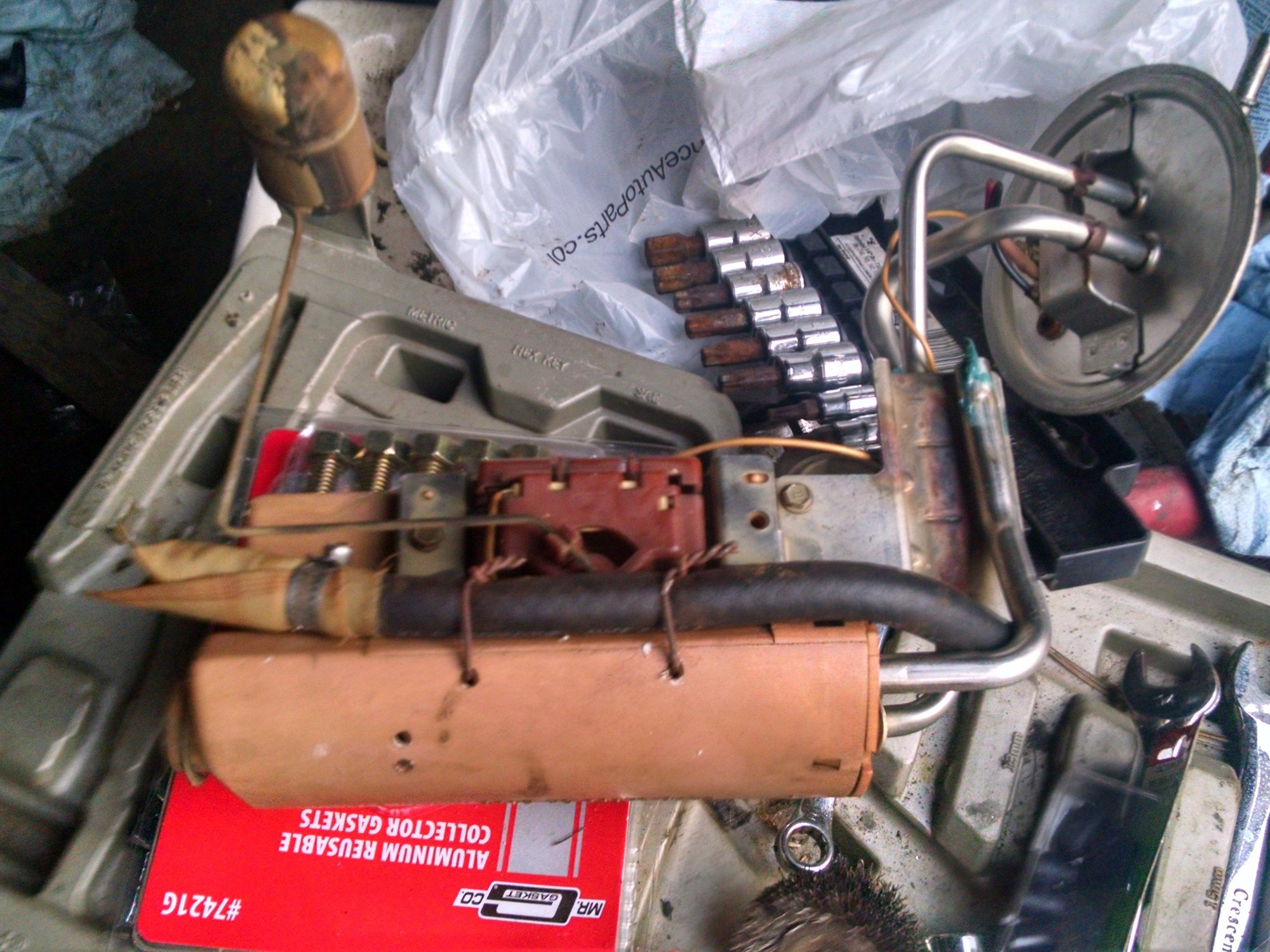

The insides:
Old Sep 12, 2017 | 07:29 PM
Tbrooks26's Avatar
Tbrooks26
Joined: Aug 2017
Posts: 67
Yep, that's it. So that's where the check valve is, and being "high pressure", looks like surgery will be on the schedule...or maybe "high pressure" is just describing the fuel pump. Guess I can wait til it's all together to find out

Well I think I have it figured out. The front tank was pretty easy
The rear was a little tougher. I could do it now without destroying the plastic housing, but some trial and error lead to some destruction to figure it out
