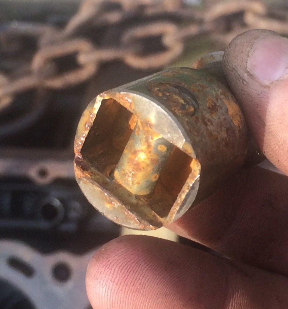

Failure Analysis ? DFC Diesel
The picture above is interesting, ignoring the oxidation.
But there are multiple ways for these to fail.

Oil pressure is not the issue, it is the indicator. The 6.0 thrashes the oil. As the viscosity drops so does the oil pressure. When the viscosity drops, it doesn't stick to parts as well, this opens the door to dry starts and corrosion. Parts lubed by splash are the first to suffer. I use the drop in hot idle oil pressure as an indicator of when to change oil.
Years ago when synthetics first came on the market I did a very primitive test. I took 2 screwdrivers, dipped one in synthetic oil and one in conventional oil, then hung them up. I don't remember the exact number of days, but it wasn't many, the synthetic dipped driver was bone dry, no residue. The conventional oil dipped driver held a film for well over a month. I tested Aeroshell aircraft oils and 2 stroke oils. The synthetic 2 stroke oils would be dry over night.
I believe the lifter failures are caused by corrosion, needle bearings need to be kept clean and smooth.
