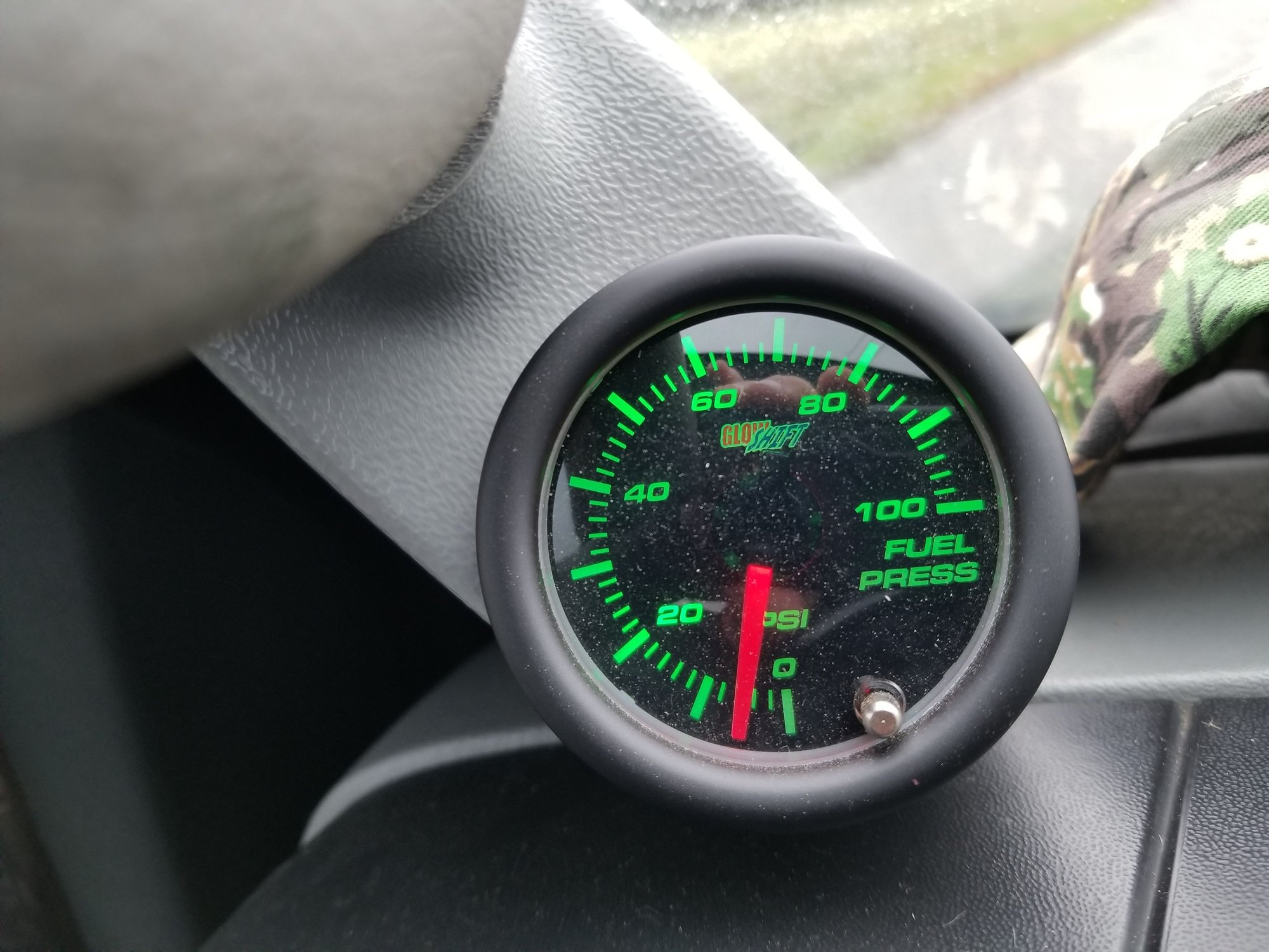

Originally Posted by akblackfoot
I used one of these:
https://www.amazon.com/gp/product/B0...?ie=UTF8&psc=1
Hooked it to my BullyDog docking station that I use for monitoring only. Have the coolant and fuel pressure. Been working great.

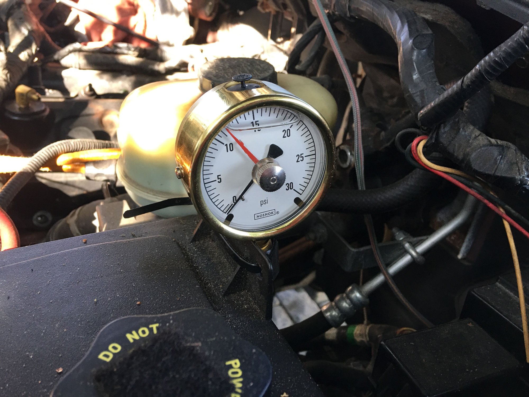

There have been some who have used 3 sensors to a digital gauge, using a three position switch; oil/coolant/fuel.
I've got a standard pressure gauge with a max pressure pointer so I can see what max p was when I wasn't watching.
This is what I was talking about, and was discussed long ago but can't find the thread. Not as inexpensive as RA's, but I was able to find it on eBay for like $30 rather then the $150 from McMaster. We used this brand with the pointer on vehicle brake testing in the 80's, they were very good.
The pointer is resettable, but shows the maximum pressure. Since you can't see it real time, it works underhood. Someday if I don't convert to electric I'll move this into the cab. It's also tied into my coolant filter base, using Swagelok fittings and aluminum tubing.
I only have it on for about 8 hours of running, just about all that in December, but I was running through the PA mountains towing a load.

I set a search on eBay for it and it took maybe 3-4 months to show up.
Center back would be a little cheaper.
The guy thought it was broke because the needle showed a few psi. What he didn't realize was there is a little tab in the top plug that has to be raised to vent it, otherwise it will change due to temperature or baro variations being sealed.
We would set the red pointer for a target psi, but it's actually a max indicator. Even in the cab it would work well so you don't have to watch to know your max that occurred.

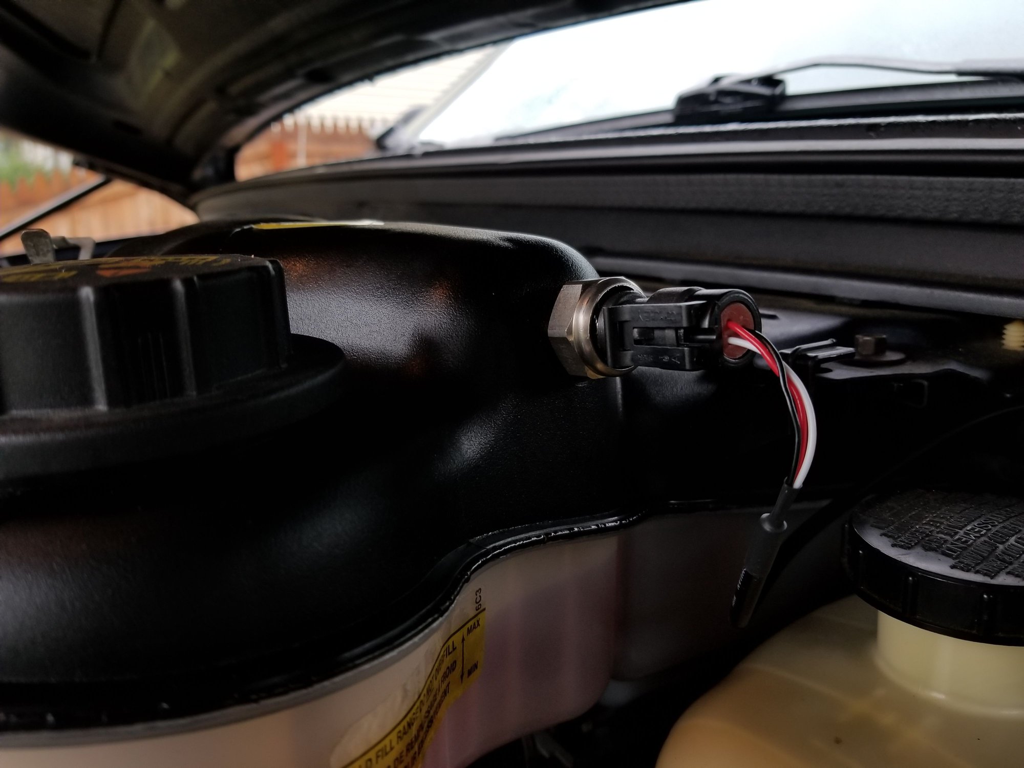

O.K. Following up here. I finally got around to installing another sensor in the top of the coolant degas resevoir. (See pic)
I released all pressure and went for a ride. @ operating temp pedal to the floor with over 21 p.s.i. boost this is the most I could get out of it, 5psi. We'll see what it hits next tow. And I'll follow up if it craps out which I don't think it will since it's not in direct contact with coolant, just vapor and air.
