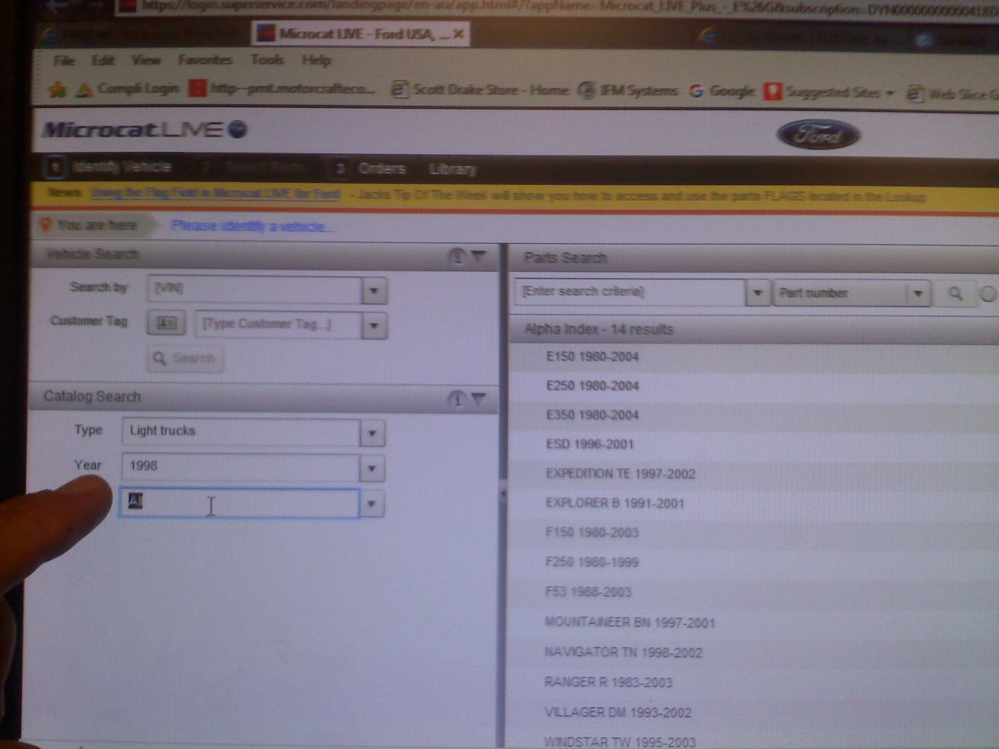

They may used to. But Ford doesn't now according to my Ford sponsored parts computer. It may be because they built so little of them for special orders. Like they built some for our Military for example. Just for giggles I looked up 1998 F250 16612 hood.

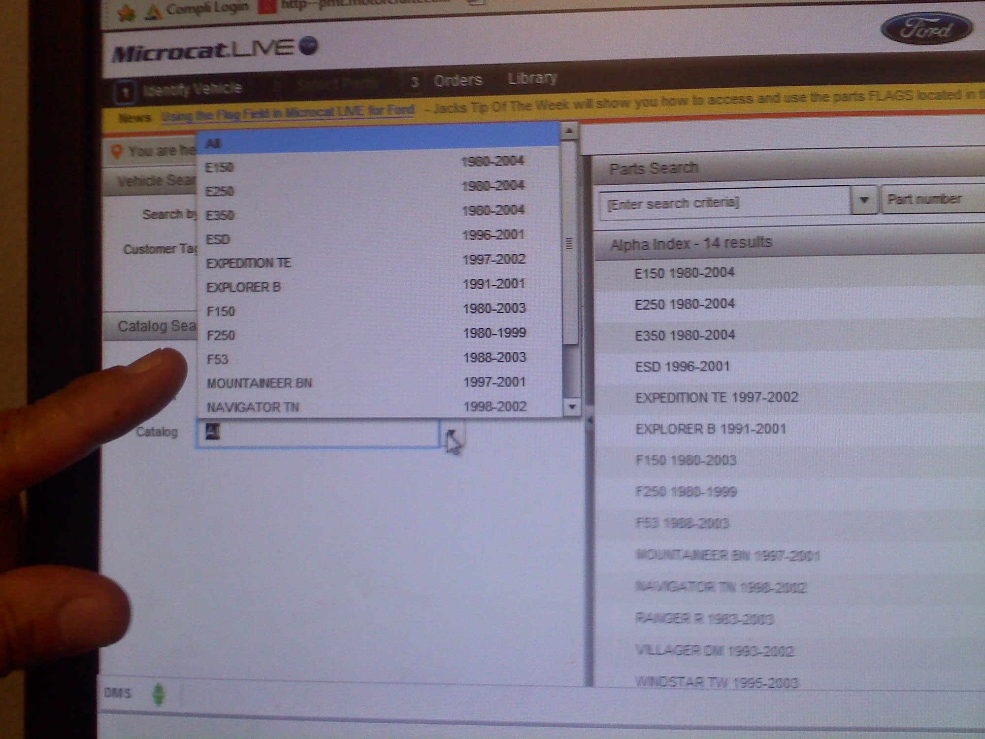

When I went to pick the vehicle line (F250) it only listed F250 and no F350. Starting in 1997 we had two F250. Old body style H.D and the 1/2 ton looking L.D. F250 with the 7 lugs.

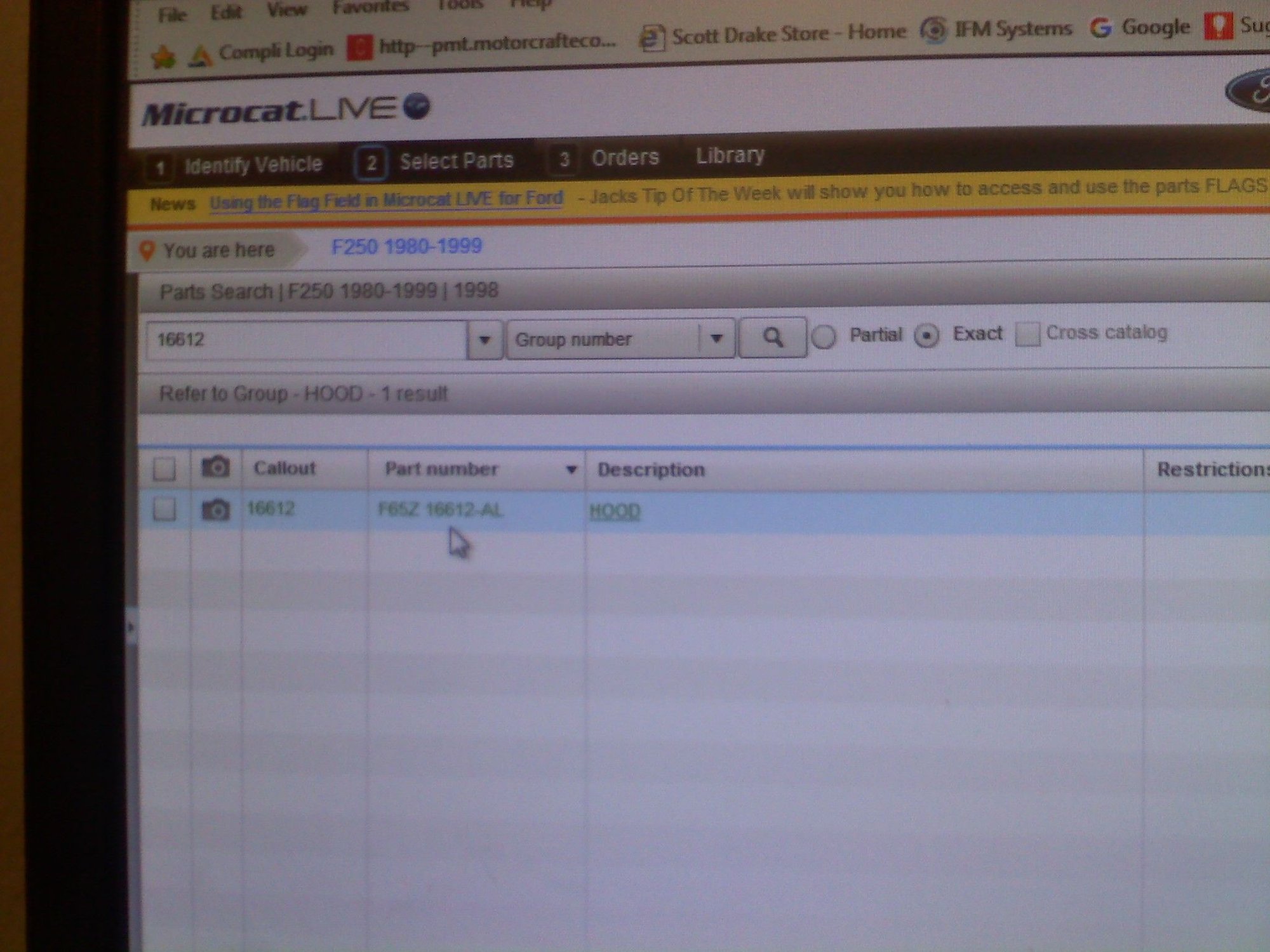

Once I clicked on "F250", I entered 16612. Which is a hood. Only the L.D 7 lug F250's hood was listed.

So my Ford sponsored parts computer doesn't recognize an old body style 1998 F250 or F350. If it did then it would have shown me both part numbers. 8 lug old body style F250 part number F2TZ16612A and the L.D. 7 lug F250's hood shown above. So to show you this I dropped back to 1997 F250. That is the year we did have both F250's. As you can see above now Ford shows me both part numbers.
