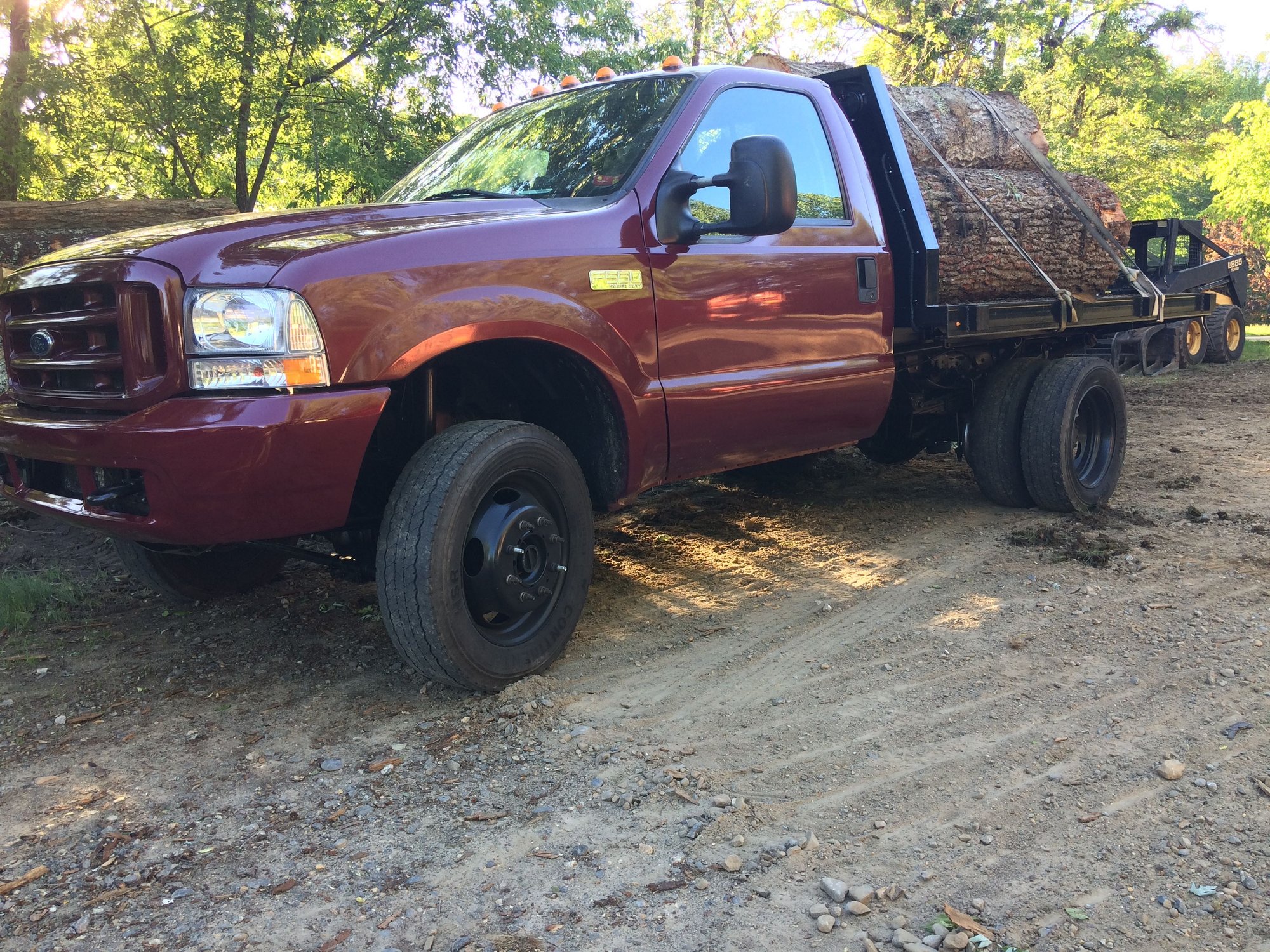

Here's my rig.

Here's my rig.
Nice truck. Get (or build) a relay harness. Power for headlights goes through 4 miles of skinny wire passing through headlight switch, multifunction switch, fuses, relays, etc and can have up to a 2v drop from battery to headlights!!! This alone will make a difference.
