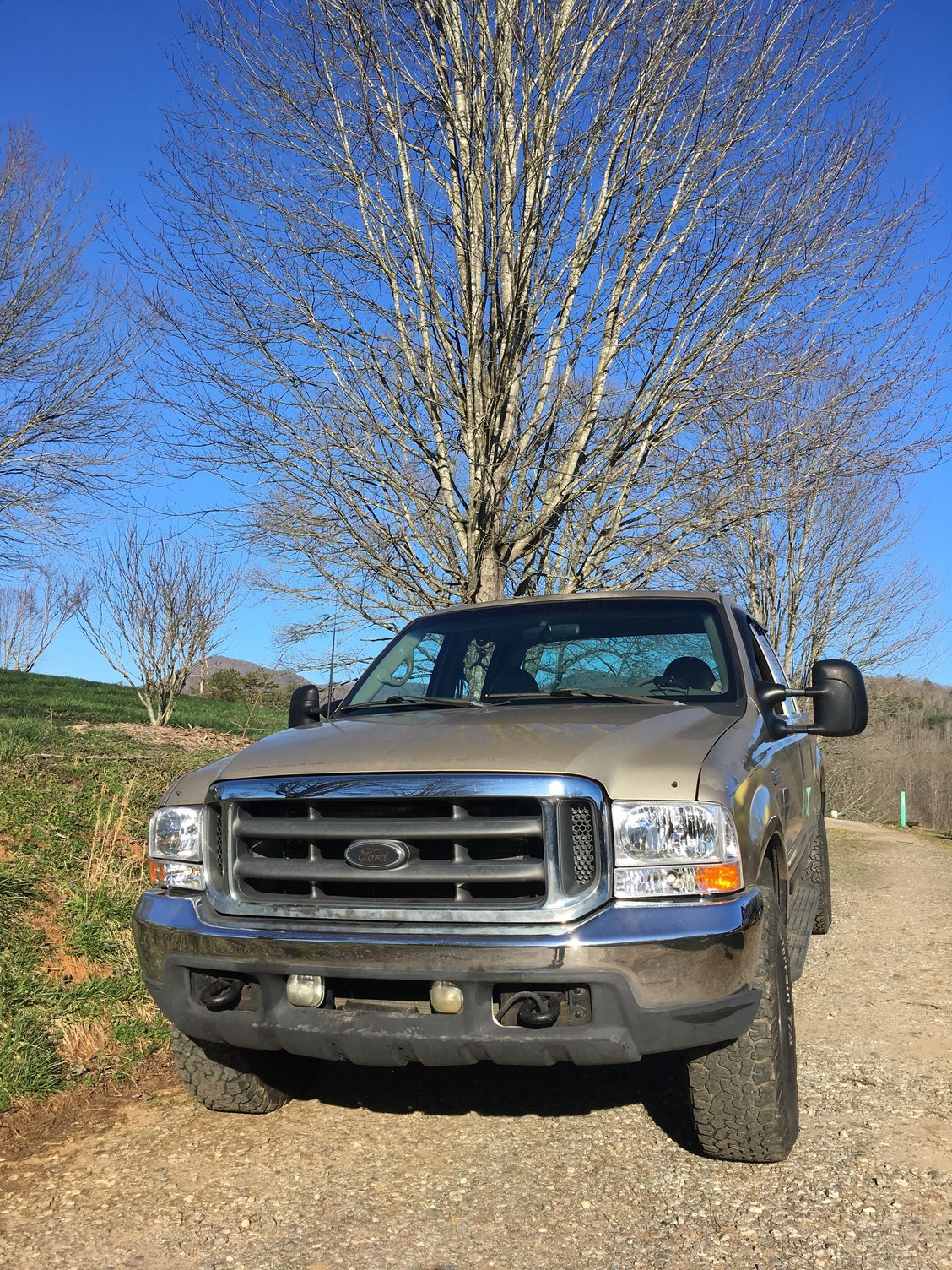

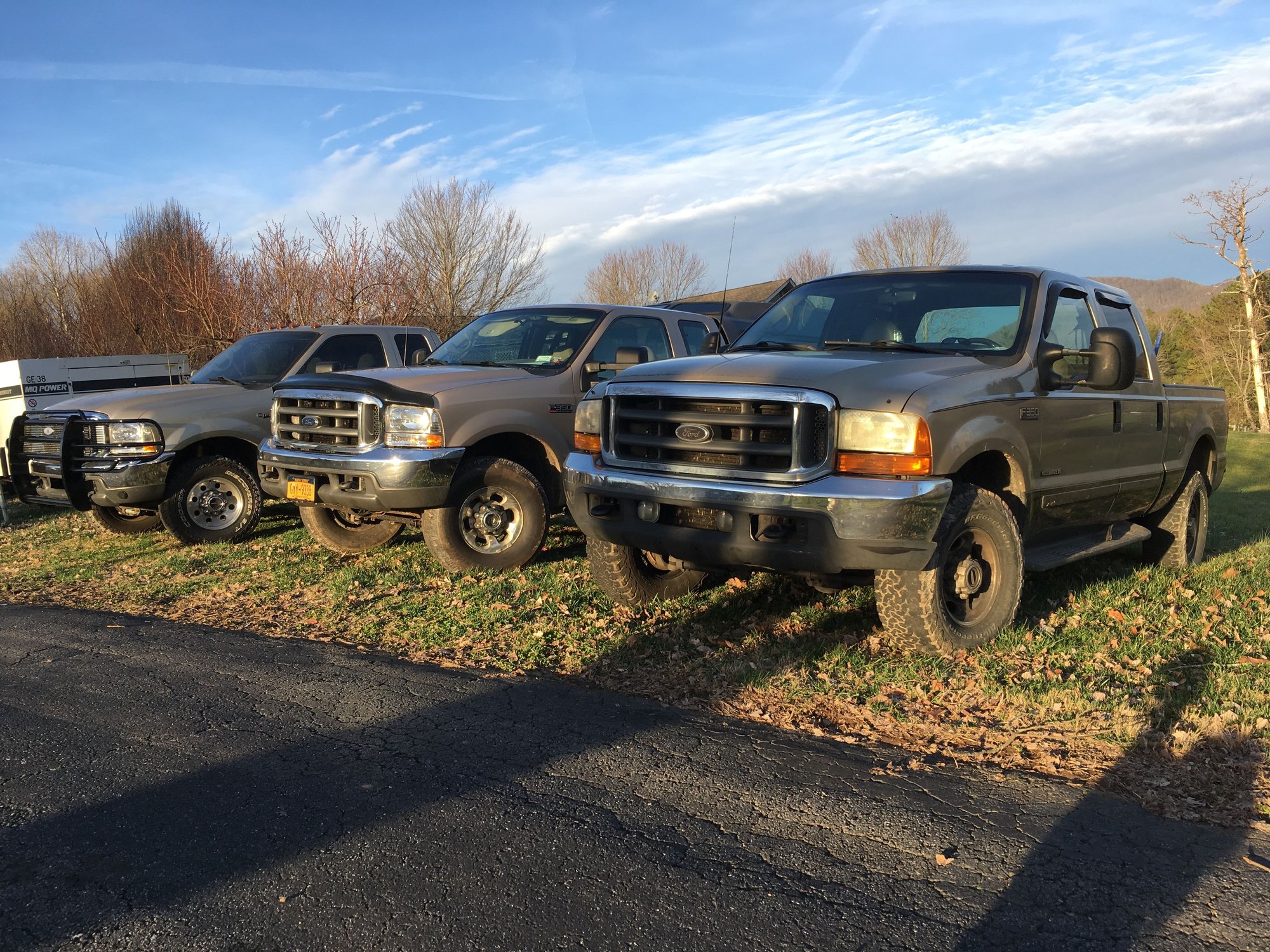

Before and after. Just did this truck the other day. Sooooooo much better even without high wattage bulbs and relay harness!! (They are on the way)

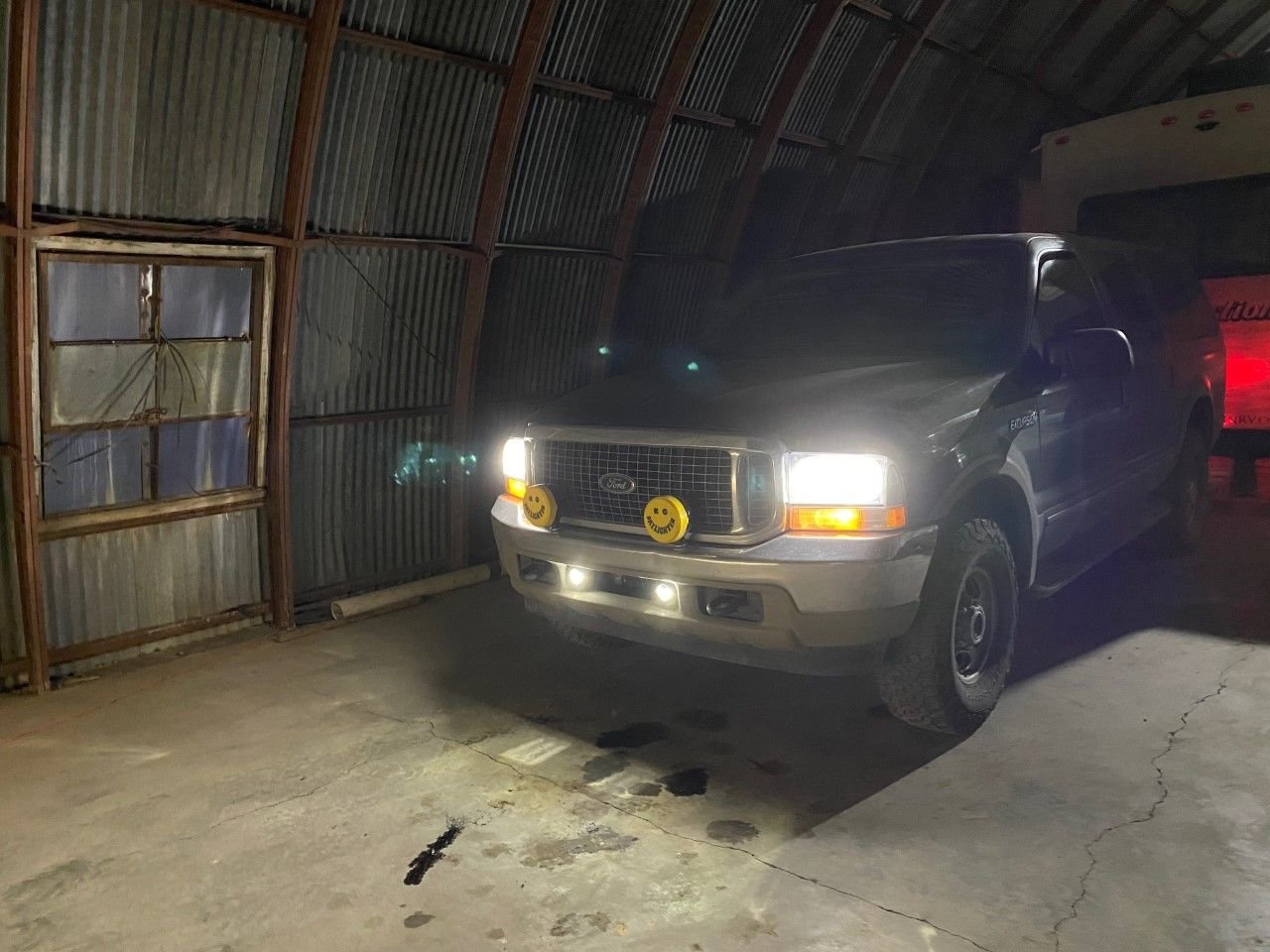

Based off of the research I did to locate the best lighting options available for our trucks, this is what I came up with. I'm sure there are other companies out there that make very well built kit's, but this is what I came up with. Here's a company that I've used for the past 10 yrs and they've taken lighting technology to another level. The Retrofit Source has accouple of options for our turcks to obtain lighting comparable to what we see on Mercedes & BMW's. I've used several of their kit's and they are very well built. These are also not the cheap Chinese garbage LED's & HID's that you see on ebay and other site's. These are high quality kits. They're not for everyone, because as I mentioned they are expensive kit's. NO, the LED's when installed in our stock head light buckets will NOT throw scattered light all over the road and blind oncoming traffic like you see so many trucks and ricer's running on the road. Anyhow, I've attached a link and it offers quite a bit of info for anyone looking to upgrade your factory lighting. I've done 2 of these LED's headlight conversion kit's on my trucks to include the factory driving light assemblies, and they are amazing.
https://www.theretrofitsource.com/bu...Ford_Excursion
Excursion LED Conversion.
Light parrern at 30'
Your Headlights cleaned up pretty nice Jason. I replaced the buckets on the Excursion after a cousin did a clean up on the stock ones. He sanded them down and sprayed a clear coat on them and they didn't turn out to bad, they definitely looked better than they were. Anyhow, as I mentioned, I opted to put new headlights and an LED conversion kit on the Excursion and they turned pretty nice. Boy I have to say, the brand new 17-2020 trucks blind the heck out of guy going down the road. They are extremely bright, and more so the higher end trucks that come out with what I believe are now LED's.
