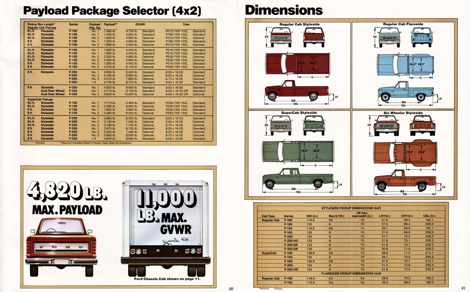

Here's the payload ratings for the 1982 models. You can see you are well within the limits.
http://www.oldcarbrochures.com/stati...ckup-20-21.jpg
Old Aug 21, 2017 | 07:20 PM
matthewq4b's Avatar
matthewq4b
Joined: Feb 2008
Posts: 5,831
Likes: 121
From: St Albert, Alberta
Good find Dave takes the guess work out it completely.
