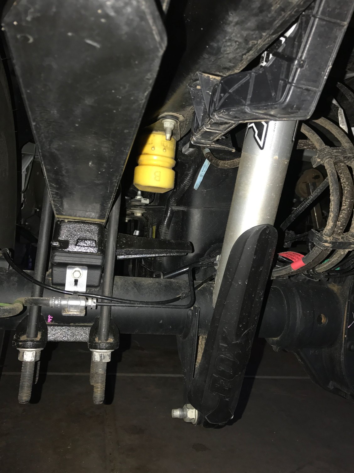

Can I really get away with not replacing the four U-bolts?
They're about $20 each, so not cheap. However the current ones seem to have only an inch of threaded area above the plate that's under the spring, so wonder if there will be enough threads to secure them with the shorter spacer in there. Thanks!
They're about $20 each, so not cheap. However the current ones seem to have only an inch of threaded area above the plate that's under the spring, so wonder if there will be enough threads to secure them with the shorter spacer in there. Thanks![/QUOTE]
It's close, but it does work. I debated just cutting them off, but haven't done anything yet.

Mine look the same as mothnuts truck with stock u-bolts. Still some thread left when tightened down. If you can figure out the right size u-bolts it is better to install new ones if you can, but not critical. The perfectionist in me will have me putting new ones on as soon as I find the right part# ......

The threads stretch on U-Bolts, Their Rolled on threads. Best to replace. Find a local spring shop. Their not expensive. unless you go to the dealer
