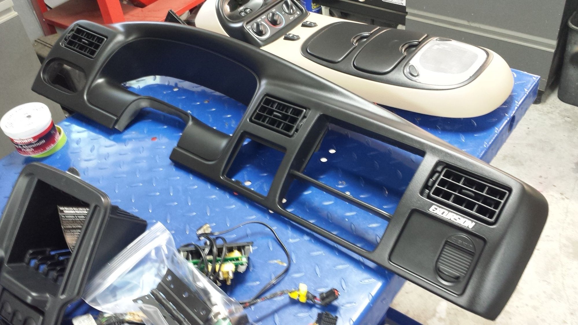

I wanted a black bezel, just sprayed mine out. Matched the vents as well.
Done and done.
Any 00-05 excursion dash will work regardless of color. As a matter of fact the original dash was med parchment. It was sprayed from the factory.
ANY 00-04 F250 dash will work, though you won't get the excursion label on it.
See my cummins build thread for more.

Great job!
One last difference (I didn't see it mentioned).
The SuperDuty dash (based on Cab style) will ALSO have a passenger side airbag disable switch (standard cab, has no backseat for the baby - hence a switch is required). The excursion does *NOT* have the wiring for that switch either.
I have this old thread link as well (the photo bucket pics are gone though)
https://www.ford-trucks.com/forums/9...excursion.html
It details the re-location issues behind the dash, with using the 05+ SD dash
Done and done.
Wow, that looks great!! What kind of paint did you use?
