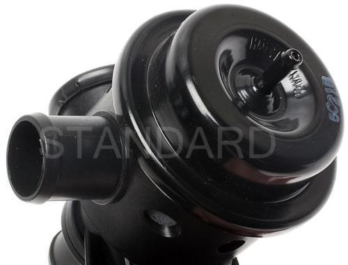

Something that looks kinda like this ? SRV

No I have nothing that even looks similar to this nor do I know what that is. I would assume it to be passenger side correct maybe near this guy

Looks like it was removed and bypassed. So, don't worry about your TAB solenoid anymore.
So, you can disconnect the vacuum line to the TAB Solenoid (White /with Red Stripe)W/R s. coming from the right side line on the coffee can.
Plug the line or cap the coffee can.

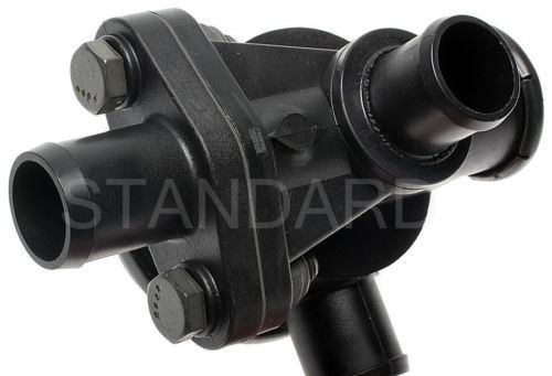

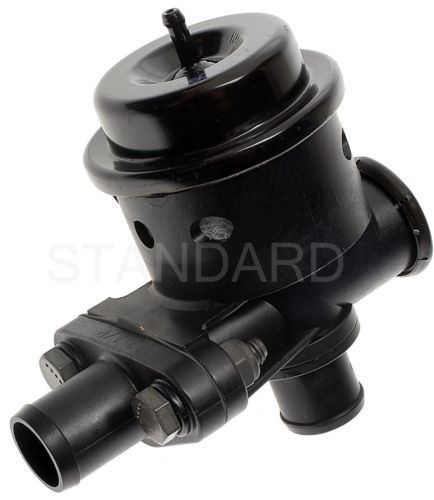

Ahhh, it probably looked more like this; You can order this for $125 on Ebay.......
