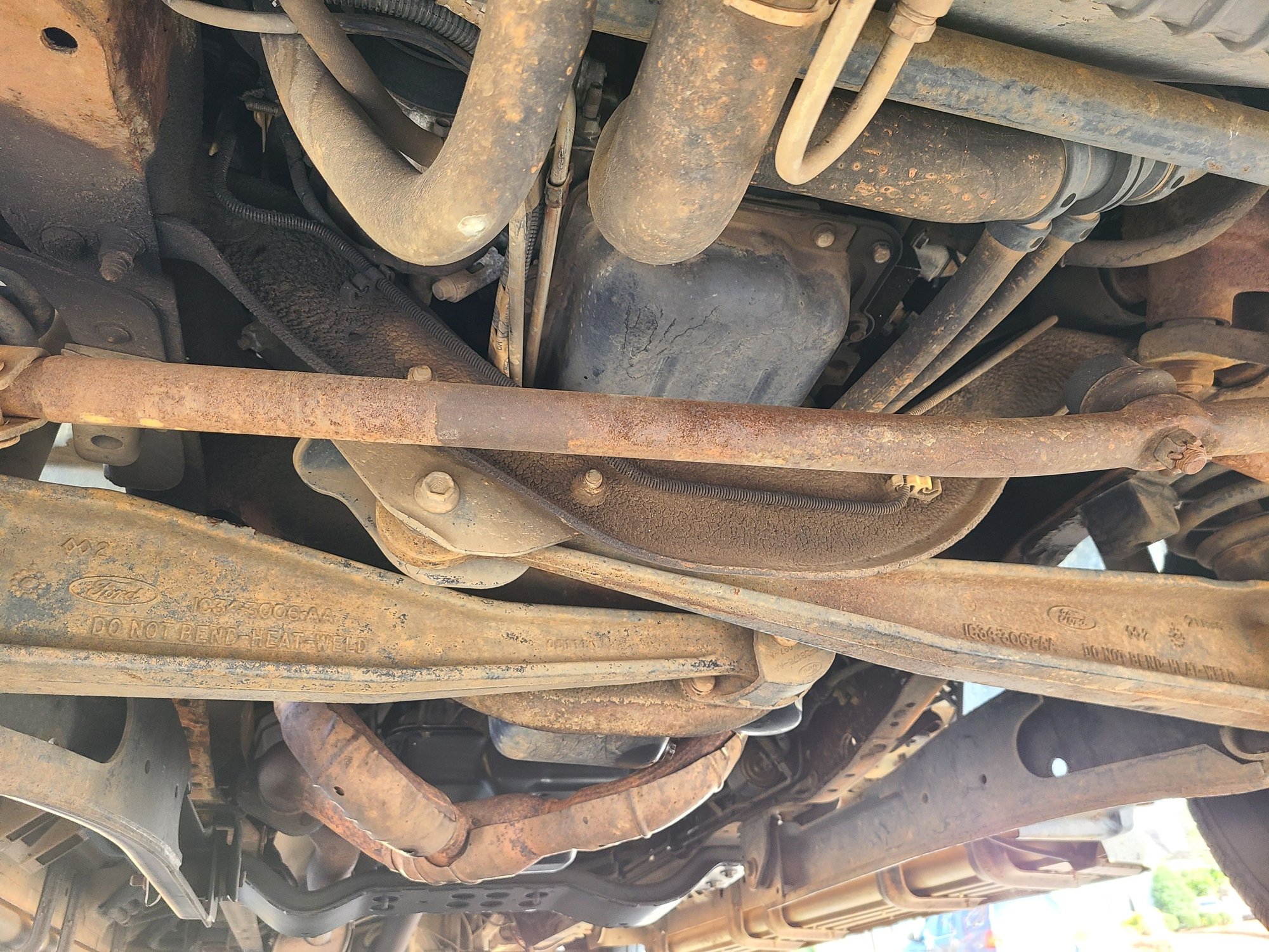

Yes, old thread, but is this front axle I-beam good to go to lift the front? just making sure.

I position the jack more to each side just below the rods that stick out of the I beams.

I lift on either side of the I beams closer to the wheel hub, and put a jack stand on either side of the truck under the I beam closer to the center pivot right next to my jack. Works great, never had an issue.

Depends on what you are doing, If you need to remove wheels, I lift from under I-beam close to the tire to reduce the effort. If you are working underneath, I lift via the blocker beam, under the front bumper. The official jacking points are rearward of front tires under the frame.
