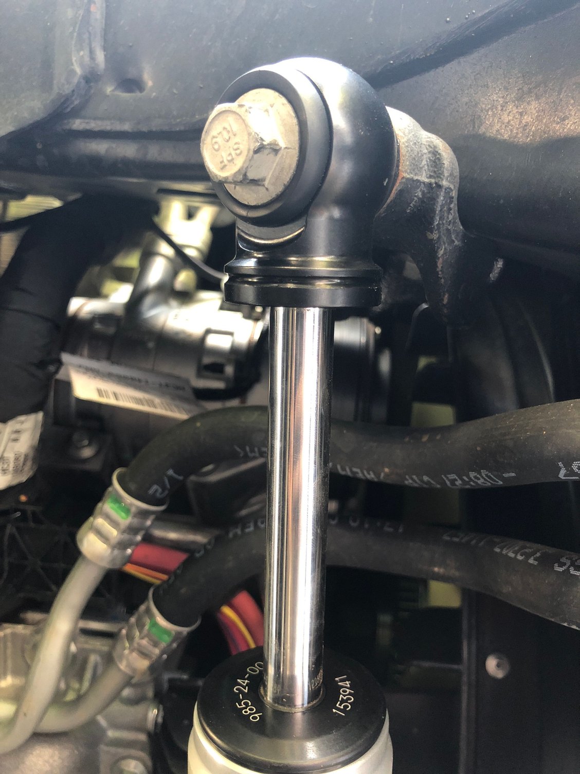

I just installed a Fox 985-24-001 today and spoke with a tech. These shocks are now correct for the 17 trucks. The fix for the shocks with the same part number that are older is to cut the rubber off of the eyelet around the shock shaft with a razor knife. That rubber is not needed on the 17s and is what makes it seem like it bottoms out. Mine didnt have the rubber on it and I attached a pic
Here is a pic of a helper holding the wheel full lock against steering stops.

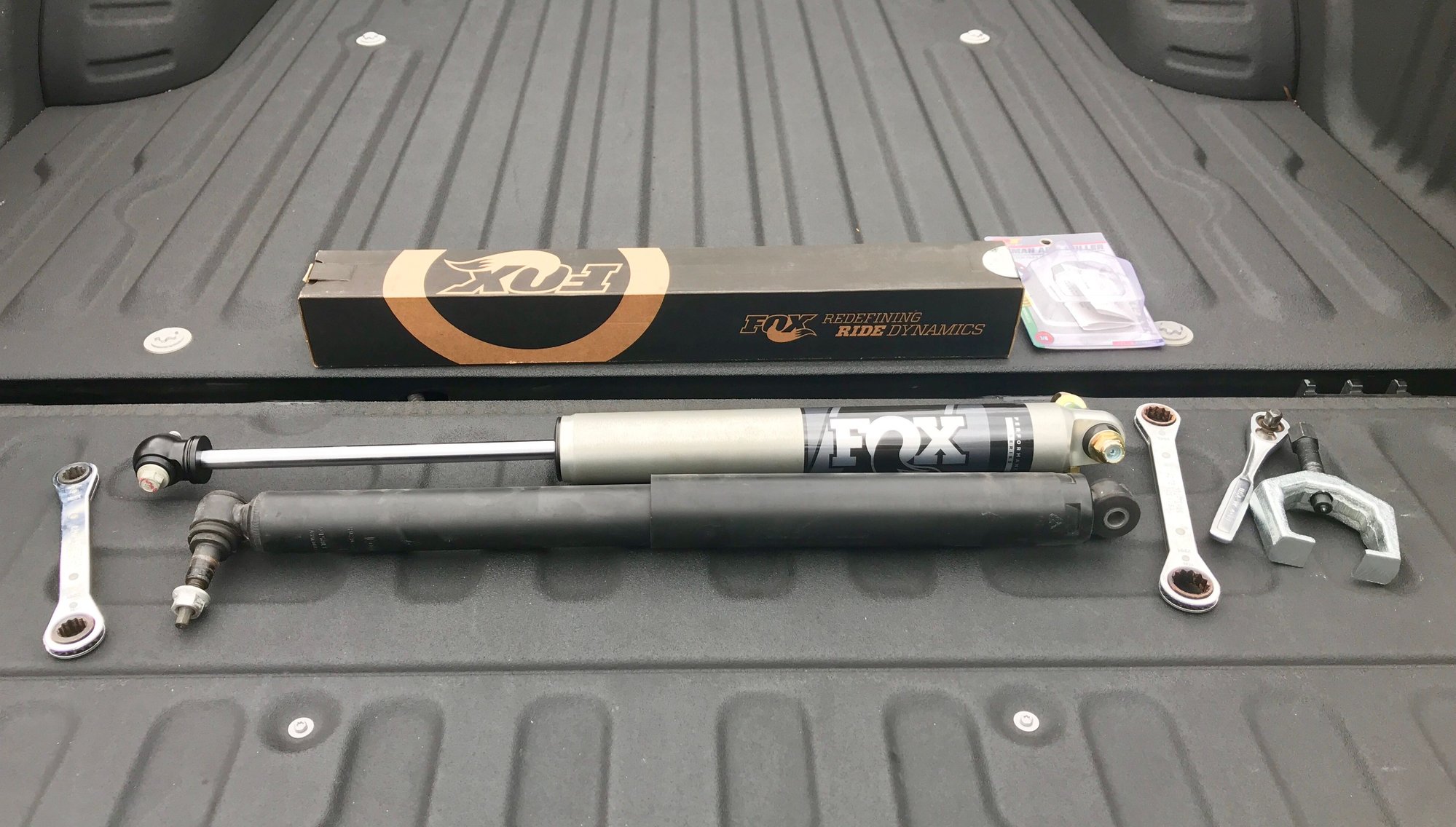

Mine just arrived from Suspension Conenction. They had a code for a 10% discount too. Made it fairly painless @ $160 and change. It’s been updated for the 17-18 Super Duties. Bought a pitman arm puller too, just to push the factory garbage off the truck without taking a sledge hammer to it. I’m anxious to see how it drives post install. Putting it on this afternoon and will report back.

I know, it has been argued over so many times on different threads. I finally decided to go for it and I have no clearance issues even with the suspension flexed and the truck rides so much better. No left pull either. A lot of people are getting mixed info from Fox but I can tell you from experience it works for me.

Got it installed today. Me and my 7 yr old pulled the old one and installed the Fox. So far-so good. Drove around 50 miles this evening and she’s smooth as glass. It’s a good unit - noticeable difference in the smoothness of the steering. Ready for some interstate time to see how it handles at 75/80. Hopefully the movement at 60/65 is gone.

i know! The distance between customer service and real users is getting further and further apart - and it’s everywhere now, not just Fox. So hard to find good help anymore. I talked to Suspension Connection and they said the part fits as it should. I concur after installation. All-good 👍🏻
