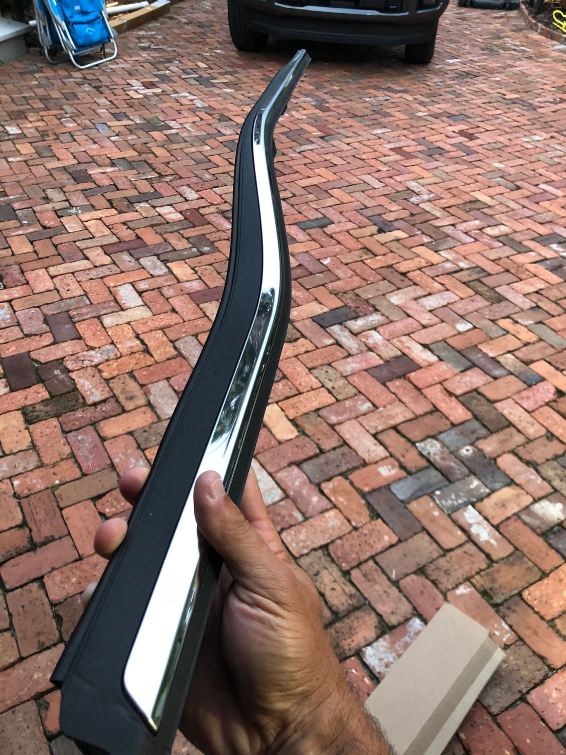

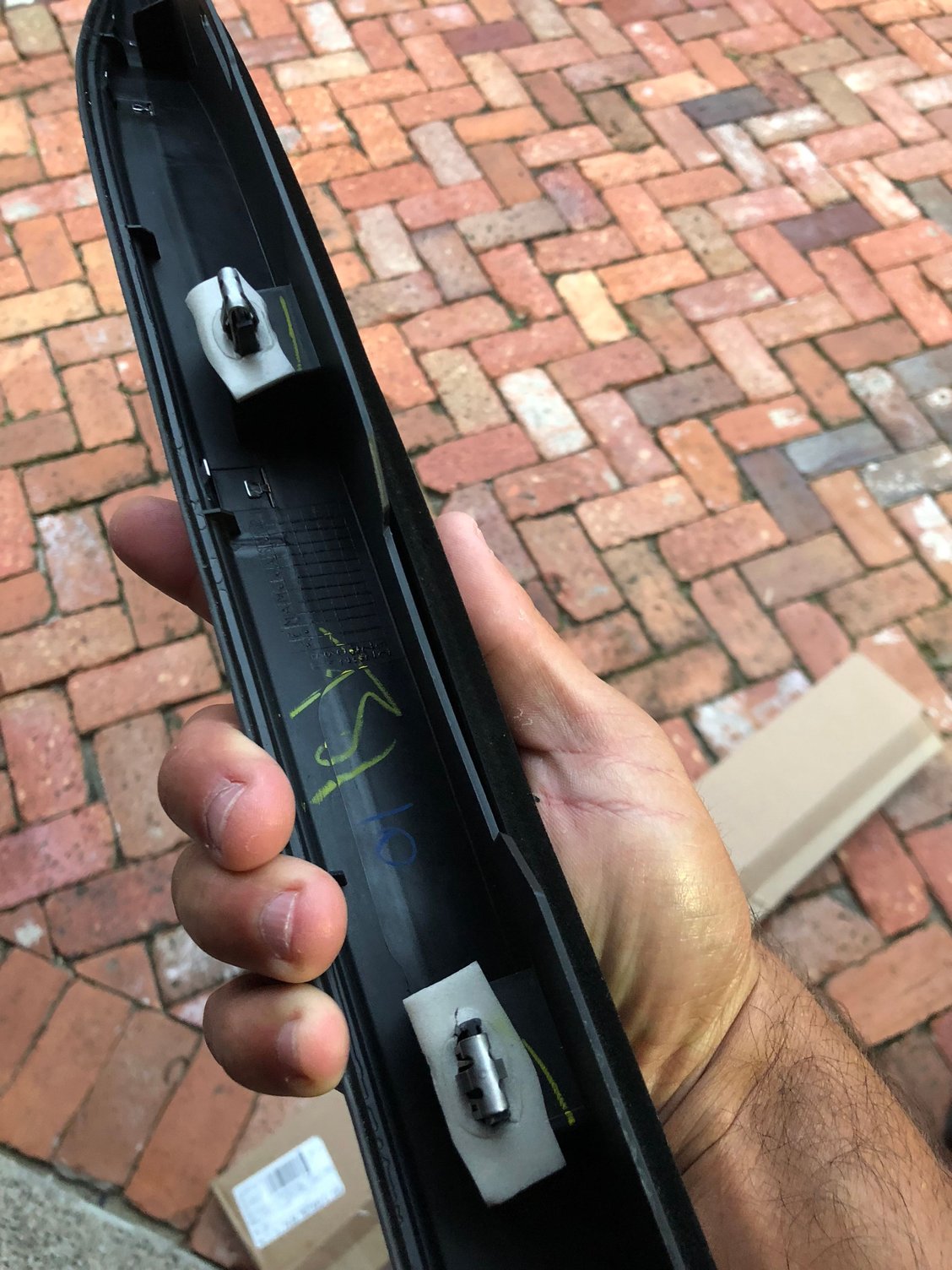

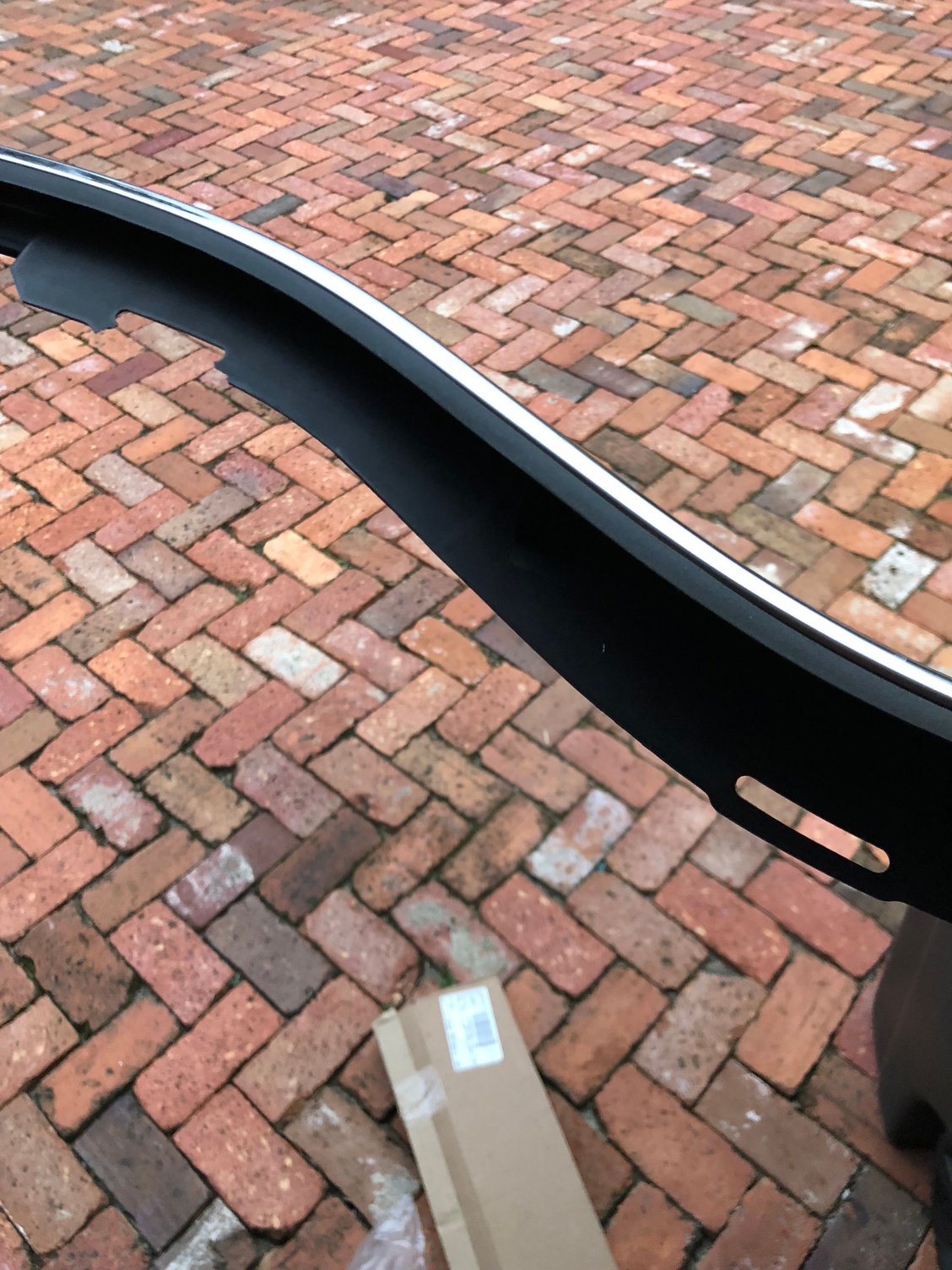

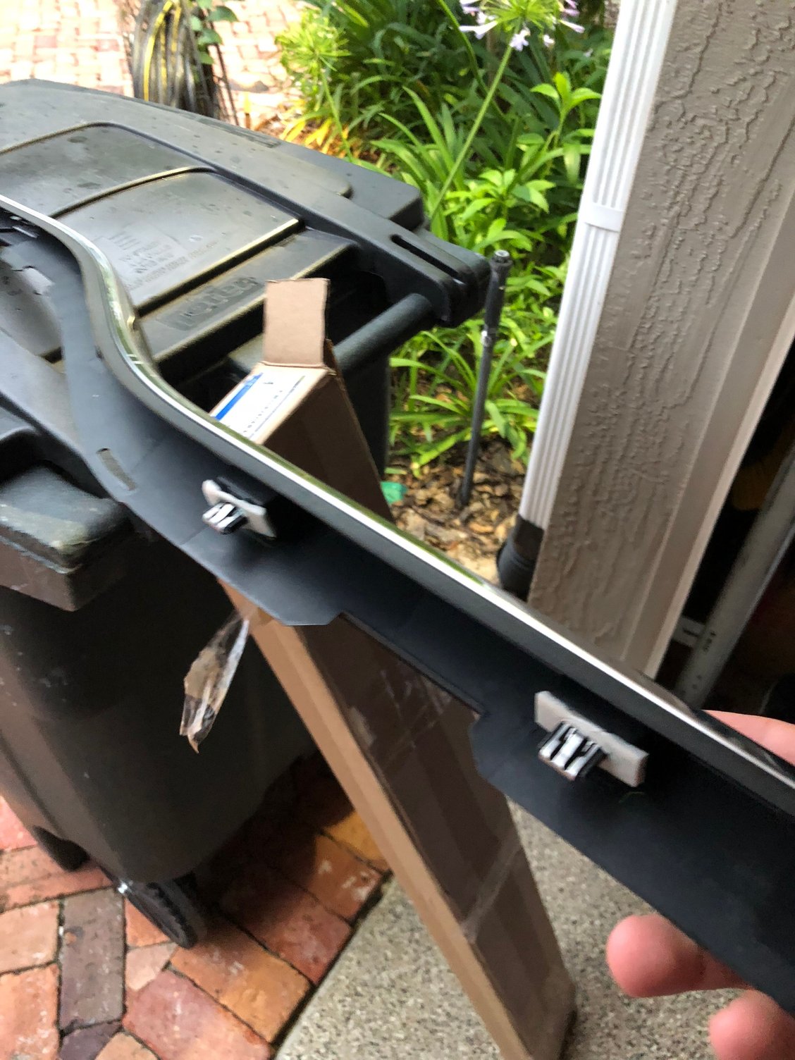

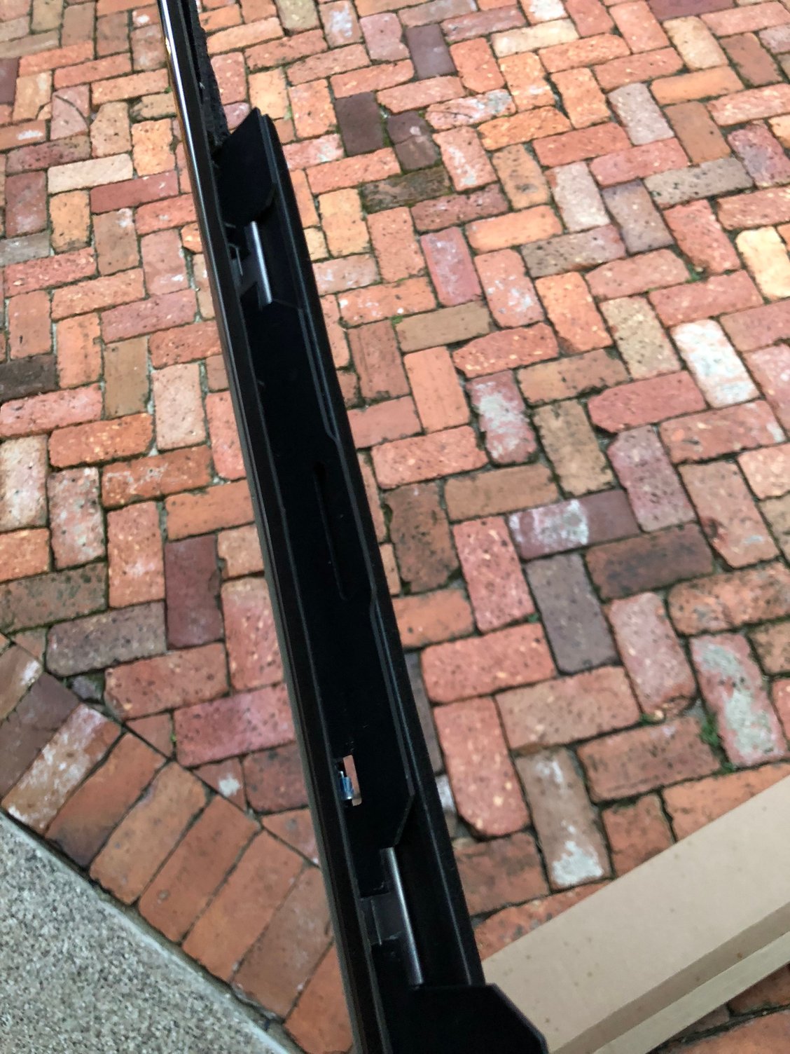

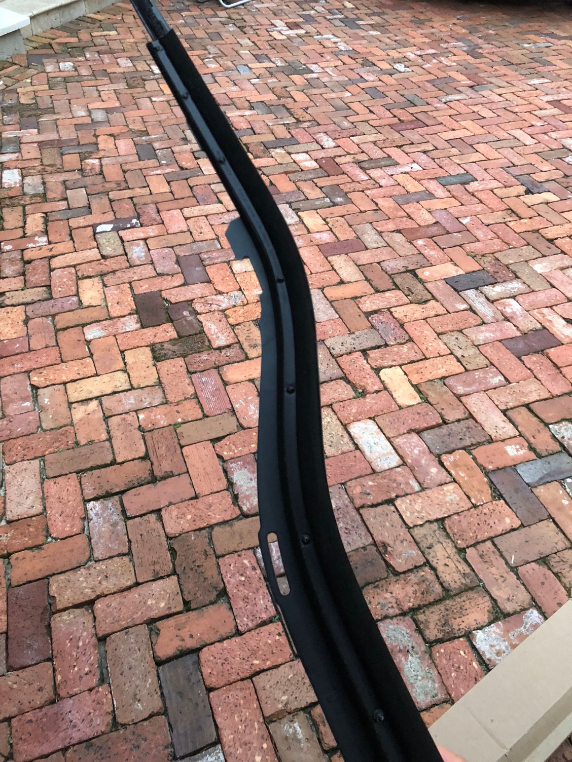

I’m selling my platinum window trim pieces. Truck is 2 weeks old. I pulled them off tonight. They are in great shape and none of the pieces were bent or damaged and all clips are intact. There is a plastic loop piece on the bottom of each of the front door trim that broke off but they do not impact how the trim pieces are held in place so I think they are a non issue. (See attached pics) selling as is. I wrapped them and put them back in the boxes I received my lariat trim moldings in.
asking $250 plus shipping (same price I paid for the non chrome ones)

whats the trick to remove them cleanly?

Leverage is your friend trying to pop the clips up but your enemy trying not to break the pieces. I slowly pulled up from the ends were the screws were and work hands underneath the peace as you go away from the screw and you’ll feel everything just pop And the piece will come right out.
One thing I didn’t do on the driver side which I should have was put painters tape over the door pillar the first 4 inches or so. I got a little glue residue from the piece where there is a piece of 3M or something on inside and it smudgd the pillar. I did it in the passenger side and was perfect. The tape will also protect it Incase you hit it when pulling the old molding piece off. Don’t want to scratch that.
hope that helps
