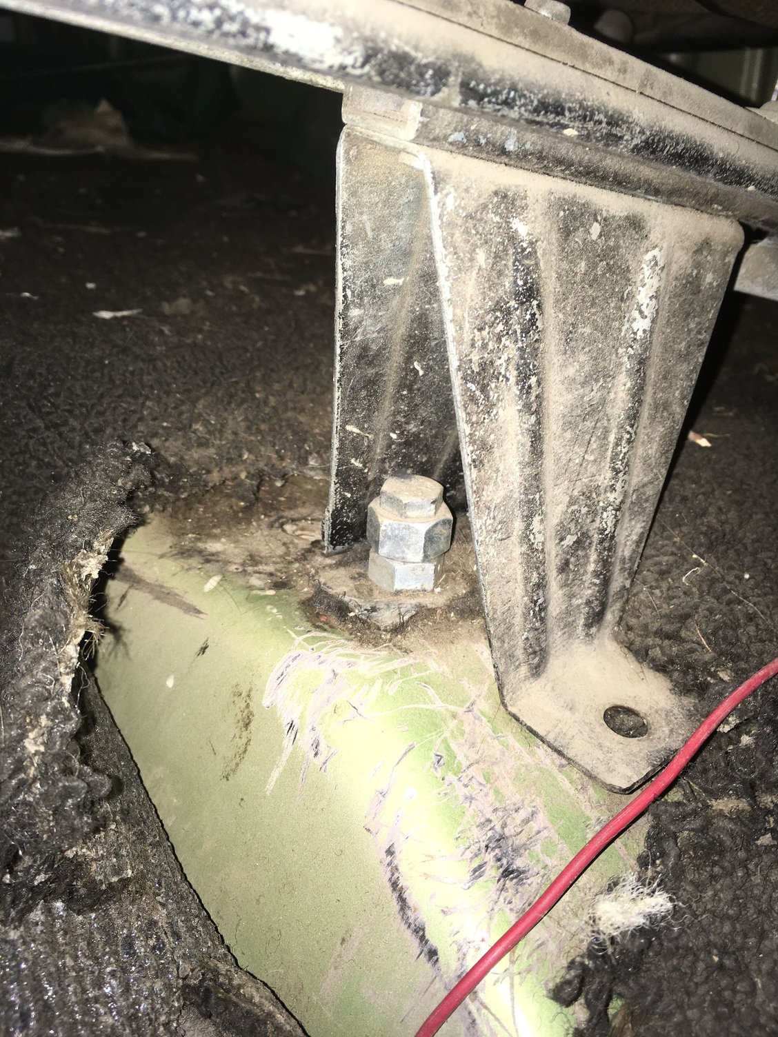

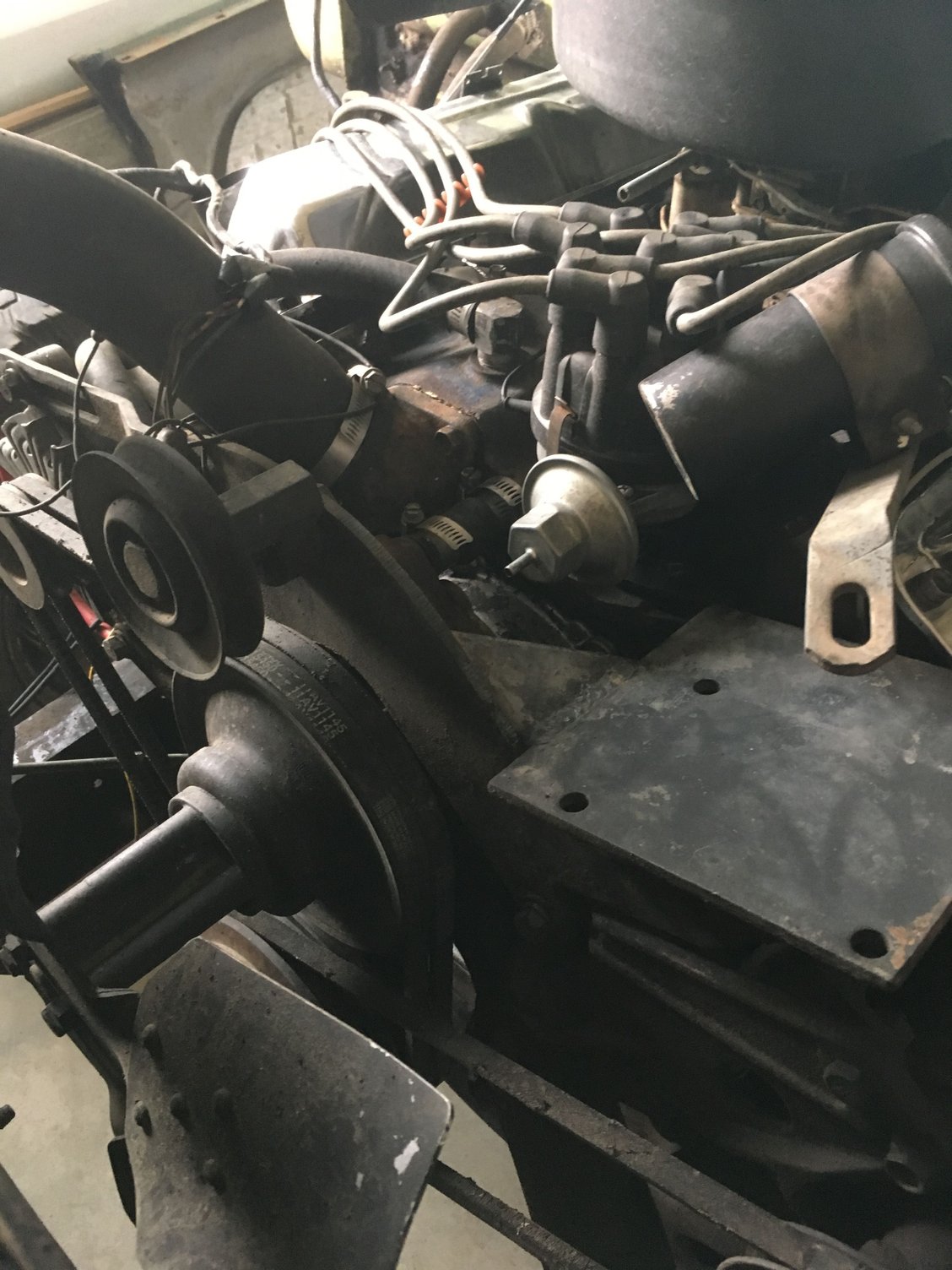

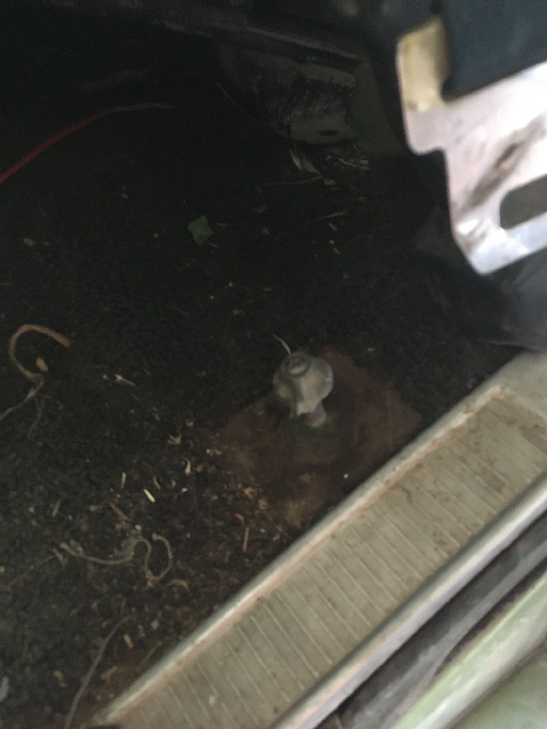

Got the 67 delivered and have a few questions as I'm new to these trucks so I'm sure I'll have slot more questions to come. But for now there is a bracket in the motor compartment not sure what it's for and my bench seat bracket doesn't line up with floor so I'm assuming it's a bench from another year?
Here's a few pics:
Bracket and pulley
This isn't right
What goes here?

Welcome to FTE and the Bumpside Kingdom.
Top pick is of an aftermarket York A/C compressor mount bracket and idler pulley.

Bottom pic is of the valve that manually switches the gas supply from the two gas tanks. Pic dark for my old eyes but it looks like the valve's handle is broken off. Note. The tank switch on the dash only switches the gauge between the two tanks. Not the fuel flow.

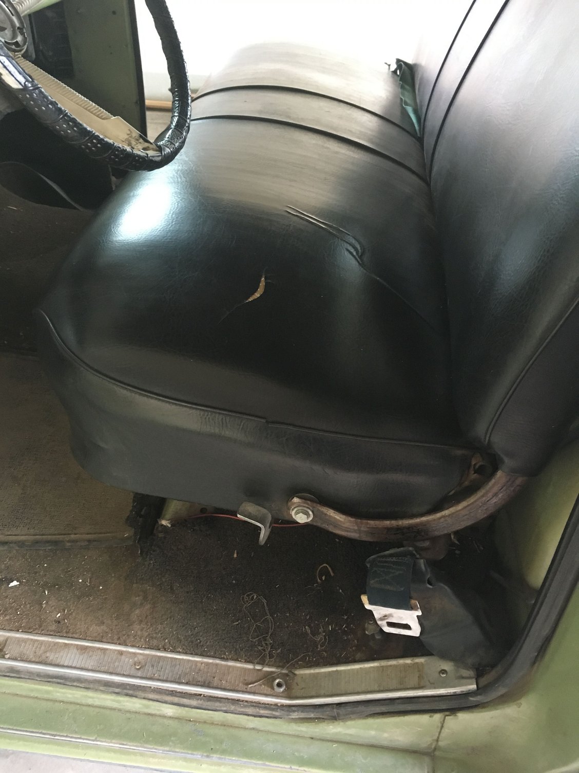

Middle photo looks like a different seat was installed.

thanks you guys are great! I'll get a better pic of the seat. Well I can pull that bracket and pulley then as I won't be doing A/C

Pic 2 is where the OEM seat is supposed to attach. Current seat is not a 67-72.

Yes the handle on the switch is broken. I'll have try and locate that.
Here's a few other pics of the seat.
Yep that's my thinking too. Who knows what it's out of. I supppse it'll work till I can locate a replacement.

You don't have to change the seat. Just put 67-72 sliders on that seat.
