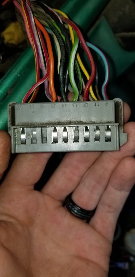

Originally Posted by mikeo0o0o0
The wire terminals are available:
D5AB-14474-FA, FORD AND CHRYSLER TERMINALS, TERMINALS - Terminal Supply Company - Product Detail
The plastic connector shell P/N is:
panel with warning lights: D3AZ-14489-C
Panel with gauges: D4ZZ-14489-B
that Amazon link dosen't exist according to Amazon. What is the correct name of the connector. Are they a special size or a uniform part. Thank you for the plastic clip part number I probably will eventually need that.

ok that was weird now it's got a good link. Thank you. Part number and description on that page. Your awesome

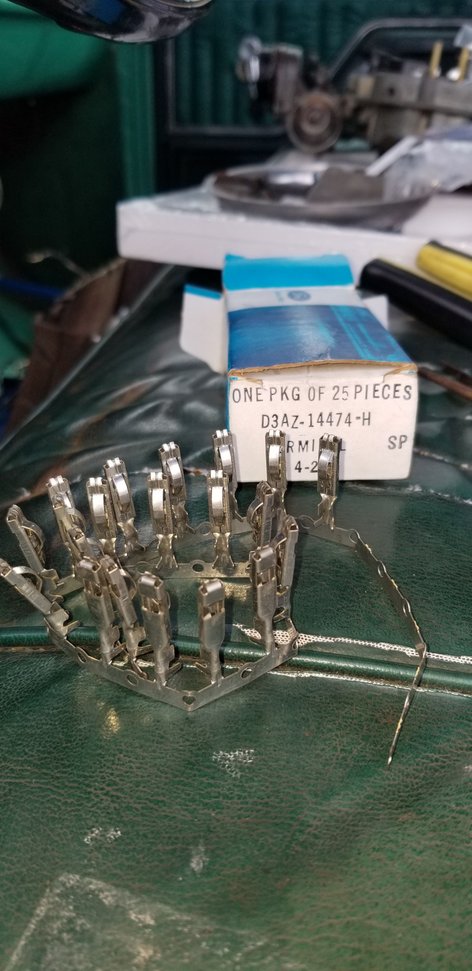

Found some new old stock connectors 25 of them. I even found 3 that were cracked and didnt show signs of the top being separated. I took each out one at a time so I could check if they were compromised.

It seems that there's nothing as good as NOS pieces. Nice find.
