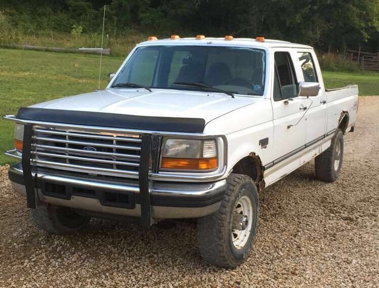

Hey all, just bought a 1996 F250 4x4 with the good ol 7.3. I have saved for a long time to buy a truck like this and I'm broke now that I have it I was wondering what kind of mods can be done for cheap or free.
Any responses are appreciated, thanks!
