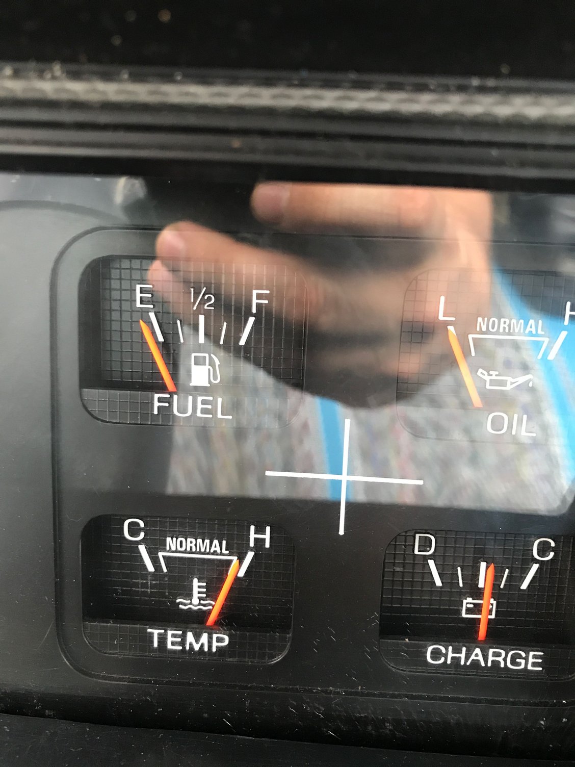

good point. Here are the readings from today when it was supposedly overheating. As was previously suggested, this time I included a reading from the lower radiator hose. In a little while I'll drive it up to the gas station to fill it up and take the same readings when it's showing the normal vertical straight up in the middle of the guage.
200° on the heater core hose
217° on the thermostat housing
187° on the upper radiator hose
148° on the lower radiator hose
This is what the heater gauge showed while I was taking those readings
