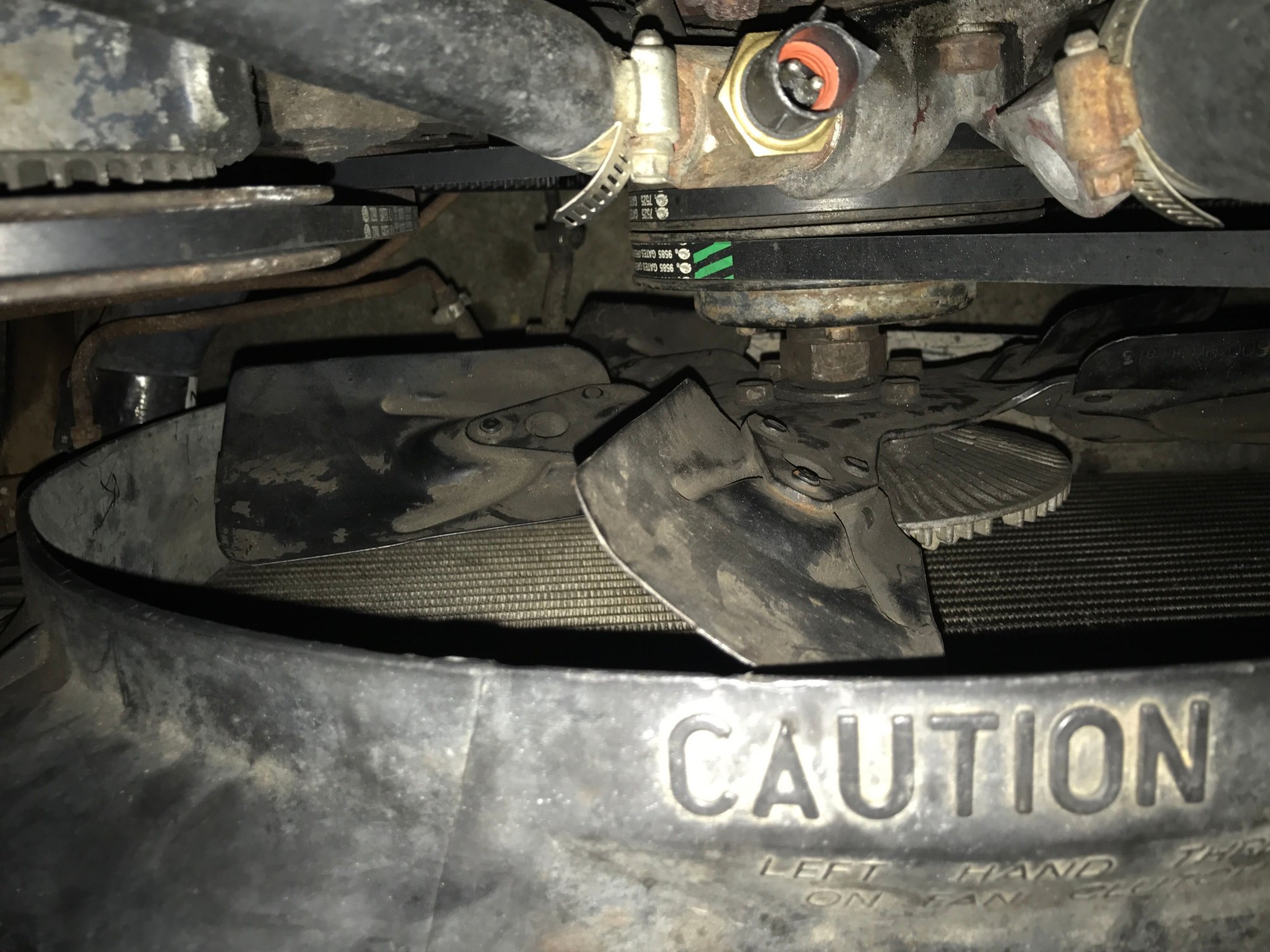

2) Is the fan supposed to completely stop when it's cool? I've never seen my fan not spinning when the engine is running. I didn't even know it had a clutch. I'll check in he morning, but I'd bet real money fan starts spinning the second I crank the motor in the morning.
heres a tip down pic of my fan blades:
3) The fan may or man not be crappy, but the problem happens at highway speeds, so it's either not the fan, or at the very least not just the fan.
Okay, phew, the orientation of the fan blades is correct. Must have been the camera angle in the earlier picture. Thought I was on to something. Was getting ready to pat myself on the back, too.
Re: The fan clutch operation. They never lock up 100% or release 100%. The fan always spins.
When cold, the clutch deliberately slips quite a bit because it takes energy to spin the fan. Slippage reduces noise, power consumption, and improves fuel economy while still moving some air.
When hot, the clutch slips way less, moving a lot more air, at the expense of fuel economy. I know it seems weird that you'd still want some slippage, but that's the intent. One advantage is slowing down the RPM of the fan. If locked 100% at high engine speed, the fan would not move air as efficiently through the radiator. You'd end up with a spinning mass of turbulent air that actually reduces airflow through the radiator, the only place it counts. Nice smooth airflow is what you want, not a tornado. The fan works best within a certain speed range, and deliberate clutch slippage is part of the equation.

The fan will always spin. But when the engine is cool the clutch allows the fan blades to "slip" (you can't see this by eye). That is why I suggested you feel the drag trying to turn blades when engine is cold and comparing to fan drag when engine is hot. Or you can use the timing light method to see the amount of slippage.

I spun the fan before I started the truck this morning and a regular flick of the wrist gave about 1/4 rotation. Putting a little mustard on it only increases it to about 1/2 a rotation. Drove to work without the AC so when I showed up the temperature gage was straight up and down where it normally sits. Turned it off and immediately opened the hood and spun the fan. I didn't notice any difference at all. Got the same results as when it was cold.

Those fan clutches are inexpensive - if it were me, I would get a new one to be sure. They are under $30,
Note that there is a different fan clutch for A/C and non-A/C engines.

I may have misled you talking about the engine being cold or warm, and how that affects the fan clutch. It's more like the clutch has two modes, but the switchover point isn't cold versus warm. The two modes are normal temperature and above normal temperature.
Your truck was operating in the normal temperature range for your drive to work. That includes starting out cold and so on. Spinning the blades by hand as you described sounds perfectly normal.
If your truck started running above normal temperature (for any reason), there will be a point when the fan clutch switches over to draw more air. Sounds like you were never in that range this morning.
Don't forget my previous comments (post #73) that the clutch has to sense that hotter air leaving the radiator before it will switch over.
