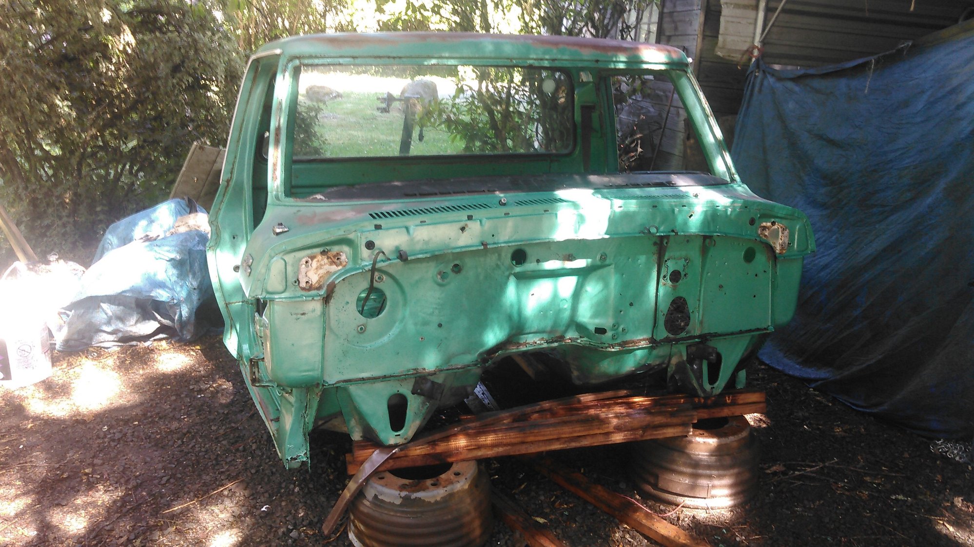

Well I have been threatening for a long time to replace my rusty cab on my 73 scs. After giving my step son my first replacement cab with stipulations that has yet to touch. I found this 78 cab for 50 bucks. Overall it is in good shape except for the right floor pan. Looks like the heater core leaked for a long time. And I found some pin holes on the left rear cab corner. And a small dent. I have a parts cab with perfect floors and cab corners so that's all free but my time too cut out. So if I decide to take tomorrow off work I'll start the repairs. My plan is to fix the cab corner floor pan and any thin metal I find. Replace all seals. Paint the inside to match my existing cab and have back together by September. So enough rambling here is some before pics of the new cab. I'll post more pics as I go.
The rusty floor pan. Going to take it out on top of the transmission tunnel ans across under the seat are
The good side

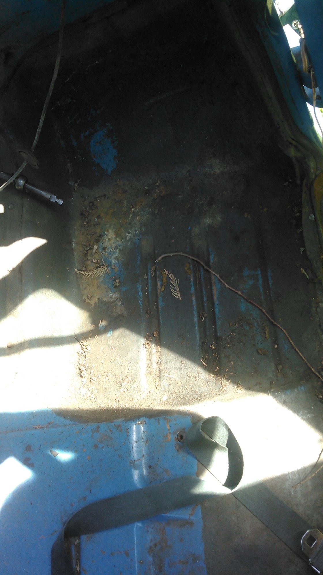

Parts cab right floor pan
Going to use a piece of this left side where the tank selector valve mounts. Replacement cab little bit thin there

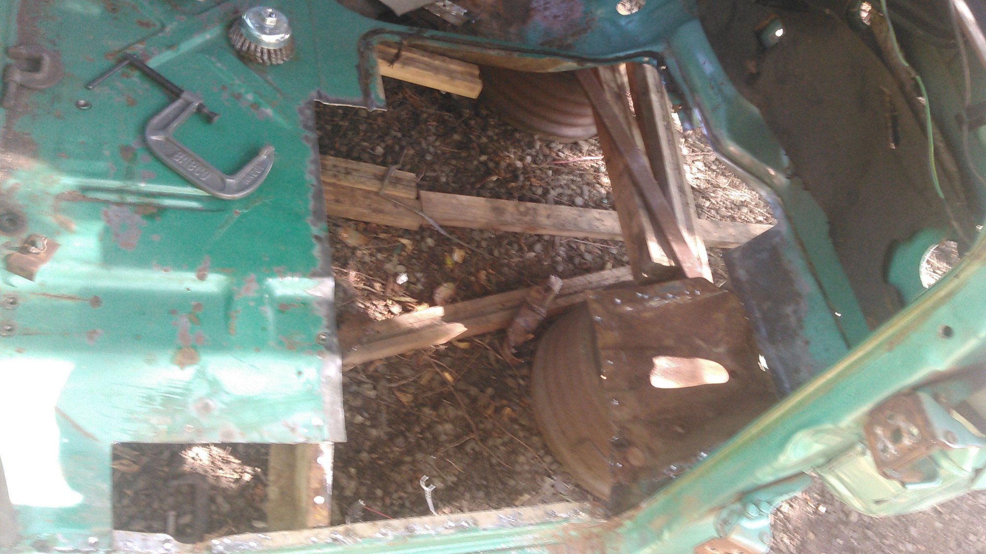

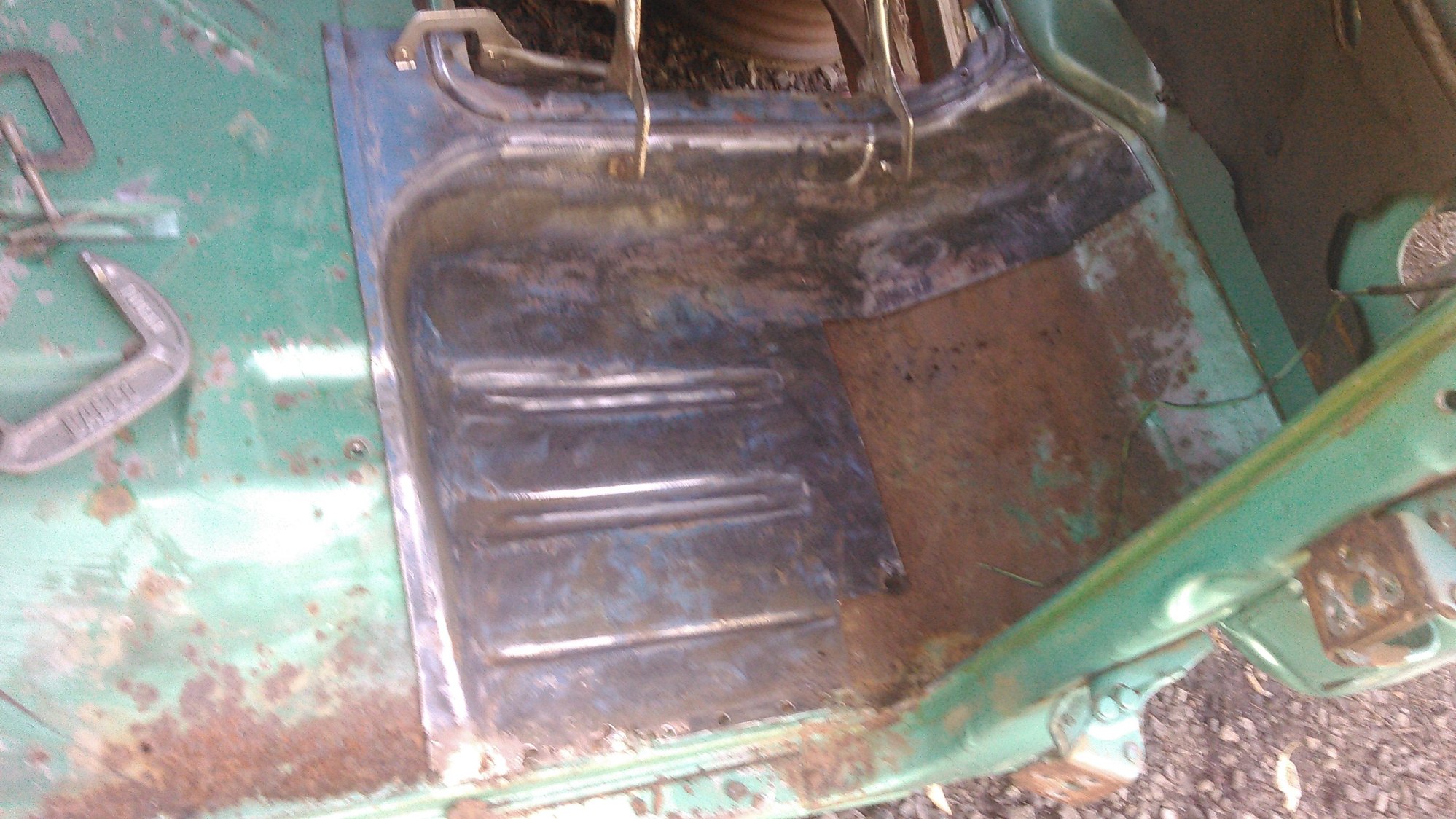

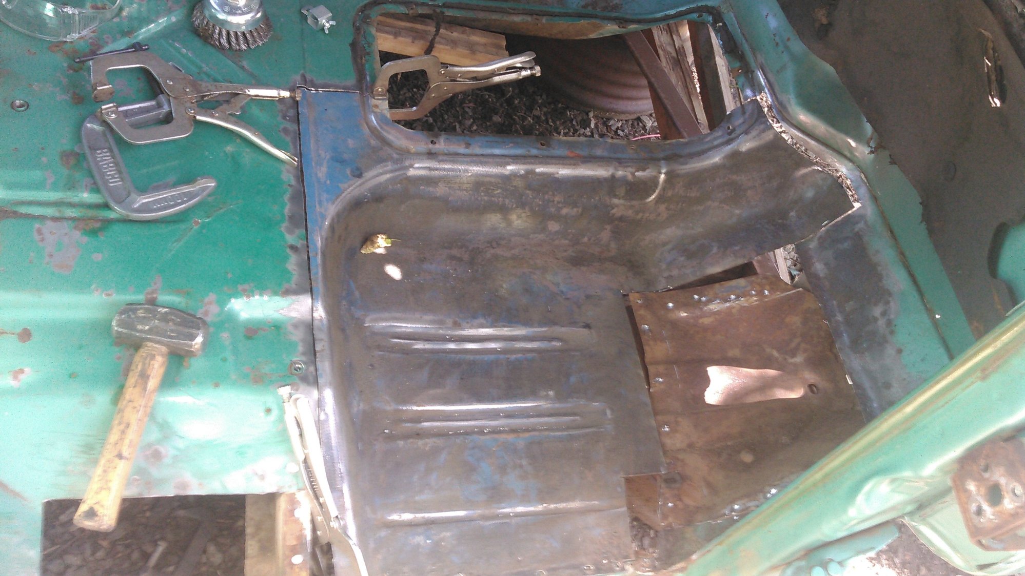

Got some work done today. Cut floor pan out of the parts truck. For it in the new cab , more fitting to do but should be able too weld tomorrow would tonight but I coated all the rust with rust killer going too let it cure tonight. Here's some pics Big a@& hole.Figured get all the thin metal
Setting replacement in for cutting
Test fittings

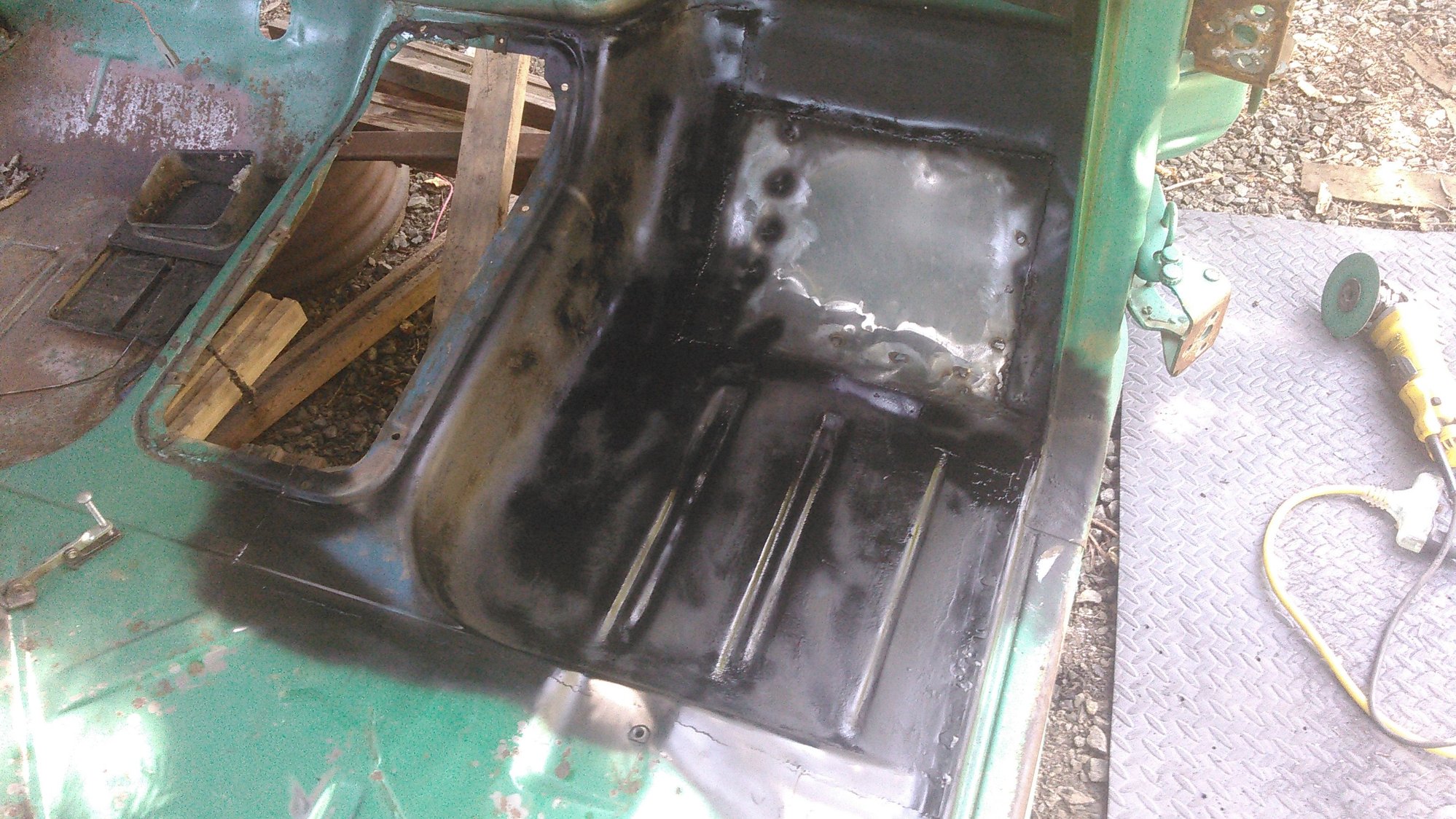

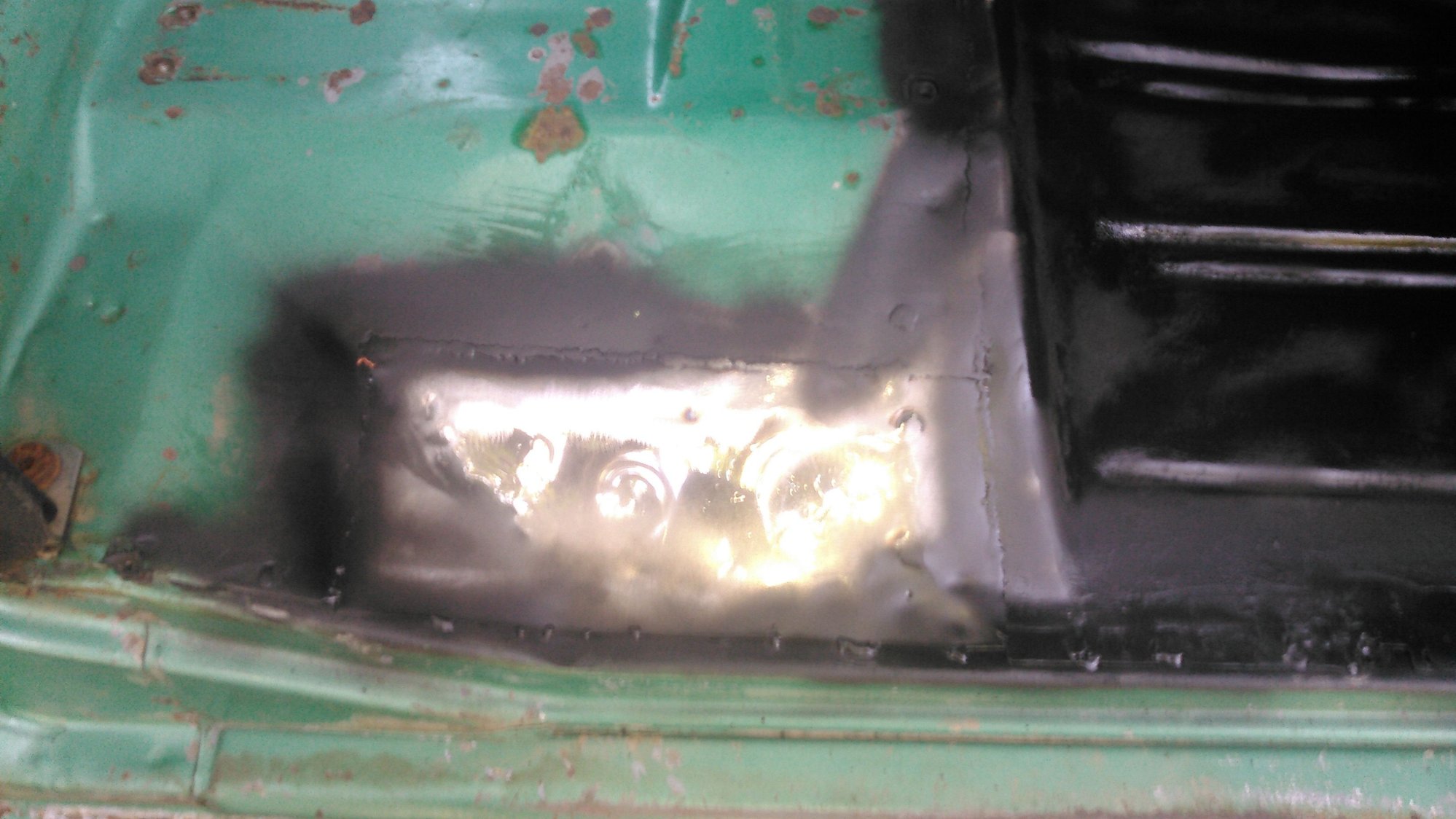

I got the passenger side floors welded in today.I used 16 gauge stainless steel for the patches I had to make. Let those areas rust out again lol. Only reason I used it is because I had it laying around. I didn't grind the welds perfect flat figure why since I'm covering it it sound deadner mat and carpet. I will flip the cab on it's back so I can grind the under side and paint. Here is some pics
