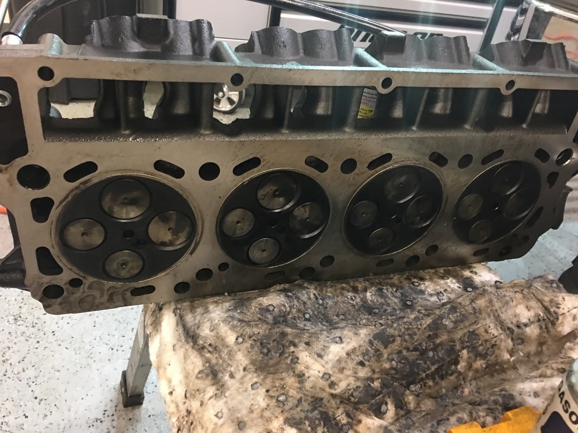

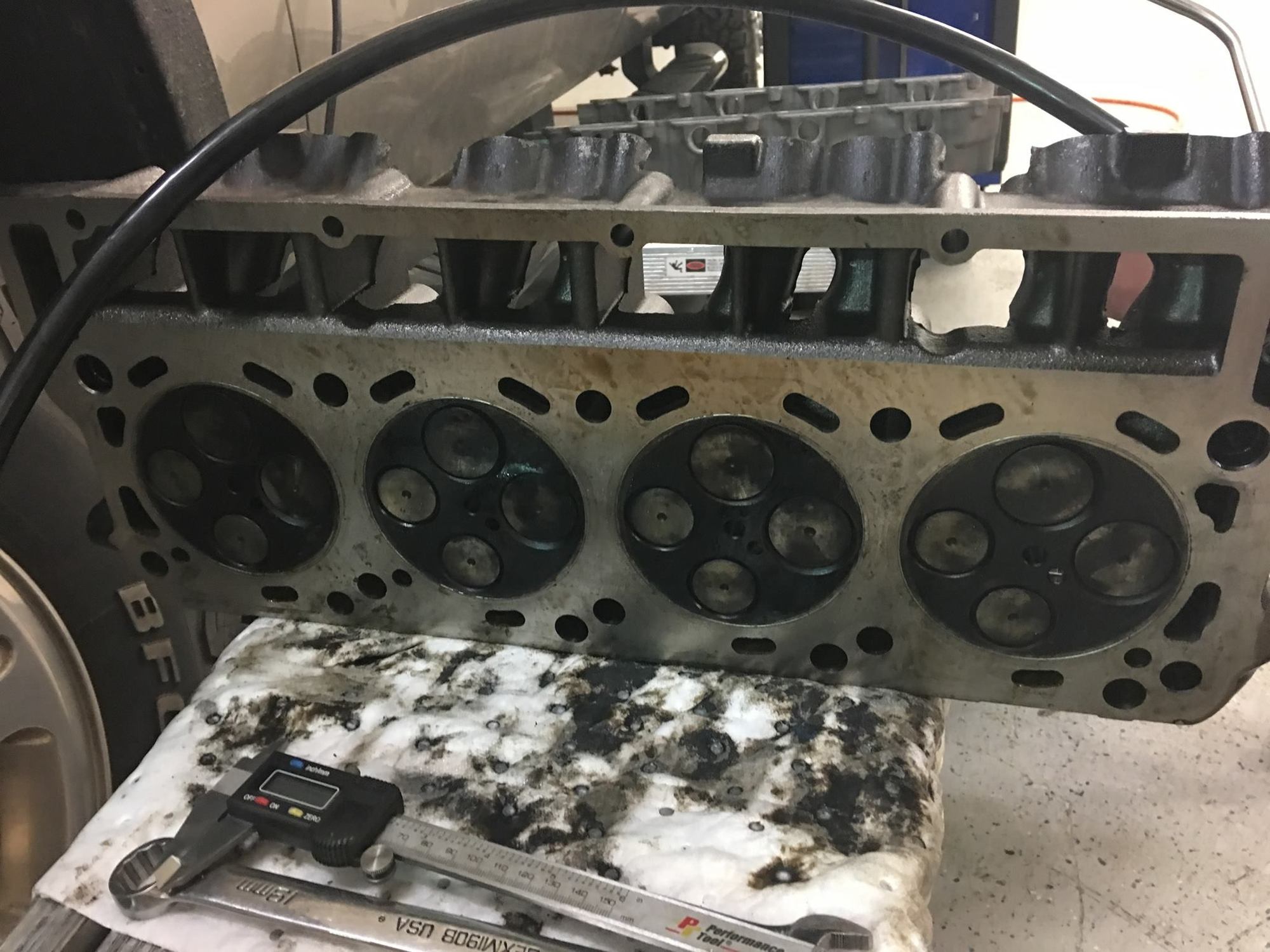

Update
Update on this. They pulled the heads and there are no signs on head gasket leak. Heads were pressure tested good. I looked at the head gaskets too and there were zero signs of a leak. There is no way it was EGR cooler because the back of the EGR cooler wasn't even plugged. If there was a rupture it would have been pushing coolant out the back of the EGR cooler. He's putting it back together this week with the coolant return kit, regulated fuel return, and I got the Odawg ported intake manifold for it too.
