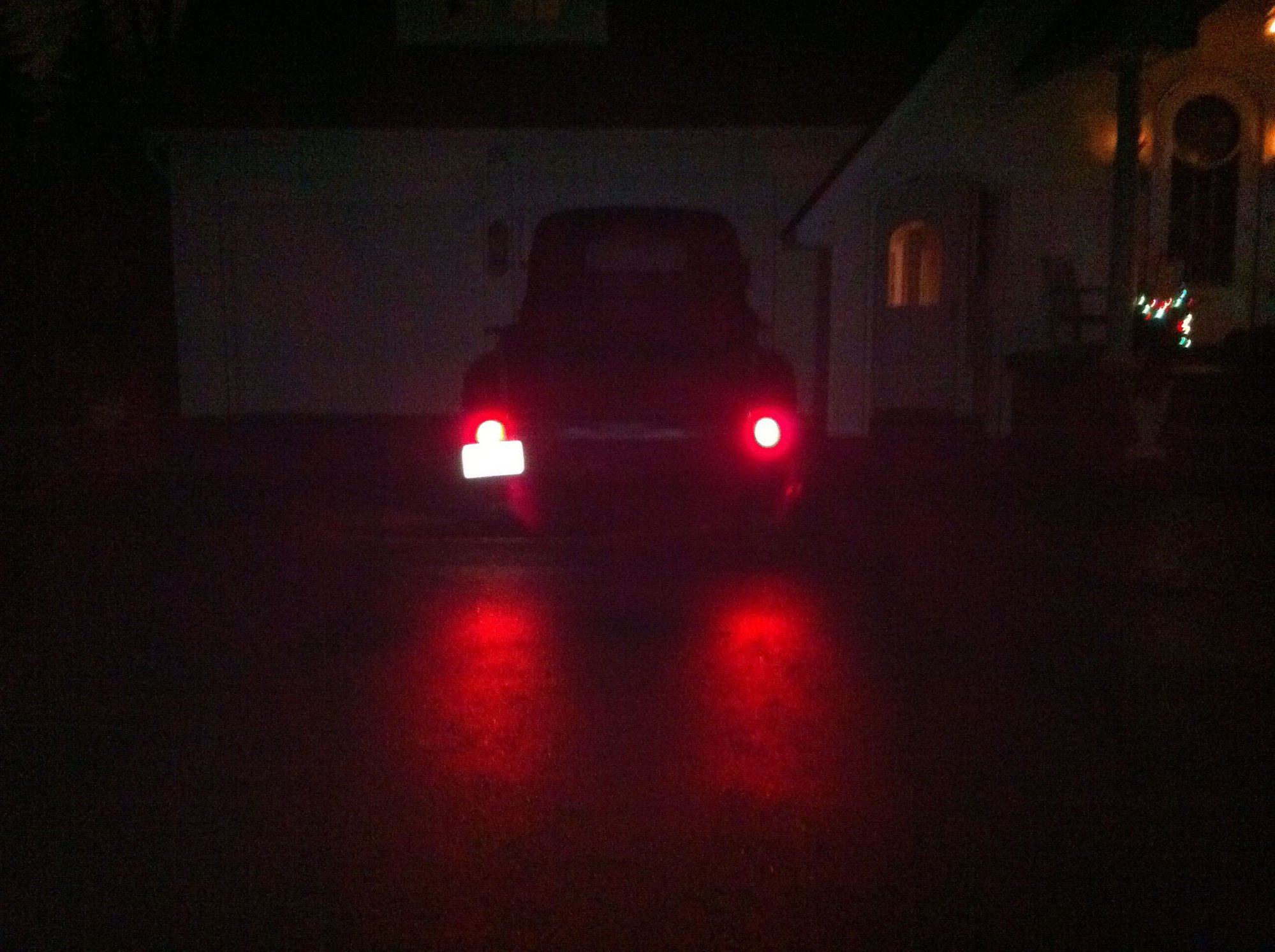

All the OEMs didn't switch to 12v negative ground because there were no significant benefits. 12v gives you access to modern electrical/electronic components including improved lighting of many types mounted in your stock light fixtures. One of the most important of these is the itty bitty tail lights. LEDs make a big difference.
