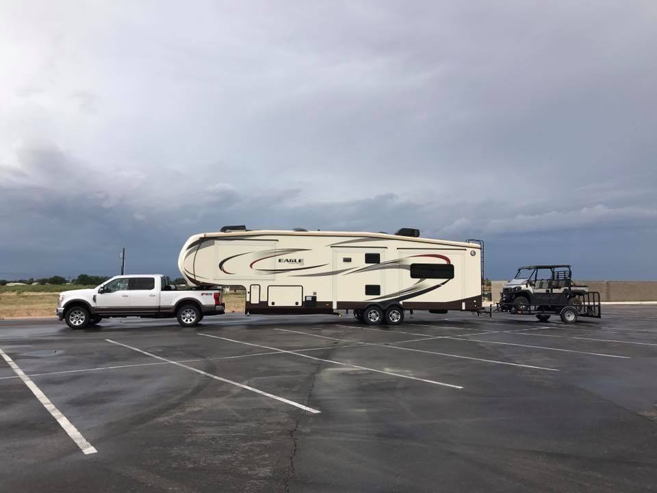

The 350 srw should handle that fiver just fine. Keep in mind not all fifth wheels are designed the same which means they all range between 15-20% on the hitch. That being said, 2500-2800 is about the most I'd want on the hitch with a srw 350. Consequently your truck will weigh in around 8900lbs with fuel and two adults/gear. 11500-8900 = 2600 .... if your 350 srw is like mine the axle ratings are 7230 on rear, and 5200 on front for a total of 12430. 12430-11500 = 930... so there is a buffer there ratings wise.
Here is my setup, 2015 Jayco 361reqs, with a 6x14 trailer for the Mule Pro FXT.

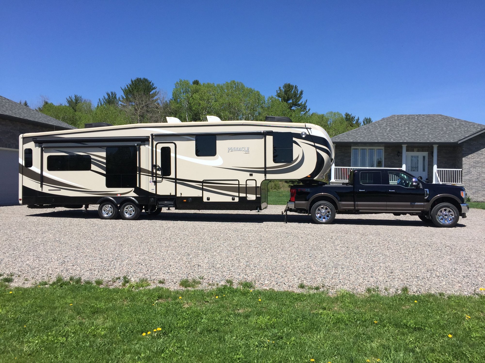

This is what I pull (2015 Jayco Pinnacle 36REQS with 2410# dry hitch weight spec and 14,000# leaving the factory) and I don't even feel that trailer back there with the 350 compared to my old 250 (which was a relaxed towing ride to begin with). My 250 was on air bags which made it ride better but the power wasn't there compared to the 6.7 and the new truck does not have any sway in the corners as well as a firm footprint on the road with a crosswind or passing traffic. I had a 35' bumper pull before this and there is no way I am ever going back, I hated pulling it in the wind or passing transports as the truck would be all over the lane. I will never forget my last trip with it on my way to get my 5er, there was 2 days of crazy high winds and when I hitched onto my Pinnacle it was as relaxed pulling it home as driving the truck without a trailer. I have no doubt a DRW would be night and day difference again like what I felt from my 250 to 350 but for me the 350 SRW tows my trailer very well and I do not ever get a regret where I should have bought more truck. I have absolutely no desire to get a DRW either as that brings a whole new level of headaches when driving it the rest of the time without the trailer in tow or when trying to get into the lots of our campgrounds which can already be a real treat with a short box SRW
