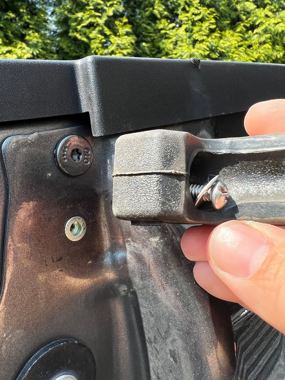

I ended up tapping the existing holes in the bed with a 5/16-24 tap and replacing the plastic push pins with 5/16-24 x 3/4" 316SS button head socket cap screws and 316 flat washers installed with blue Loctite. I'm not losing those bumpers again.

Never realized how common this issue is until it happened to all three of my trucks. I’ll keep this old thread going and add to TB250’s solution with my method; Drill out the hole to 5/16”s and put either a 10-24 or 1/4”-20 Threaded insert (nutsert) and matching 3/4” screw with washer in there and be done with it forever. I used all aluminum hardware to prevent dissimilar metals from touching but I assume if you use zinc coated hardware you’ll still outlast the truck.

Nutsert installation
This video was very helpful for nutsert installation tips:
"How to install rivnut, rivet nuts or nutserts, with no expensive tools"

I finally got smart and bought a hex head screw with coarse threads
5/16 by 1 inch long for 35 cents and did a much better repair on my 2021 F350 than I thought possible.
It took me almost 45 seconds to make the repair.
