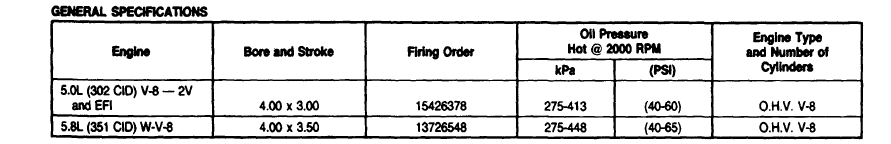

As FF2 and Franklin2 said find TDC on #1 and go from there. If this is the original engine my 1986 manual has the firing order indicated below. (which is the first firing order F2 mentioned) Hope you get it sorted out soon!
