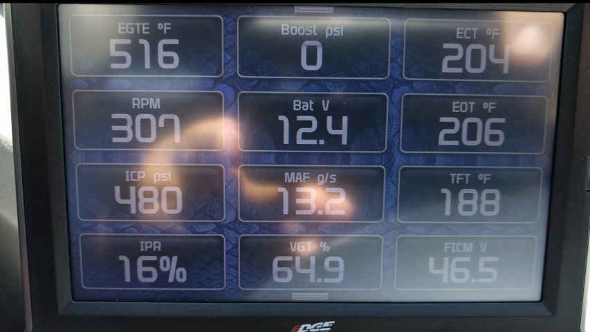

Well I did this again today and it stumbled but didn't stall. at the stumble MAF went down to 13.2 g/s.
Stumble at it's lowest (the refresh rate on the CTS2 isn't perfect)

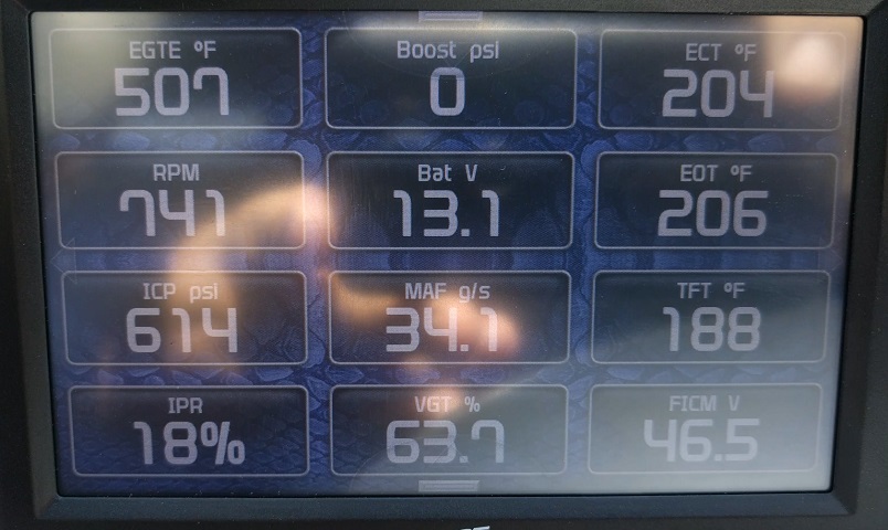

And recovered to idle
Richard

Not exactly sure what to make of the data Richard. I wasn't expecting the ICP to drop that low.
That has me suspecting the IPR.
The other thing that I question is the significant drop in MAF at the same (approximate) commanded VGT%. Related to the drop in EBP I suppose, but boost is 0 in both screen shots.
