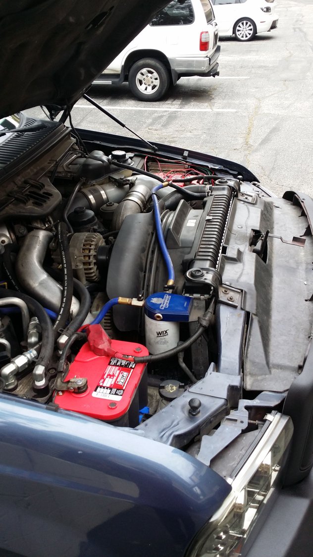

Optima RED tops on sale!
Batteries also are smaller and give more space.
They also came with the blue clamp that makes the bottom part of the battery wider to fit stock brackets.
I live down in southern California. I have a 2004 f350 6.0 turbo diesel. Had original Energizer max battery in my truck from previous owner. Started leaking and needed multiple jump starts. Just picked up 2 Optima red top batteries with connections on the side. 34/ 78. 4Wheel Parts has them on SALE for $181 each. Not sure how long sale will last. Originally and from other stores i priced at $210-$230. What a difference it has made the way truck starts up now. This battery was also recommended from Optima website for my truck. I saw some of you had mentioned the sears brand but called multiple stores said they only sell gold brand now.
