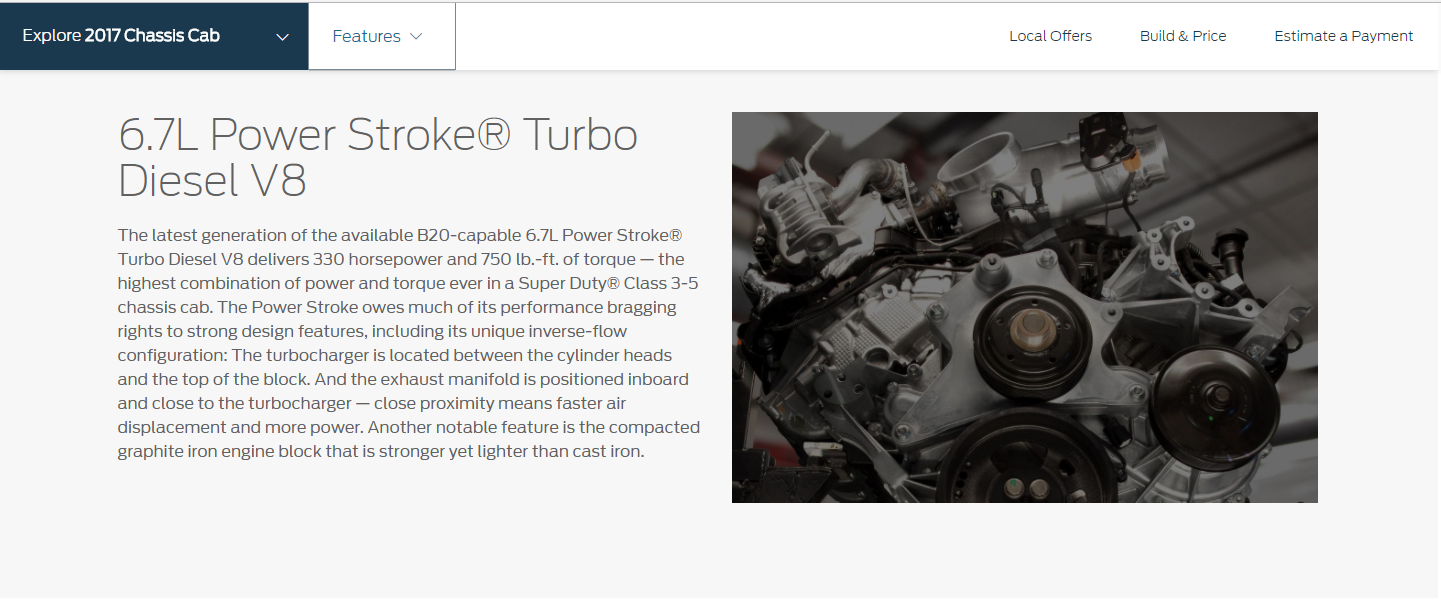

I do not know what the 17s are derated to. 2011 where the Pickups were 400 the chassis were 300 hp.
Old May 19, 2017 | 07:03 PM
BCooke's Avatar
BCooke
Joined: Jul 2010
Posts: 241
aha...
2017 Ford® Super Duty® Chassis Cab Truck F-550 XL | Model Highlights | Ford.com
Old May 19, 2017 | 07:23 PM
Johnpsz's Avatar
Johnpsz
Joined: Feb 2017
Posts: 722
From: Oregon
330 HP and 750 lb/ft torque. Not to mention torque management that doesn't give you full torque in the lower 2 gears...

The 6.7L Power Stroke V8 turbo-diesel in the 2017 Ford Super Duty is rated at 925 lb-ft and 440 hp
Old May 20, 2017 | 11:35 AM
The Ace of Spades's Avatar
The Ace of Spades
Joined: Oct 2016
Posts: 552
Likes: 22
Originally Posted by MagicMtnDan
Huh?
yes it is, but they are talking about the F550, which is the commercial version of the 6.7. Commercial trucks get the derated version for greater engine life.
