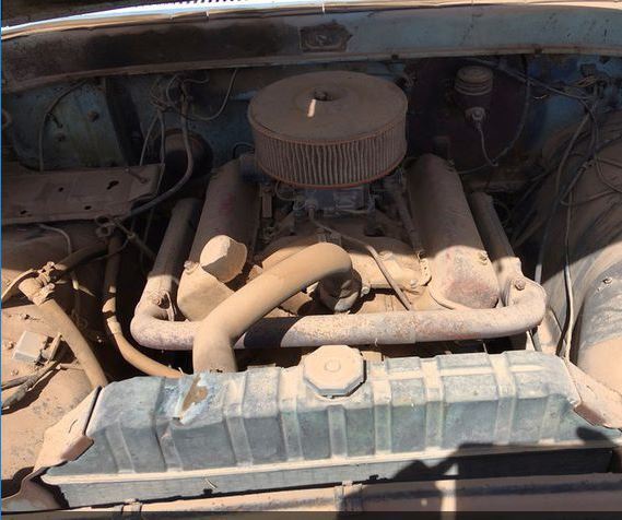

Hey folks,
Looking at a possible truck to buy and curious if anyone knows what kind of V8 this might be with the exhaust connected in front of the motor?

Looks like a Y block.
Should have some numbers and letters cast on the block for positive identification.

That right there is a Y Block

It is a 292 if it is original.
