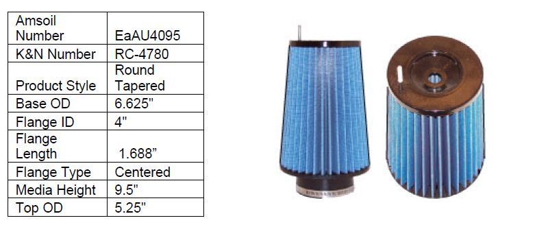

If I elect to go 6637, I am debating between the Donaldson filter (and replace once a year for $40) or the cleanable Amsoil EAAU4095 ($67) which looks a tad bit smaller but has a hole in the end for the factory filter minder and a place to secure to a chosen mounting bracket. Here is the Amsoil...

I drilled a small hole in the elbow of the intake hose (tube) and installed the filter minder there. Now I don't have to deal with it every filter change. If I put the minder in a hole in the end of the filter I'd never see it as the end of the filter sits right at the quarter panel (I don't know if there's enough wire slack to reach that far either).
