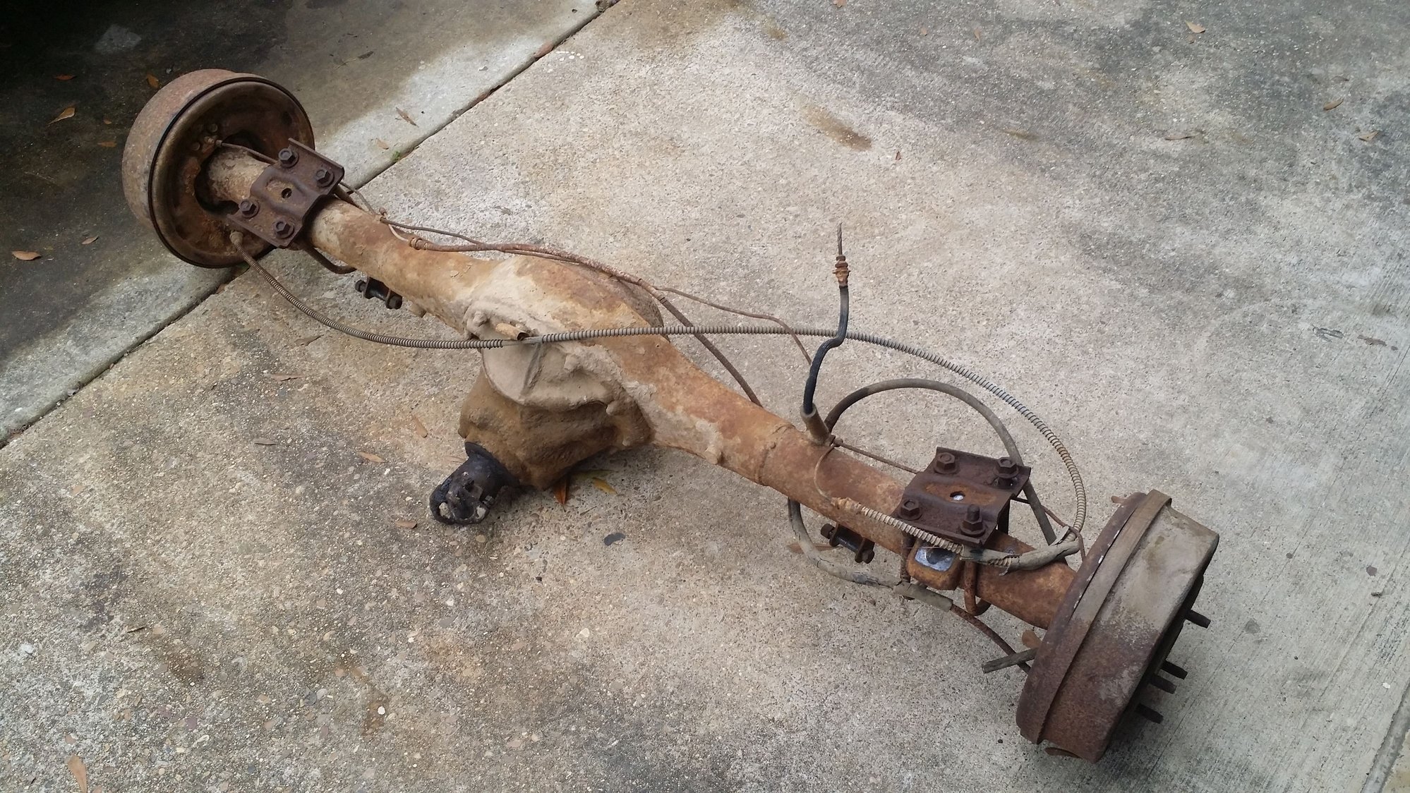

I got this 9-inch rear end from an '81 F150 Bullnose. The gear ratio isn't desirable (2.47:1 open differential, 31-spline). I got it because it has the 'Torino' large axle bearing flanges so I can bolt a set of Explorer rear disc brakes onto it. I already have a Ford 9-inch Daytona N-case 3rd member with a 31-spline Traction-Lok differential and 3.50 gears I can put in it. I got the whole rear end assembly from the wrecking yard for $100.00. I paid $75.00 for the Traction-Lok N-case.
'81 F150 9-inch rear end assembly.

Prices can be all over the place for a 9-inch, depending on who/where you buy it from. Desirable components (31-splines, Traction-Lok, N-case) will obviously make one worth more. You can always ask more than you're actually willing to take and haggle from there.
