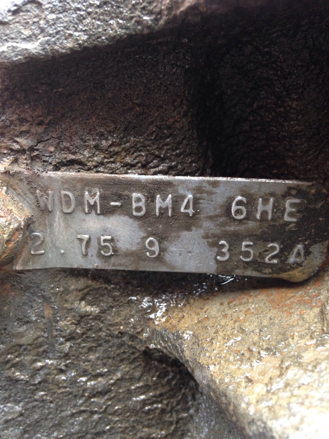

9" Rear End Data Tag
Alright folks, aside from the 2.75 gear ratio and the 9" identifier, what can you tell me about this rear end?

Ford 9" non-locking 2.75 ratio, 28 spline axles, made the 5th week of August 1976.

The WDM-BM4 also references back to 28-spline axles.
