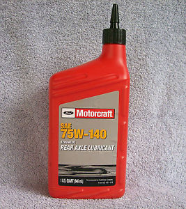

I used this stuff thinking it had FM in it however even this Motorcraft Syn needs FM ( XL-3) added to it.
I'm going to try half a bottle of FM (XL-3) first.
