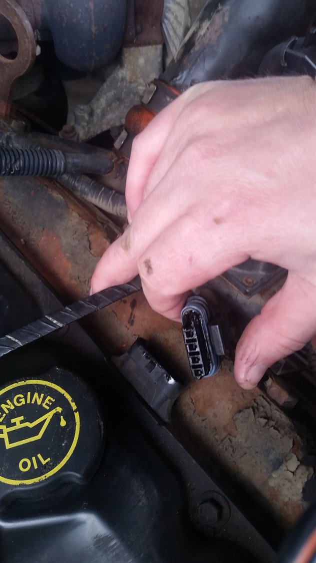

Think I found the problem
Knotty: 185k miles

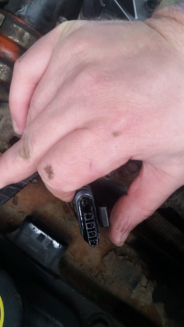

I went to check the glow plug, pull the connector off the passenger bank front and it's covered in oil and the connector looks burnt....
this is the forward connector front:
Passenger front
Close up on passenger forward connector

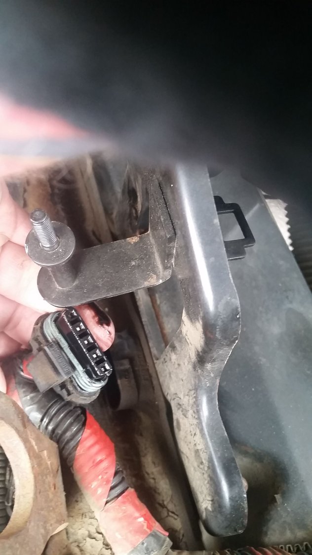

and this is the passenger rear connector, it's got the pin but peace of the corrector broke....

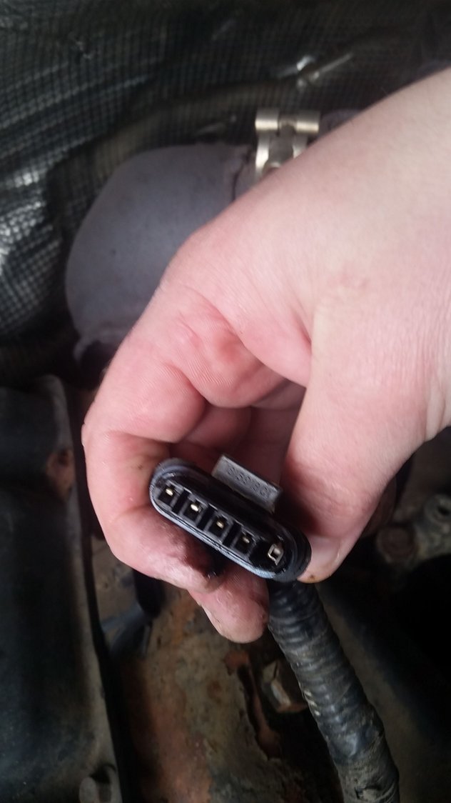

Drivers front, Connector looks fine but covered in oil....

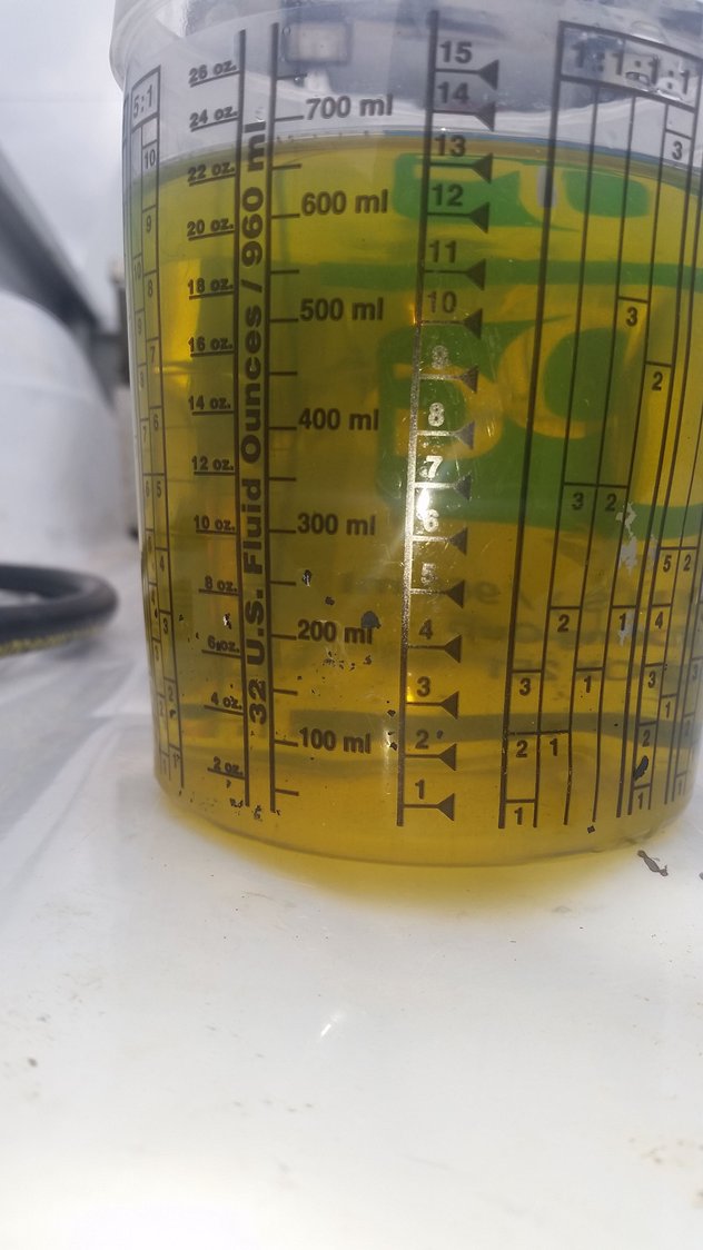

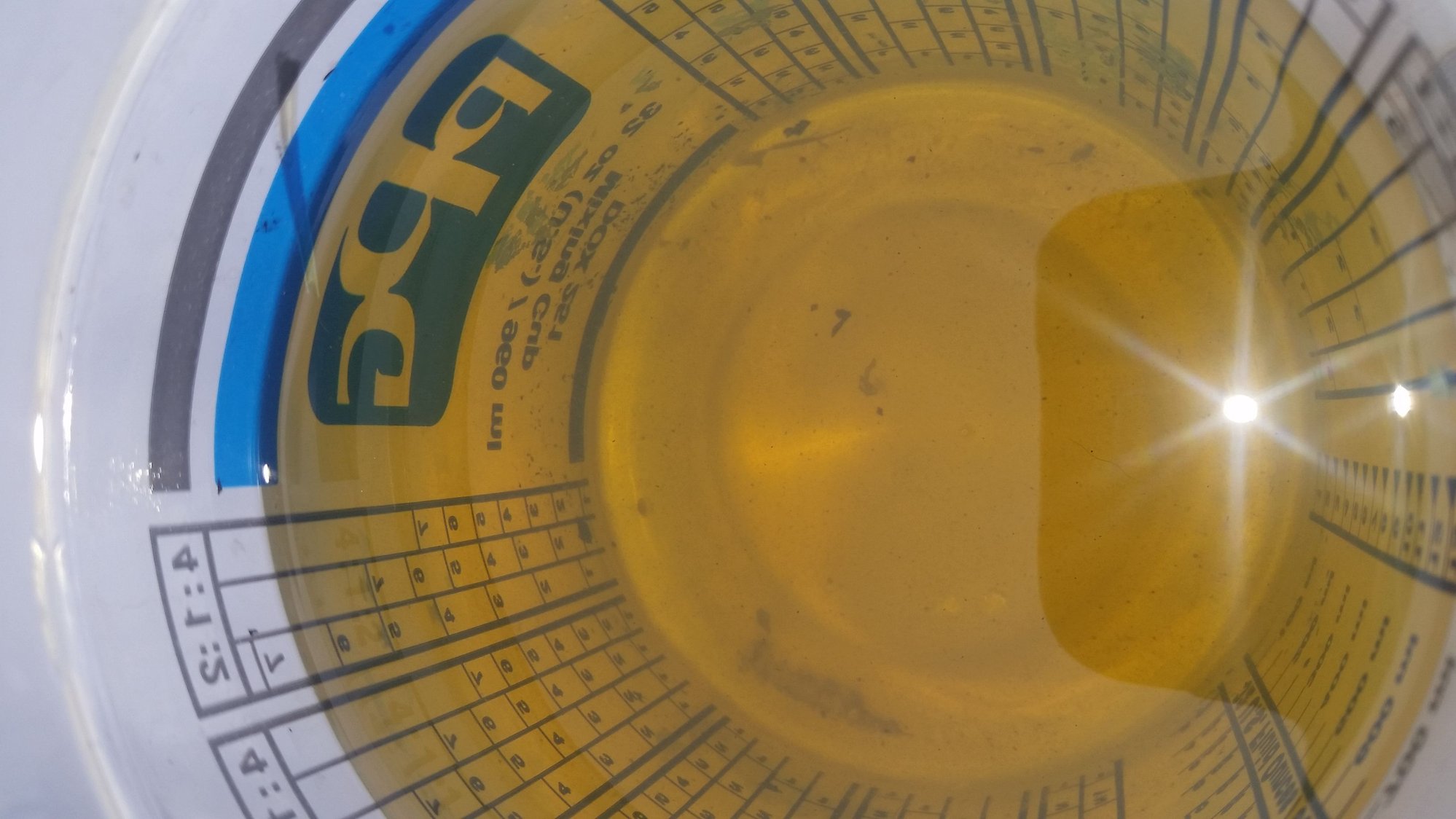

Here is another kind of side subject but I was doing some reading and wondering if my o rings for injectors were going, so I dumped the bi-pass from the fuel filter bowl and collected it......Idk what to say about it.....it really has no smell and kinda gel like......anything to be concerned with?
So what is a corrective action here? Do I have to buy a whole new harness? Where to buy? I'll get some contact cleaner and still try to ohm out the plugs... thanks so far on the right track!

your fuel looks fine, what does the fuel filter look like?
