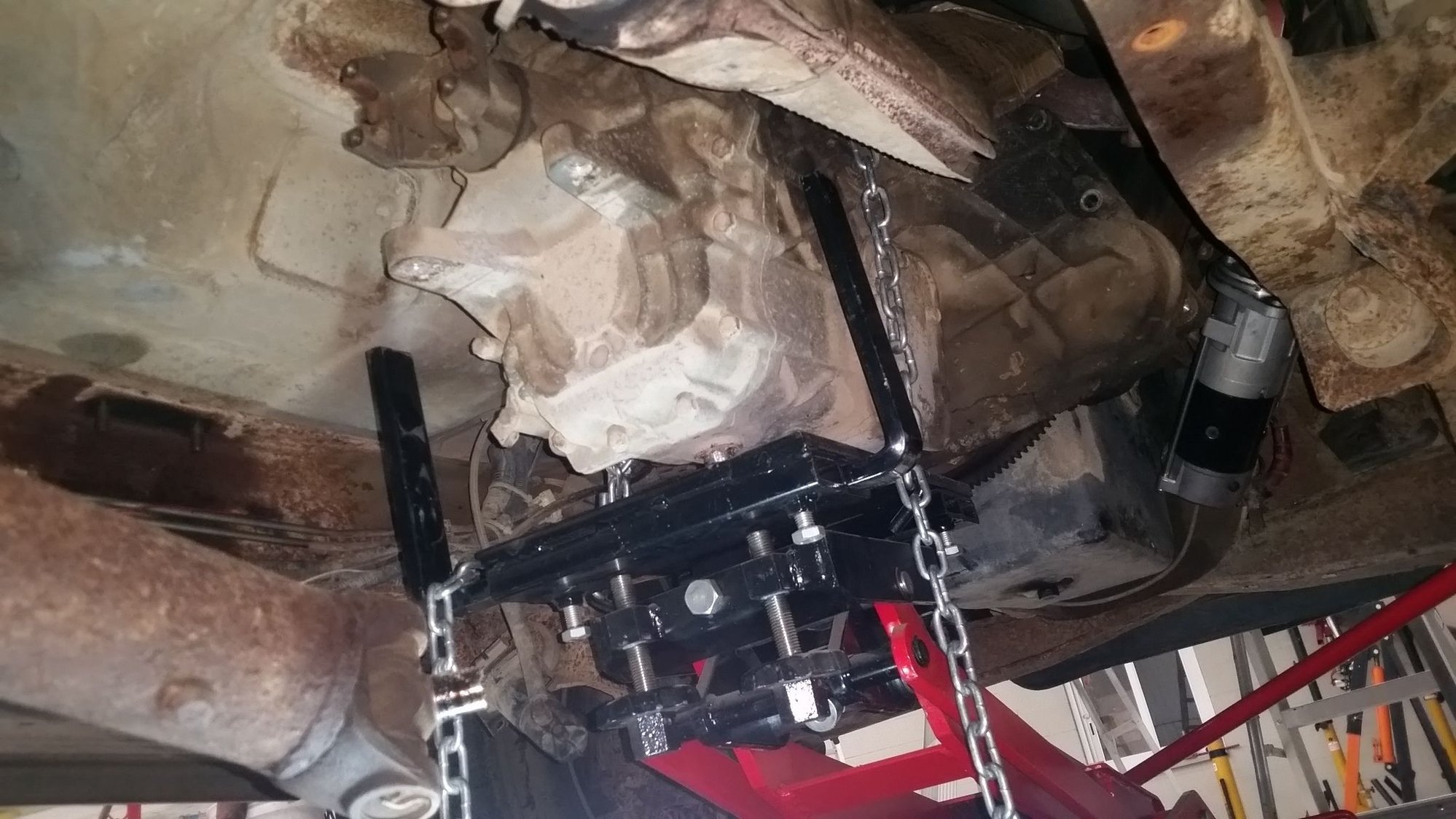

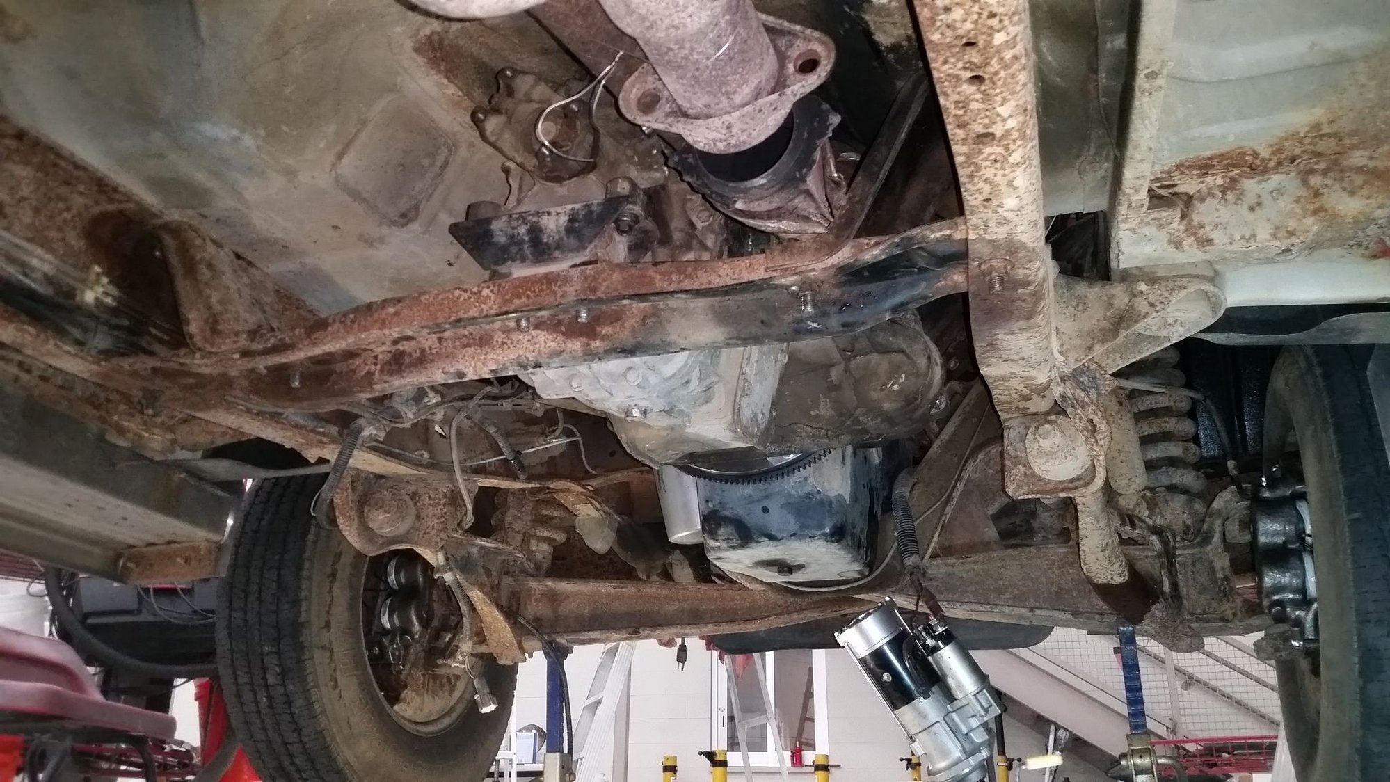

Idk what's going on but I can't separate the tranny from the engine. I took a total of 6 bolts but it won't release the tranny.... what's going on

I'm pretty sure that's a ZF5 but I'll ask anyways, is it auto or manual?
If it's auto, you have to take the bolts off the flexplate to torque converter before you can take the transmission off.
If it's manual, there are only 6 bolts like you took off. Forgive me if you've already mentioned this, but you want to make sure to take the shift lever off the top of the transmission as well.
Another this is, make sure the transmission isn't getting stuck against the downpipe. You may want to loosen the downpipe to turbo clamp so there is some wiggle room between the bellhousing and pipe. Otherwise, it may be slightly seized up on the input shaft to clutch/flywheel or the bellhousing dowels. Some light tapping may get it loose.

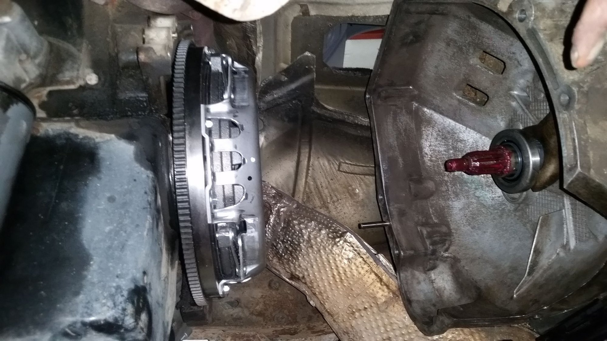

It's a manual. Shift lever is off. This tranny is really stuck on the engine.....it's moving the whole engine as I slightly rise and lower the tranny....I don't understand here.... This does still have the duel mass fly wheel still installed... I'm wondering if there is something there I am missing??
No clue whats going on, but I can't get these two to separate....

Stuck on the alignment pins I bet. I had a granny once that was a bear to separate on a 302 in a Cougar Had to move it side to side about 15 minutes then place a wedge in once it moved a lil. I blame the road salt here for it.

I have had to use a large screw driver or a small pry bar to get them unstuck from the pins. one on left and one on right. When going back in be sure grease the pins.

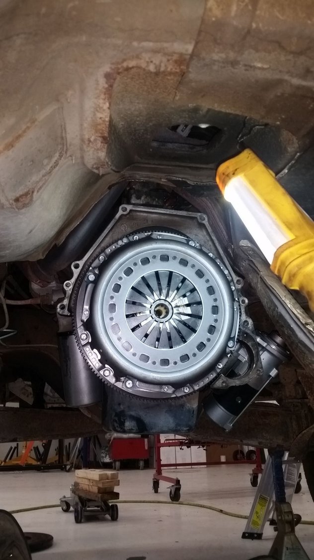

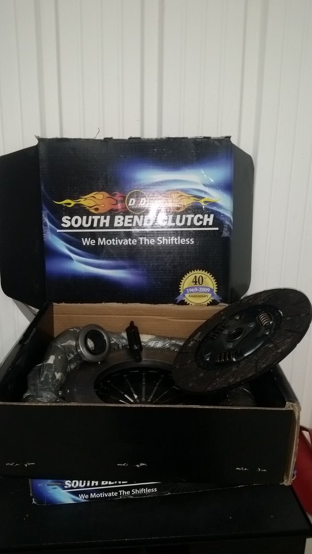

So clutch is changed, installed new clutch slave cylinder.....omg that was a pain in the butt to bleed!!

I love new parts

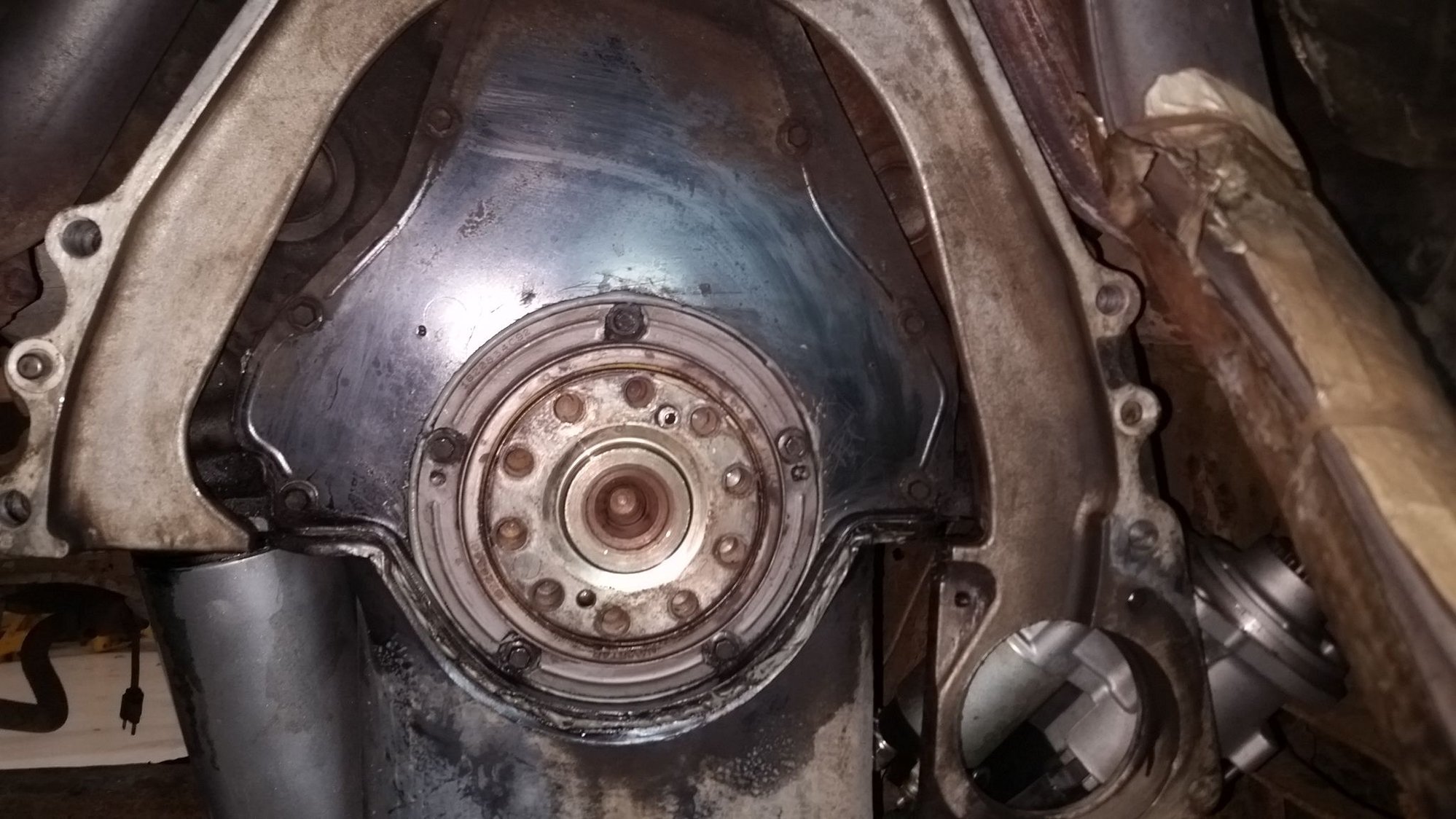

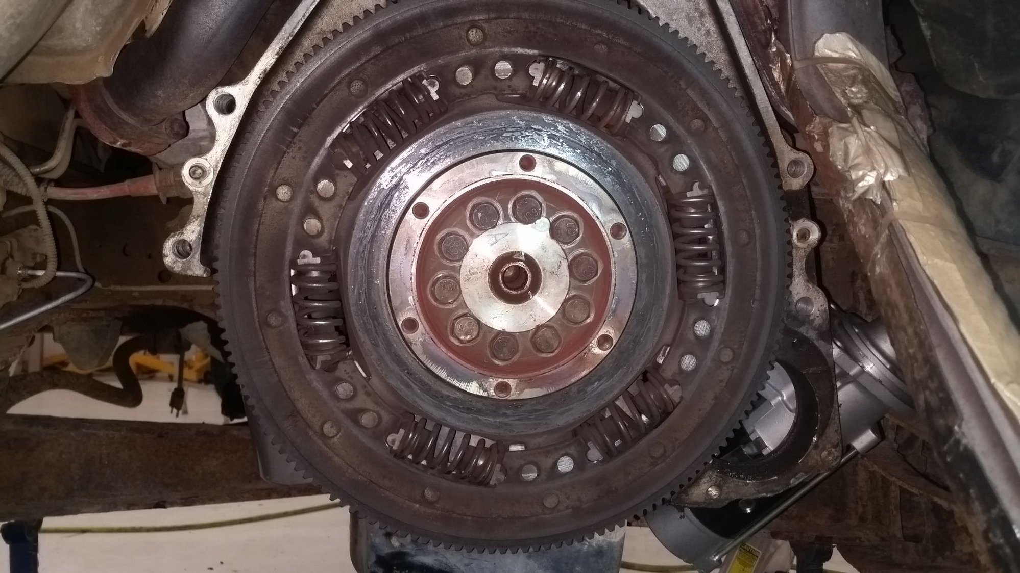

Friction plate off the DMF
The springs on the DMF were very loose abd had lots of play
Look where i am pointing, also take a closer look, the rivets are shaved off.
All clean!
New clutch!
