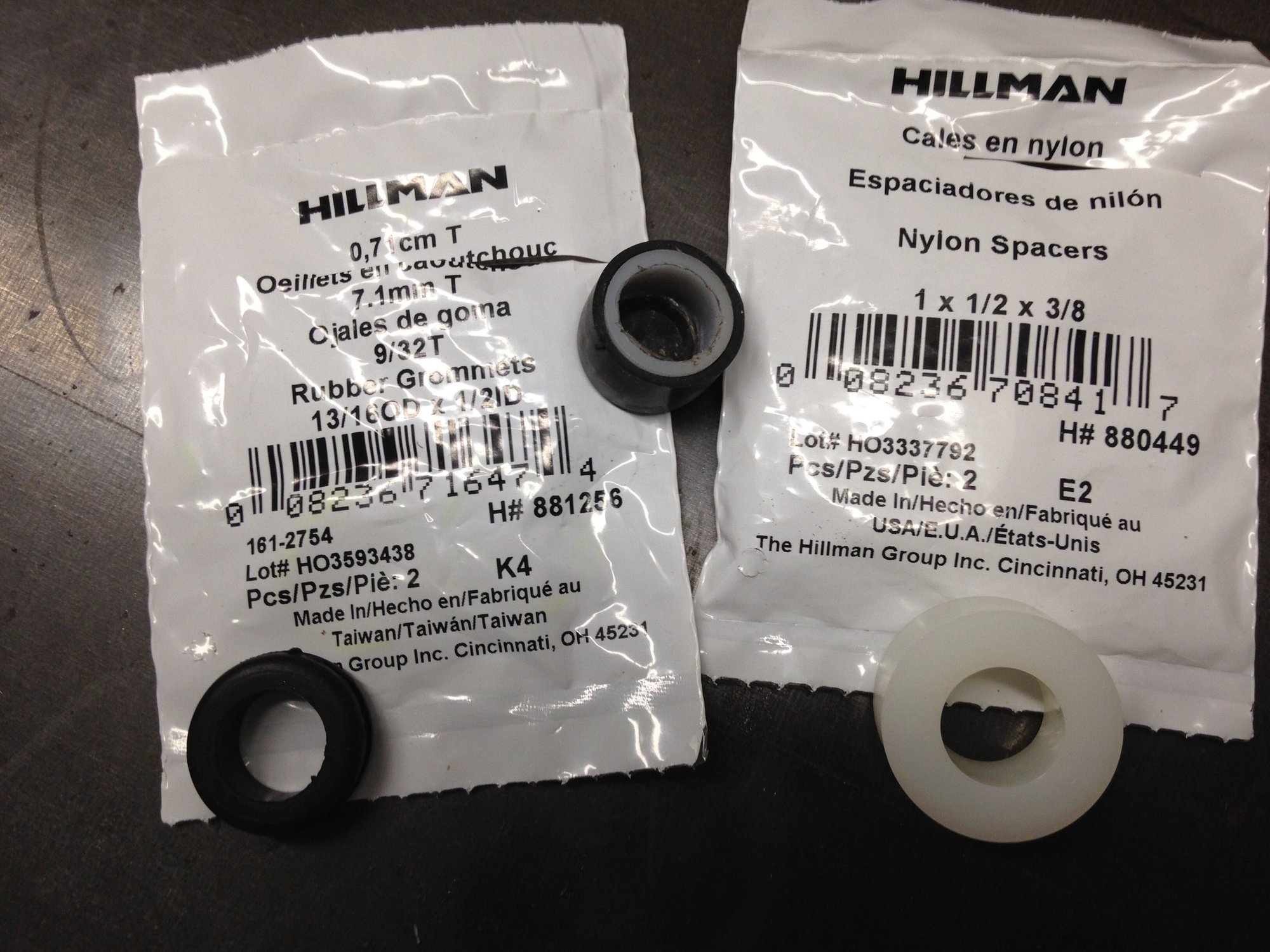

Yesterday I put a mic on that metal pin in my pic. Measured .4935" I found a nylon bushing in my bag of tricks. 1/2" thick, 5/8" OD but only a 1/4" hole. Progressively worked my way up to a 27/64" bit (.421875"). Thought that might be enough to slide over the metal pin . . Nope! Figured I needed to soften the bushing up a bit, so placed in a pot of boiling water for an hour thinking it might add some elasticity and I'd be able to slide it right on . . . Strike two!! Nylon doesn't seem to get much more pliable with heat.
Thought about reaming out the center a bit so out came my Dremel with a rasp bit. Worked it out to .4775" thinking it should go on now!
Strike three!
Finally realized that even if I got it to slide on, I'm still only picking up a 1/6 th of an inch in diameter, so looking for something that maybe has an OD of .75" or so and I'll try again.
Stay tuned.

I decided to get back into fiddling around with the stop pin bumper bushing the other day by digging around in the Hillman drawers at Lowes. I found three things that looked promising.
On the left is a rubber grommet with an O.D. Of .75 thinking that having a soft bumper might not be a bad thing. On the right is a nylon bushing that is big enough to shape as needed and in the middle is the bushing that I was playing around with the other day. I found a black pipe cap that fit snugly over the nylon bushing and gave me an O.D. Of .75. Pressed this setup over the metal pin on the regulator and tried the window a few times.
Now I'm not going to claim that it's fixed for good but it certainly is fixed for now!
I'll be back later when/ if it fails
