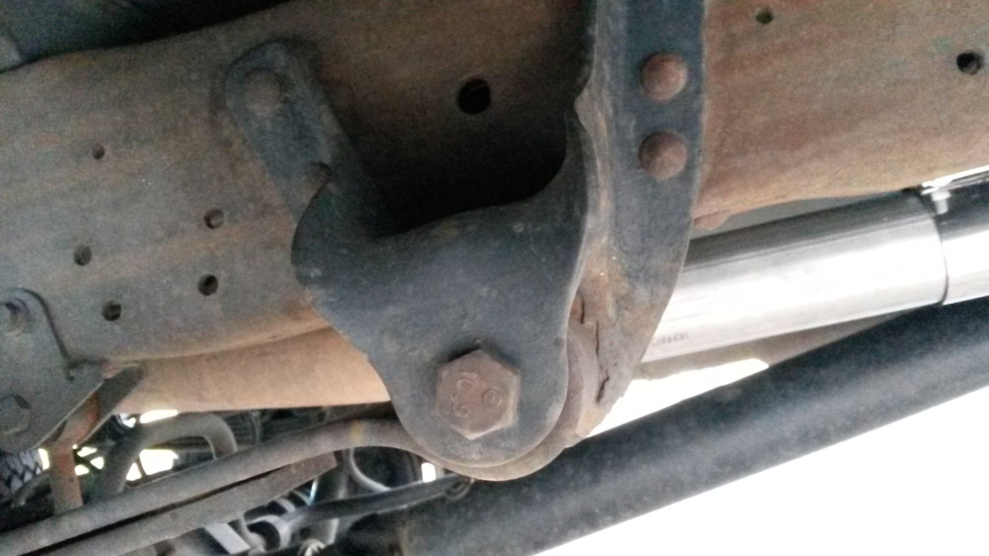

So yesterday I discovered that the rear spring hangars and shackles on my 96 F250 are badly rusted. This was really a surprise to me...I know it's a problem in the rust belt, but I live in an arid climate and the rest of the truck is rust free. In 15 years as a Ford parts guy I don't recall ever selling any of these.
Anyway, to replace them, just grind off the rivets and replace with grade 8 bolts? Anybody know what size bolts? Any tips or tricks for replacing them?
Also, are aftermarket hangars from LMC or anybody a good way to go or should I get OEM ones?

They don't look too bad. Could prob clean em up/paint and get some more miles out of them. Yes, drill/grind rivets and bolt the new ones on. Can't rem bolt size,either 7/16" or 1/2".

I don't see anything wrong with those hangers.
Why bother thinking about them at all?

Badly rusted? Man I wish my hangers looked like those.

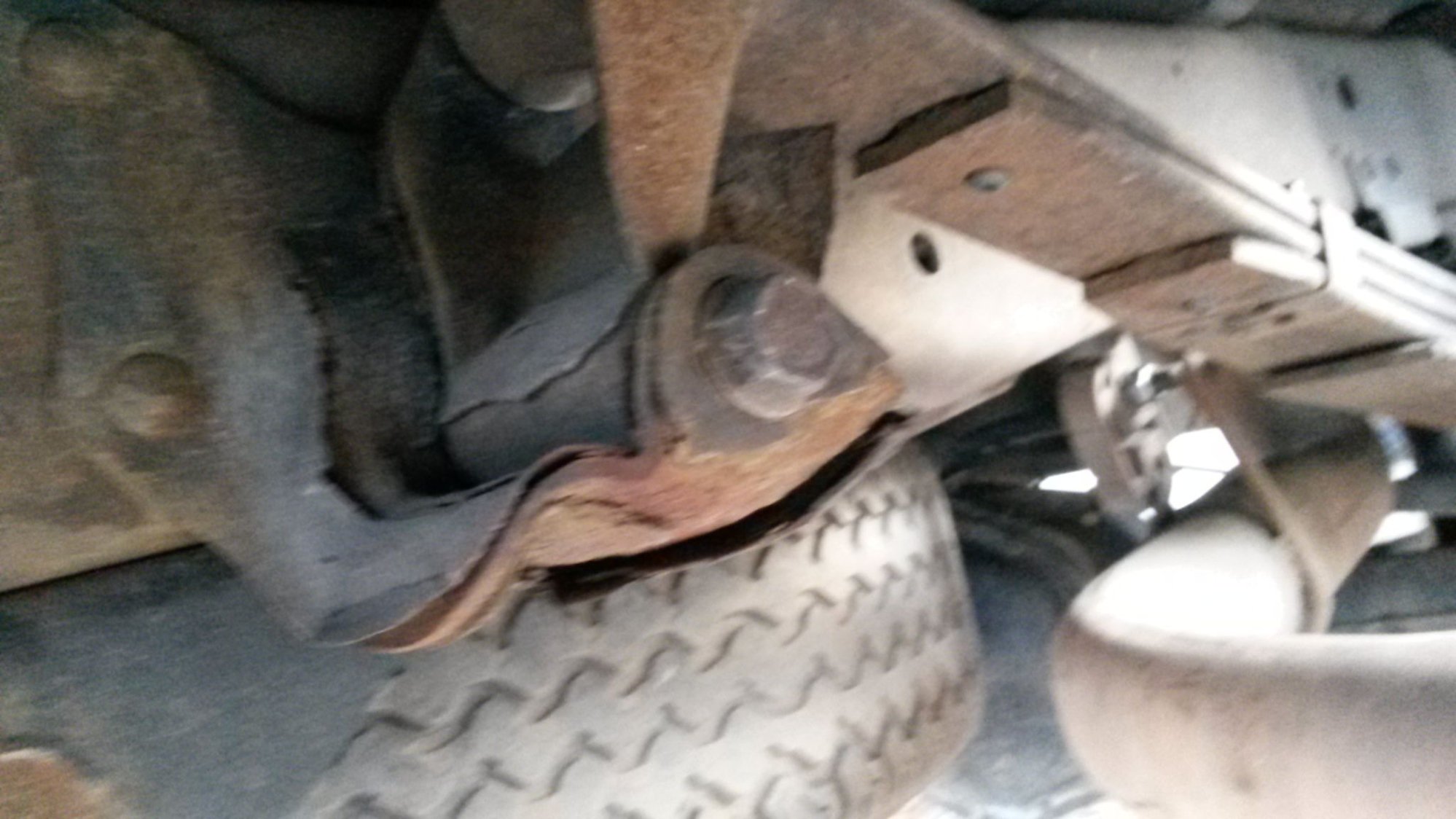

The front ones aren't terrible yet...they're just starting. The rears are BAD, layers of metal peeling off. I'm nervous every time I hit a big bump, and there's no way I'm going to tow my camper until they're all replaced.

Get in there and knock the flaky paint off. Clean any dirt that is holding in the pocket on the top of the hanger. Then get a good look and you'll likely see they are in fine shape. The horrible coating Ford put on is the whole problem with rot on these trucks.
I've seen them with holes rotted through the hanger and still holding. Not that it is safe, but still holding the truck up.

Here's a rusted rear hanger...
