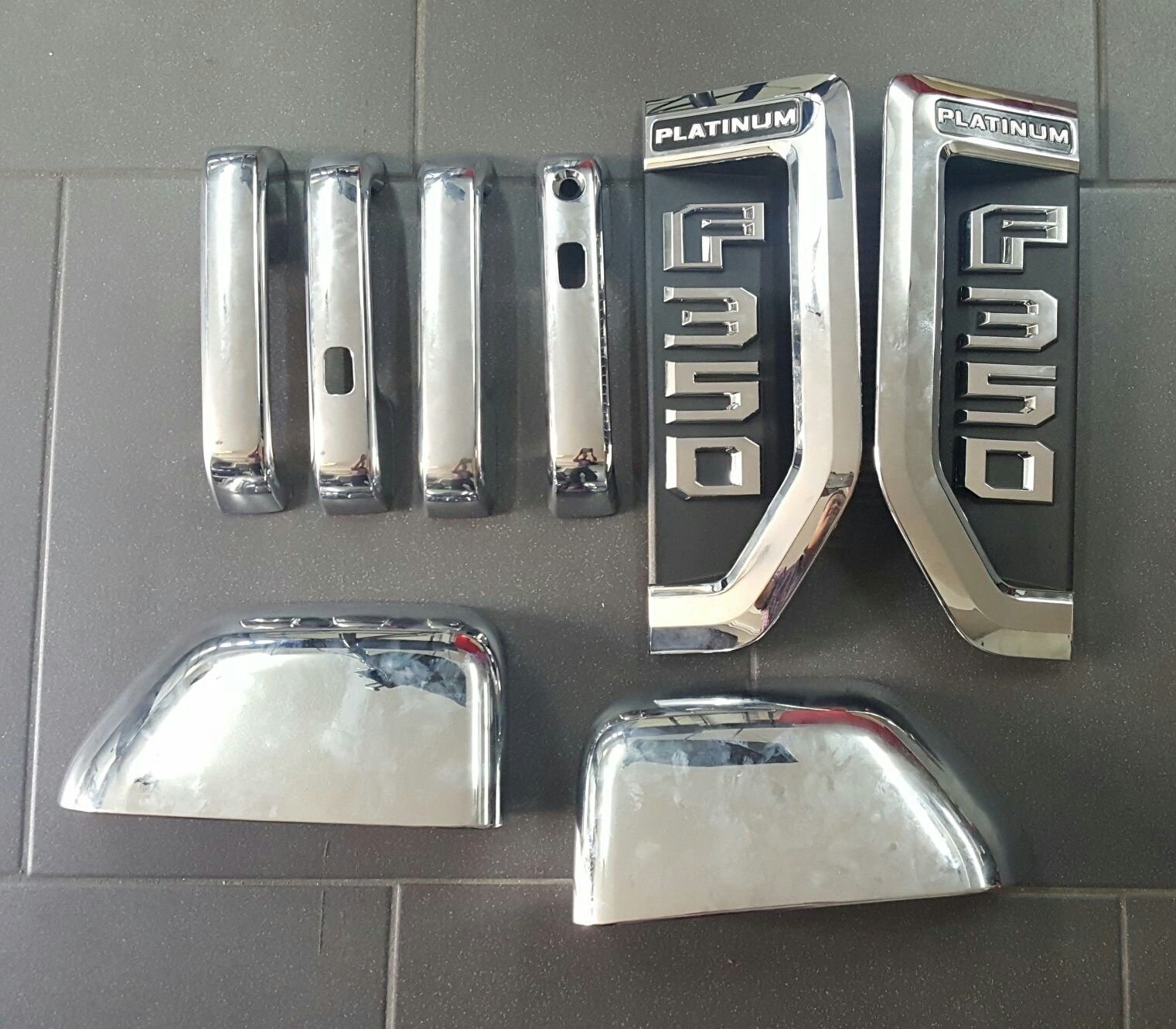

For the Powerstrokes and 6.7 badge, I just used strong fish line to cut it through. This method will separate the emblem from the double sided tape which will still be on. I just used my fingers to rub the tape off and any residue left I used Meguiars rubbing compound to buff off by hand. Just make sure to use a side to side and up and down motion, dont pull towards you as it may break the emblems.
Inknow this this is an old thread but could you share you removed the chrome door handle pieces???
The side fender badges are held together by 4 clips if I remember, you pull slowly. On mine the metal clips separated from the plastic ears of the badge, when you noticed that pull carefully so you dont break the plastic ears.
The FX4 or 4x4 just use heat gun or hair dryer and start peeling.
I personally like the de baged and color matched look
This is an old thread I know.... but wondering if you could explain how to pull off the chrome on the door handles?? Are they clips like the mirrors?? Thanks.

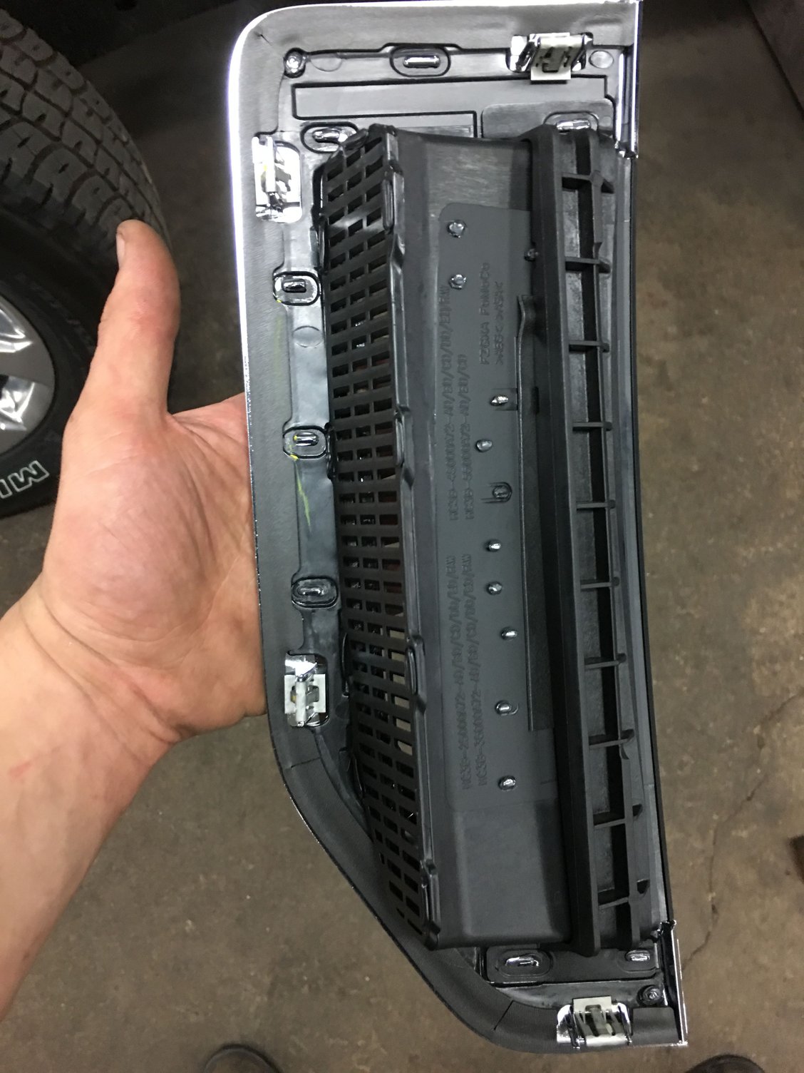

Can the F250 letter/numbers be removed from the Fender Badge ?
looks like they are pinned and melted into place -
Thanks for that. I'd like to remove the letters and leave it plain.
