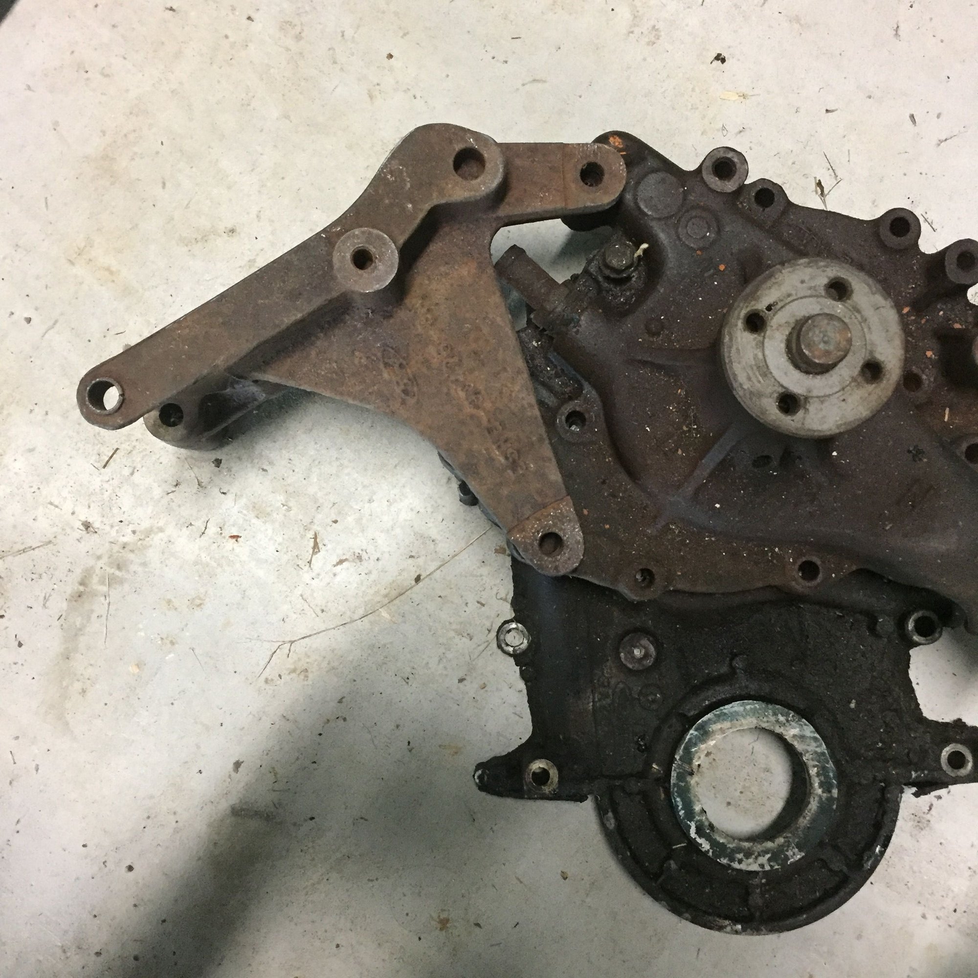

I've got the adjuster arm, I just really need the bracket that comes off the water pump and triangulates the bolt that's going into the block. The air pump bracket I know works, but just like the powersteering pump bracket, I didn't want to hack mine in case someone else needed it.

I read the thread on the deleting all the emissions stuff, not sure why dude zipped it off where he did, I was going to keep it where it triangulated at the water pump and mounted alternator and cut off the brackets ABOVE it. Like I said, I have no problem cutting mine, but I'd be more willing to trade for someone who needed it. These things aren't getting any easier to find.

TBH if you can cut that cast iron bracket you can cut a Y shaped piece of 1/4" stock that stabilizes the pivot bolt to the water pump.
Have a look at the JBG or L&L web pages to get an idea, but remember their bracket pivots in the middle of the head.
You need a solid vice and a BFH to get the offset.
The spacer can be a pipe nipple or something like that.

I thought about making one with bar stock, and I'm certainly not spending that kind of $$$ for the other brackets, I'll mount my existing one to make sure I can cut what I think I can, remove and hack it up. For the money these replacements and oem ones go for, I don't feel bad cutting mine up.
Old Apr 4, 2017 | 12:27 PM
crucialprospect's Avatar
crucialprospect
Joined: Aug 2009
Posts: 928
This is how I hacked it, a little more cleanup work and should be good. Am I correct on placement of bracket on water pump? It just seems like those 2 bolt holes lined up. I also know my adjuster bar uses the same mounting hole on the bottom?
