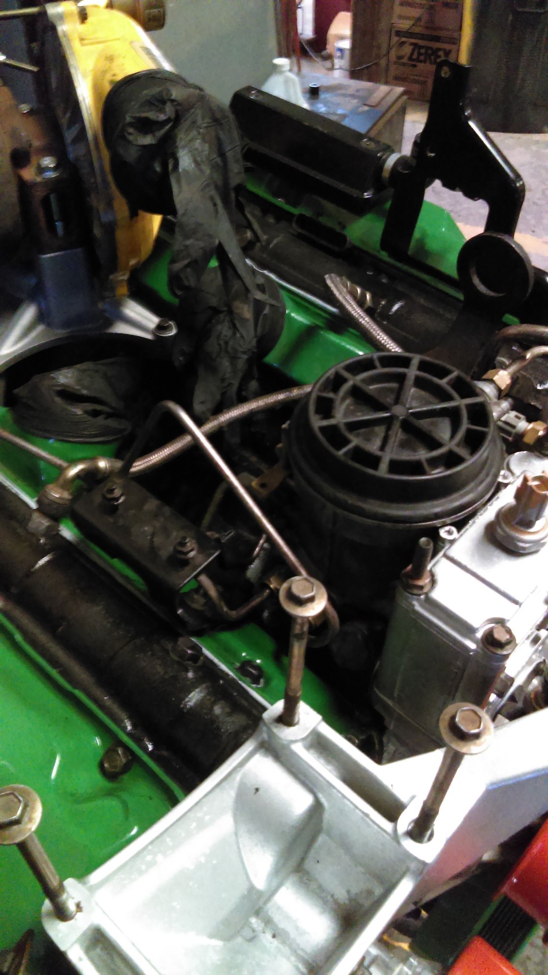

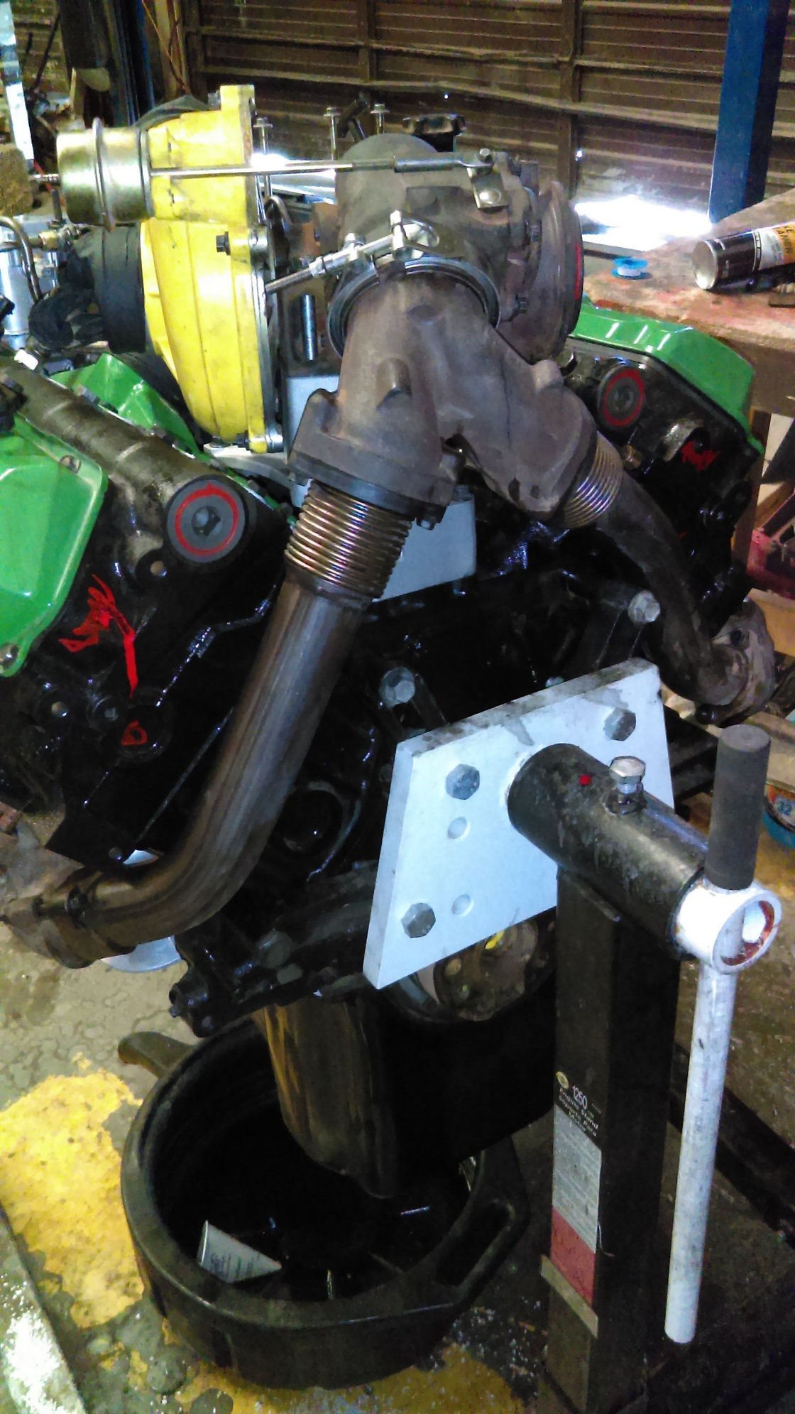

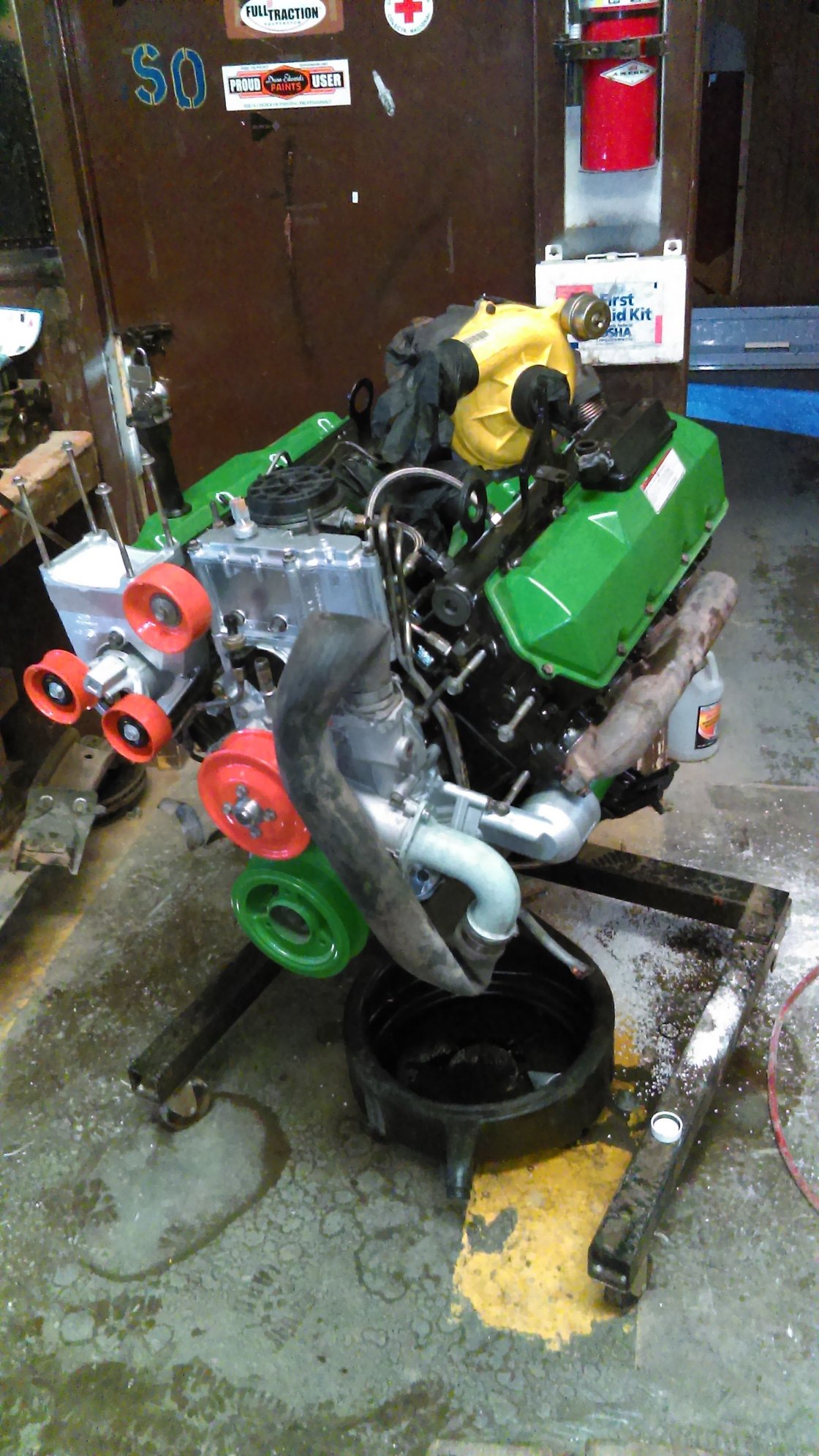

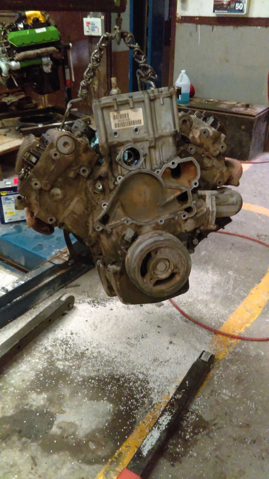

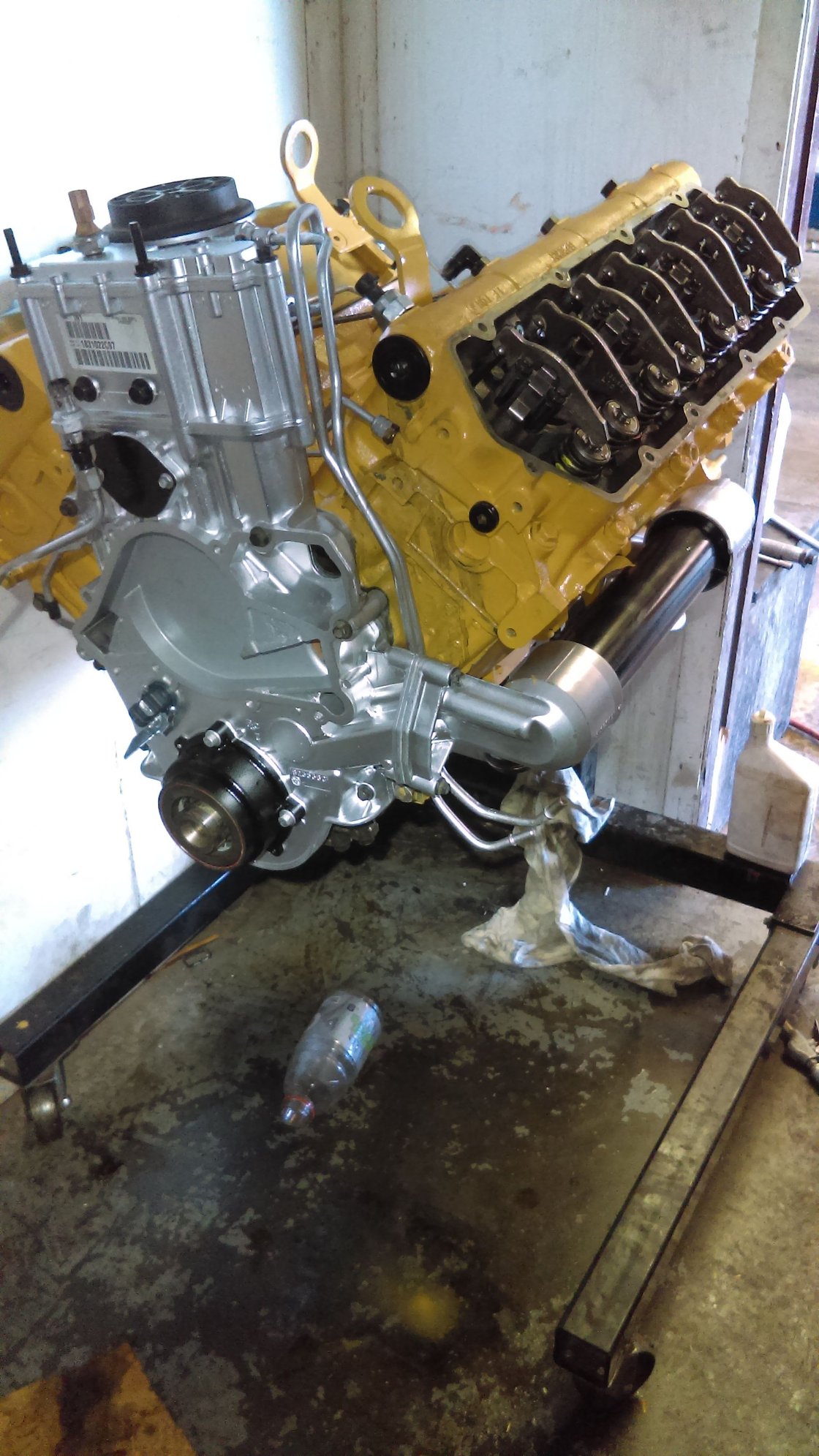

More pics had a bit of time to work on it, injectors, and glow plugs are in no pics of that though.
The old engine
The new semi complete

I paint with what I had ran out of JD green but had Chevy orange lol..., oh the yellow was from before when I rebuild the turbo, no paint this time as is I barely had time to work on this thing today and not very long either.

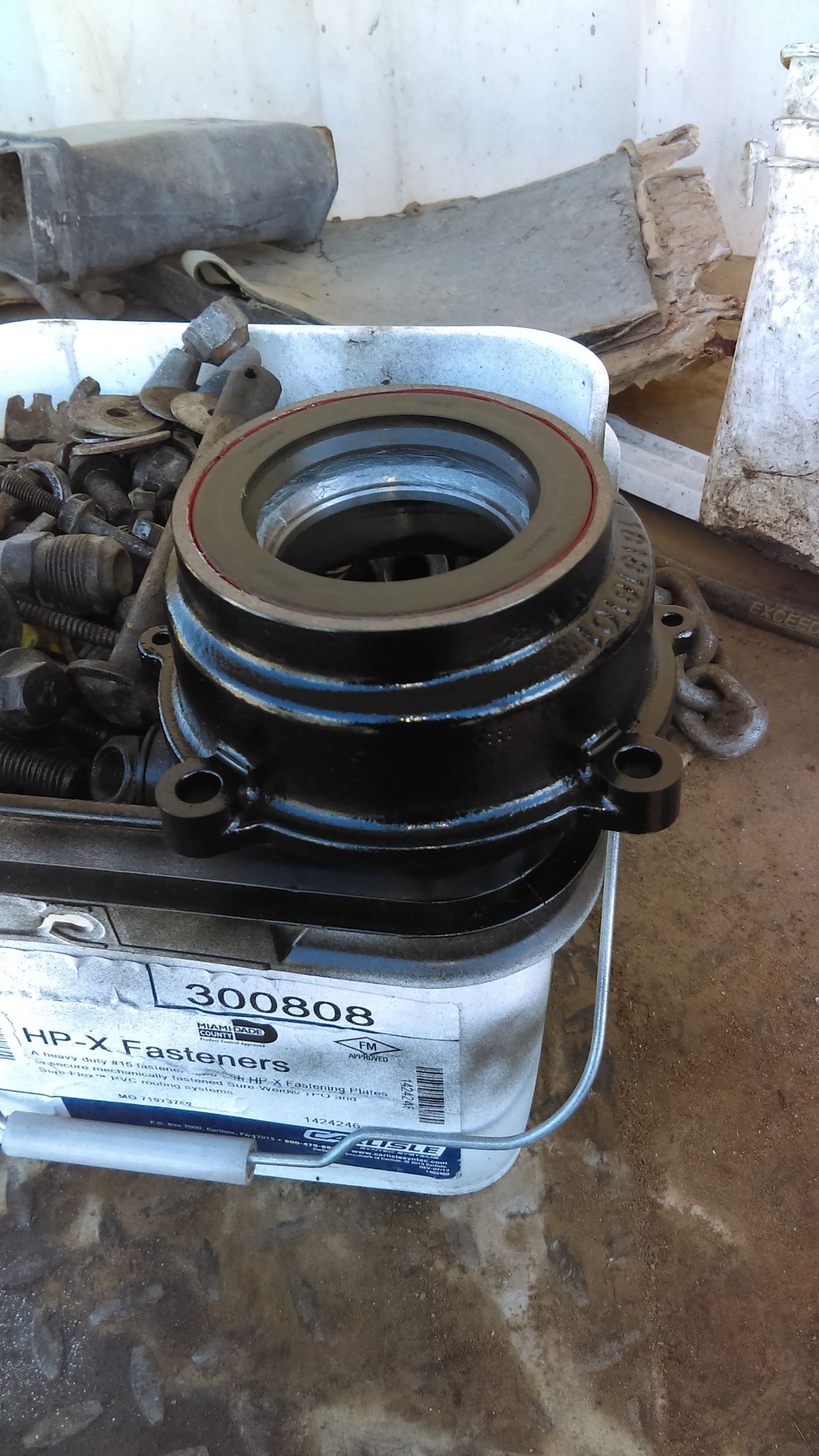

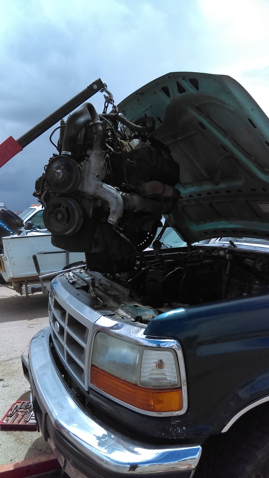

OK time to bring this one back from the dead. After more than a year I finally started to put together the engine that's going into my OBS.
Well enough Chit-chat here's some pics.
Rods with new machined bushings
Reworked heads, there was a leak in my storage room and got to the freshly resurfaced head rusted, after much debate I decided to use different heads.
Dont worry about the damaged surface, it wont affect performace or CR at all, according to my machinest.

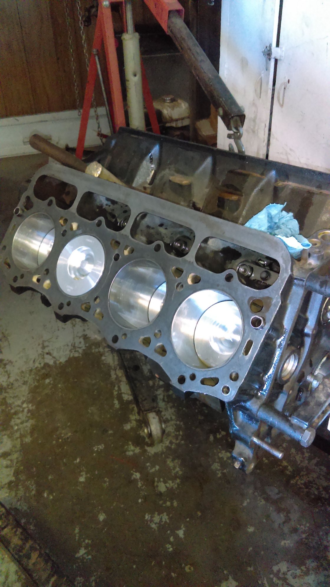

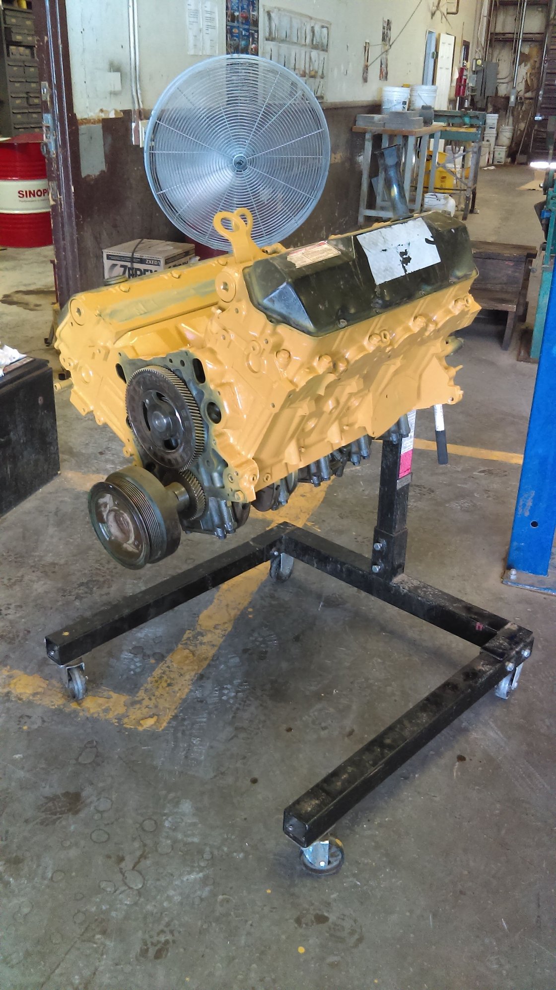

Bare block, with machined internals etc, gettong it ready for prep.
Polished crank ready to be installed.

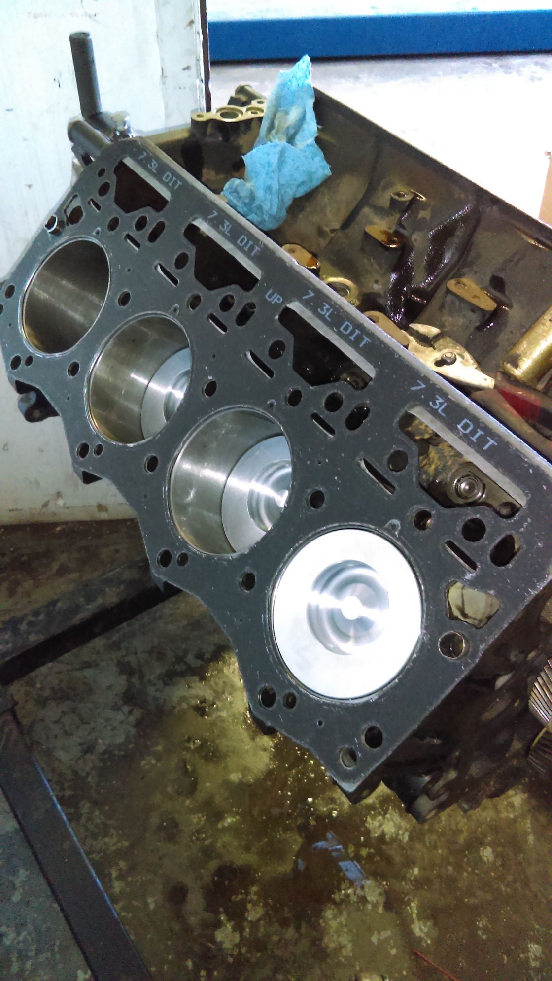

Assembled block with .030 pistons.
Head gasket installed and ready to dlap the heads on.
Heads on and painted with Kitty yellow lol..
Painted timing cover, and yes im doung the Spuper duty conversion on my OBS, an E-fuel is kit is $$$
Painted fuel lines as well.
Painted the new oip cooler.
New oil pump housing painted as well.
Oil cooler end caps painted as well.
New injector cups with 620 Loctite for ELC compatability to use on my OBS.
All seals repaced in the long block. Painted black to pop out.
Getting ready to install intake plenums.
And out with the old.
Will upload more pics, I already have the oil pan, valve covers and miscellaneous parts installed in the engine.
My old engine and on the background the **** kicker.

I wish I had the time, money, knowledge and space to do something like you are. I think I would really enjoy seeing the fruits of my labor and might just run the truck without a hood...
I have a question though in regards to the yellow paint on the engine. Where the pedestal goes for the turbo, there looks to be a lot of yellow paint in the mounting and oil holes, is the paint being in there not a problem?
Old Jul 15, 2017 | 08:57 PM
z31freakify's Avatar
z31freakify
Joined: Dec 2012
Posts: 11,270
Likes: 1,654
From: Las Cruces New Mexico
It's cleaned out, forgot to tape that area and also when the timing cover was at, brake cleaner removes paint very well lol....
