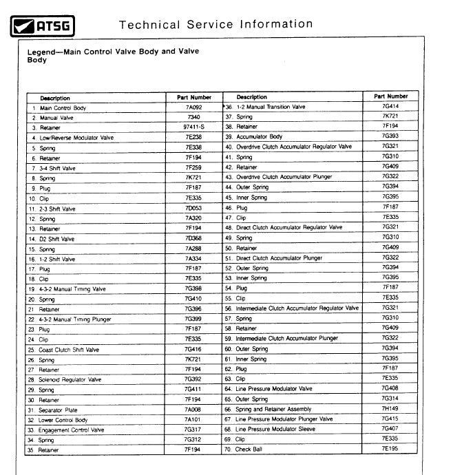

I completely disassembled my E4OD main control body to clean it, and I did not take pictures because I expected my ATSG rebuild manual would have instructions for re-assembling it. (I should know better, but it appears I don't. ) I've figured out where all the valves go, but the springs are a different story. . Does anyone have a diagram or pictures of where the springs go? I have a few of them figured out but the rest have me stumped.

Old Mar 19, 2017 | 01:47 PM
8285's Avatar
8285
Joined: Feb 2017
Posts: 76
Thanks for posting that , but I already have it in my ATSG manual. I have 7 springs and I have 7 places that need a spring, but I don't know which ones go where.
I tried looking up the springs by part number, but no luck. If only that parts diagram was in color!
Thanks again for trying to help!
