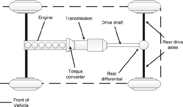

No. You don’t drain the transmission if the sensor comes out in one piece or has to be removed in several pieces. The transmission is already separated from the rear axle. A drive shaft connects the two components to transfer power from the transmission to the axle.
In post #2 the carrier and ring gear in the differential was removed to access the sensor.
