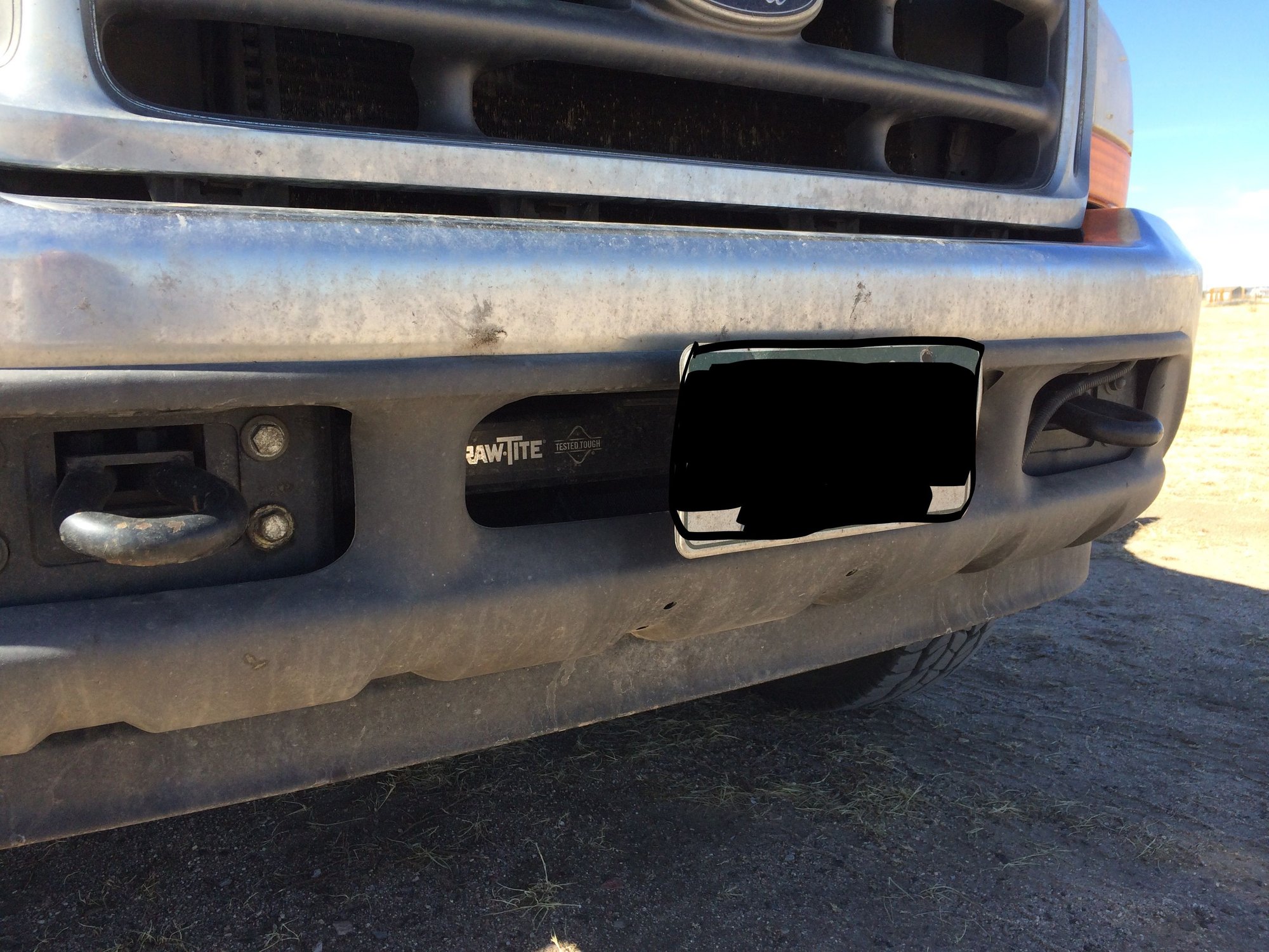

I put it on with the same issues that you discuss Rich. I have a pad behind a pole barn for some hay equipment and my BP trailer. Much easier to drive in straight forward that back around some corners.
Here are pics of mine. I have not noticed any increased trans temps after installing it, even when pulling my 4 horse gooseneck.

That configuration does create some air blockage for the coolers, but I'm not sure how much of an impact it would really make. On the plus side, though, it also places the receiver at a higher elevation which may be better suited for Rich's situation.

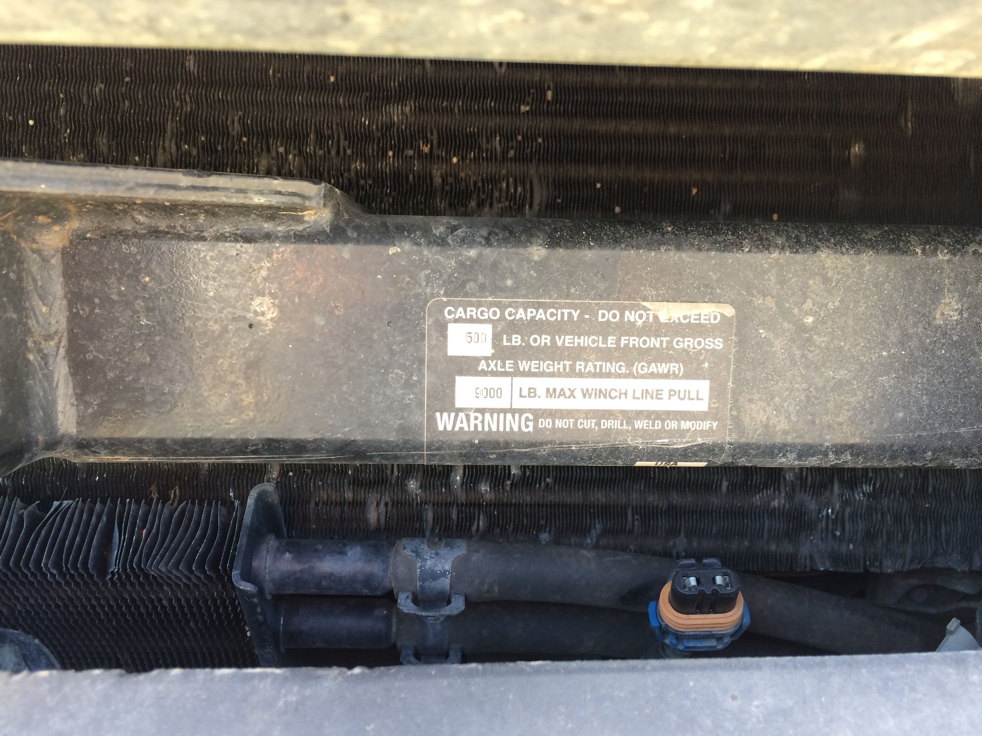

The Curts I looked at have a 5000 pound capacity. The boat alone weighs more than that, without so much as a trailer, the fuel, or some swimming noodles on board. The Drawtite in ZachinCO's picture looks like the call - unless somebody knows something not yet revealed here.

That 9000 lb rating on the Drawtite is for WINCH PULL... NOT tongue weight. Under WINCH PULL conditions you have the tensile strength of the bolts and the larger bolt mounting heads working to your benefit.
I would verify the tongue weight loading stats before finalizing a purchase. For vertical (shear) loading, I'm not sure what the 8 bolts are capable of sustaining in shear force, nor the capability of the flat mounting plates to avoid twisting. Also, on the Drawtite, I would have someone weld in some reinforcements on the bent over top and bottom caps on each side, thoroughly attaching those bendovers to the front-to-back interior side plates to convert the folded boxes into fully welded boxes on each end.

It says 500 pound tongue weight - I should be good there. Boats have a lighter tongue weight than bumper-pull campers - remember the beam, fuel, water and holding tanks, and engine room are behind the trailer axles. I have actually experienced tongue hop when climbing on the back of some trailered boats while loading gear.
Besides, I wouldn't even try this if the tongue weight was that much of a concern at parking speeds - the front spring capacity would come into question.
