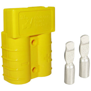

Those two yellow wires are what powers the glow plug system. I put them in a separate heavy duty connector. Then check the connections on rest of those connectors that multi-plug. Sounds like you may not be getting power to the fuel solenoid in the iP.
http://www.batterymart.com/merchant2...b50-yellow.jpg

My yellow wires went bad a long time ago too. Seems to be typical on these old beasts. I bypassed the engine connector with two yellow wires and butt splices. Use some decent stuff, it draws a lot of current.
